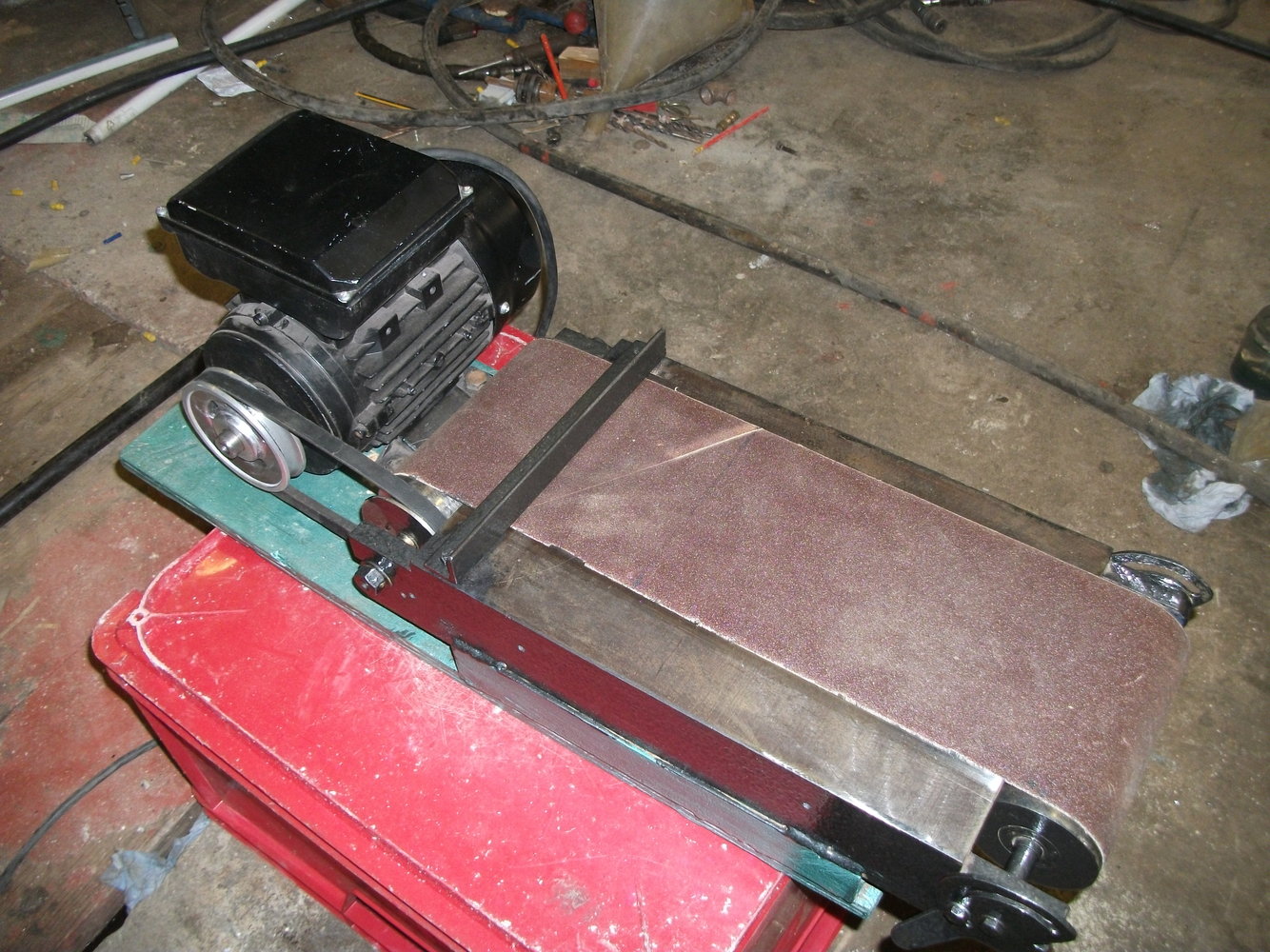

2hp motor, 36 grit beltthat's quick!
I tried with a normal hand held belt sander in a vice. It was just a normal belt I had at hand...I suppose for wood really..So for grinding metal what would I need?
