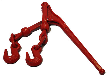

But what I would really like is some sort of quick-action tensioner.
Something like an over-center toggle clamp with a hook on each end?
Struggling to find anything off-the-shelf though?

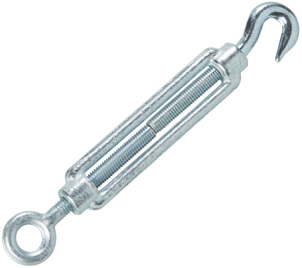

I don't really want to be fiddling about with winding threaded tensioners and I'd ideally like it to be able to be mounted in the middle of the chain rather than onto the van.
