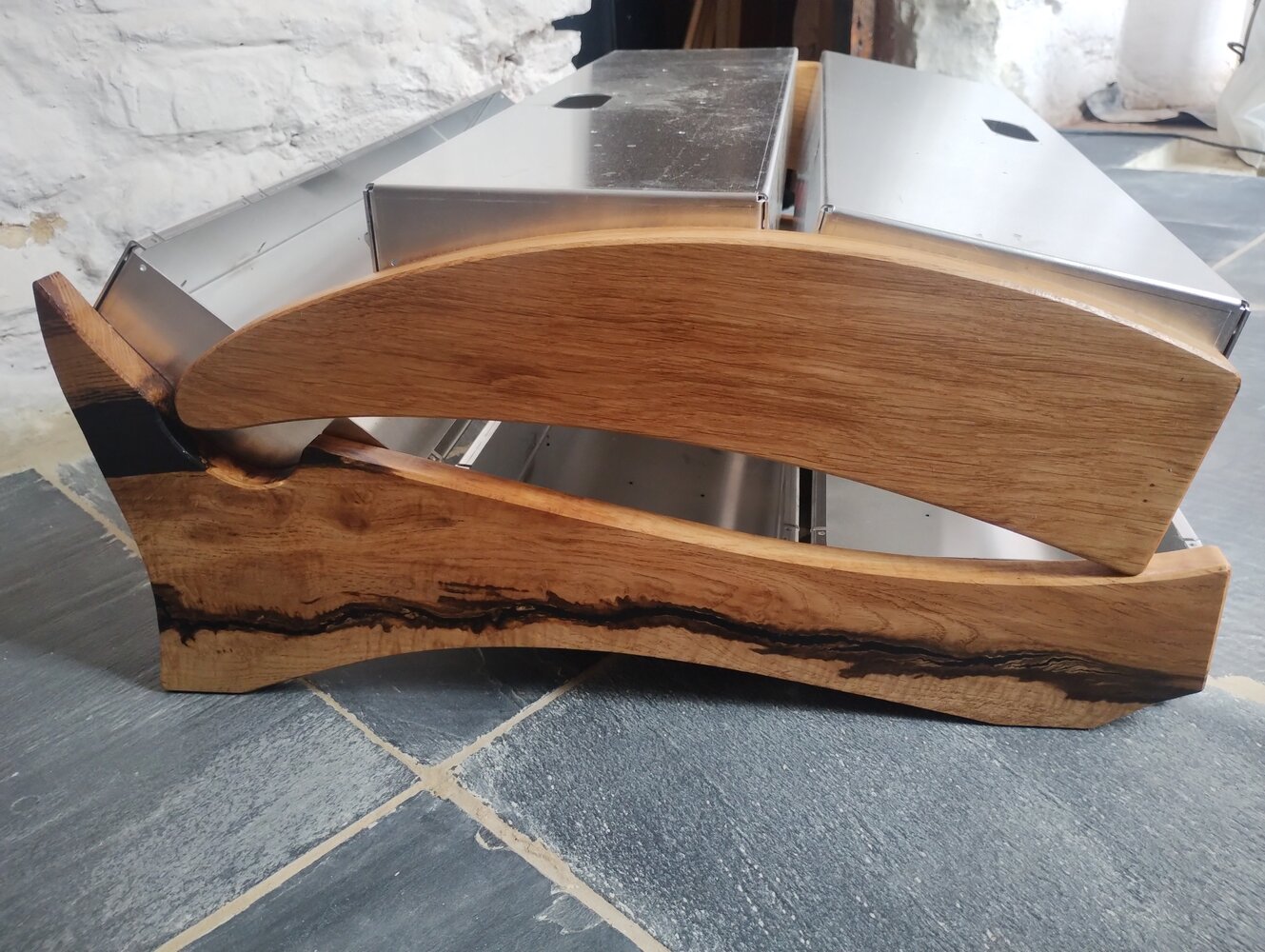

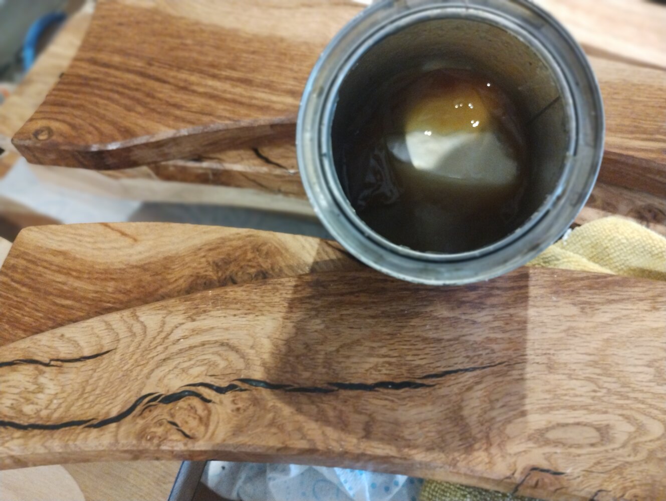

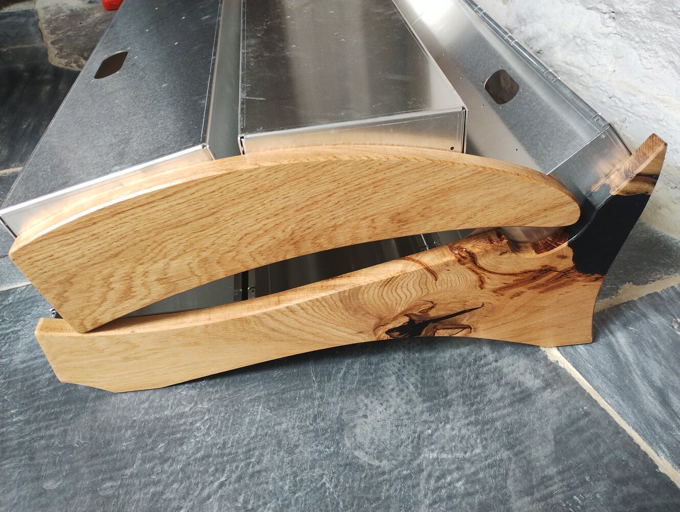

I recently used blackfriars Danish oil and they now use acetic acid as the drier. So the item was stinking of vinegar for ages afterwards. Not so good when it was stands for a wedding cake.
So be careful what you buy or your cabin will stink afterwards!

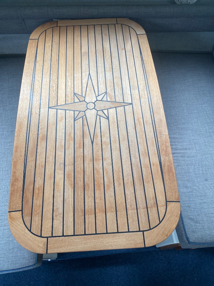

If the table is going to be used for food prep I would suggest a worktop oil for kitchen worktops. It is food safe and virtually odourless.
