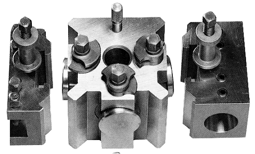

not conversant with tha lathe but on my Myford and Student I have a Dickenson type quick change tool holders....they are not cheap anymore......View attachment 277302
Im assuming thats the type he has with 32mm post as part of the compound.
Most qctp's have about 15mm bore.

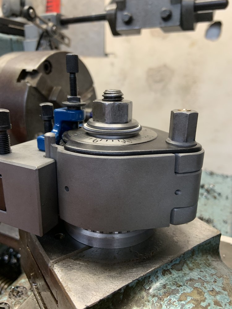

As above.View attachment 277329
Fitted mine with no modification to the top slide. Can use a 12mm or 1/2" tool unlike on the ml7 which is restricted to 10mm FWIW the tool holders from Chronos are a nicer fit than the ones from RGD. I probably have better photos somewhere but that it the first one I found.
Edit:
Slightly better.
Edit2: Originally mine had the Myford Drummond four way rotating tool holder which was directly replaced with the "Dickson Myford type " from RGD
