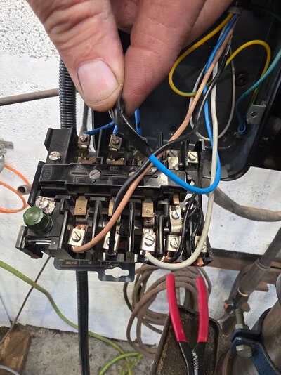

S snotters64 Member Messages 178 Location Highlands in Scotland Today at 9:15 AM #1 Having a wee problem wiring in this ex school drill , can anyone pint me in the right direction. Staring with where does the blue wire go Cheers 20260522_090932.jpg 170.4 KB · Views: 7 20260522_090858.jpg 179.9 KB · Views: 6

Seadog Save the planet. It's the only one with rum! Messages 13,407 Location NE London - UK Today at 9:51 AM #2 Where does it come from? The wiring's a mess, so imposdible to tell from the pictures. More info needed.

S snotters64 Member Messages 178 Location Highlands in Scotland Today at 10:26 AM #3 Is this any better 20260522_101857.jpg 276.8 KB · Views: 6
I indykid Member Messages 461 Location Dewsbury - WF12 Today at 12:53 PM #4 Does it have a 4 pin or 5 pin plug on it? If only a 4 pin plug with 5 core cable, the neutral is redundant so can be wrapped up out of the way (but check which cores are connected in the plug before assuming anything if it's been in a school)

K knighty Member Messages 3,937 Location Sunderland Today at 1:06 PM #5 yes, if that's coming from the plug it shouldn't be needed, the problem is something else brown black grey are your 3 phases coming in, earth goes off somewhere out of the photo 3 blue out the top go off to the motor what's the symptoms of it not working?
