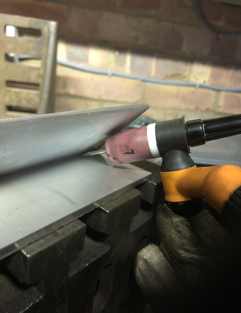

Little trick of the trade coming here …. Pull your tungsten further out especially on joints where it’s tight (like corners)I did a tiny tig weld and looking through the cup was the only way. The gas lense is the other part of the equation which I also didn't have before.

You don't even need a gas lense in that situation I've found over the years. But don't get the gas economy. Also providing you have side view a pyrex isn't a great boon.Little trick of the trade coming here …. Pull your tungsten further out especially on joints where it’s tight (like corners)
You’ll be very surprised at what you can actually get away with when using a gas lens.

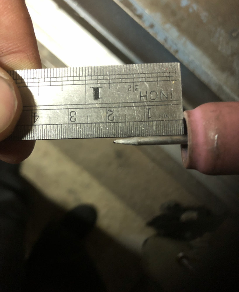

The worst joints for being able to actually see what’s going on are the best joints for allowing you to extend that tungsten right out so you can keep the cup from blocking your view.
Where’s the gas gonna go on a joint like that? Exactly where you want it
20mm is even achievable on the right joint with a well set flow rate and decent lens
View attachment 347203 View attachment 347204
What flow rate are you using in each case?I've noticed no difference in saving gas between standard and gas lens,
