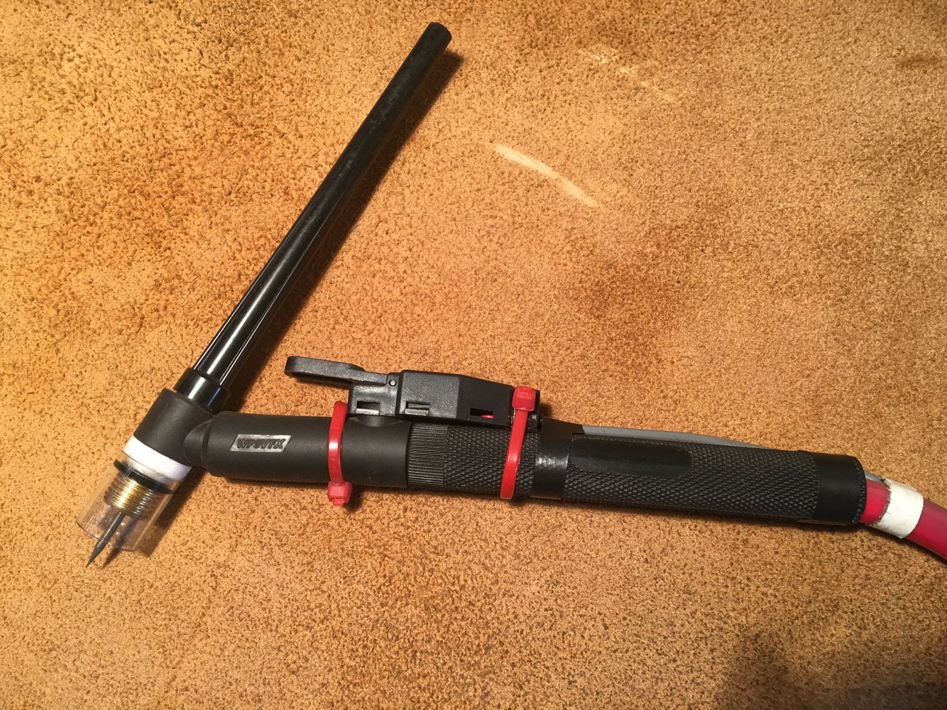

Have you got some more details of what and where from please?Iring on a WP9 torch. made some up from the pyrex tubes used in some of those cigarette substitute puffy smoky things, With the help of heat residing "O"

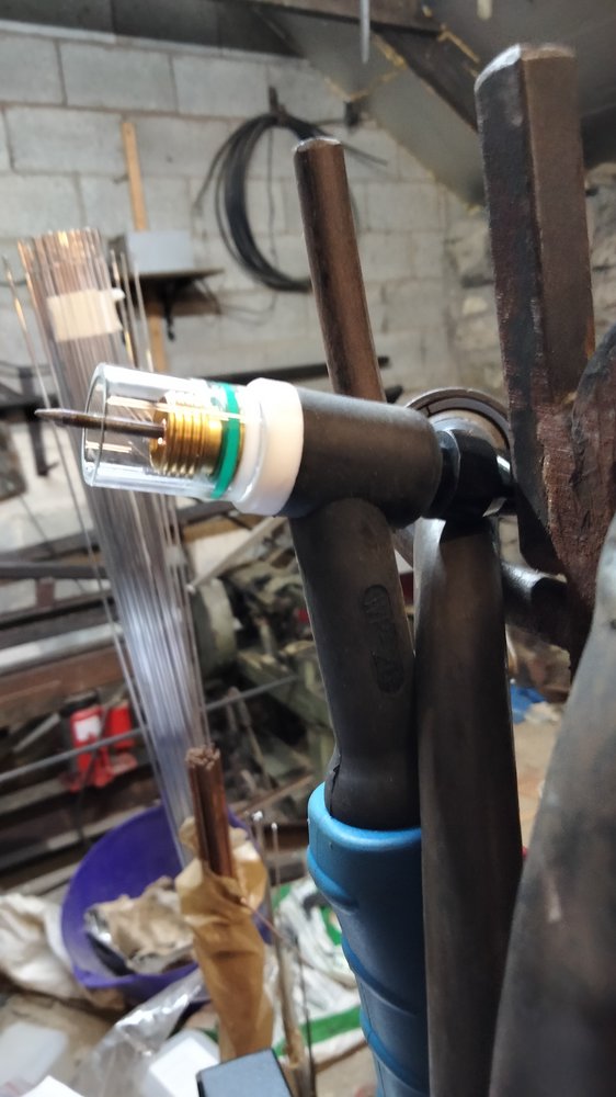

I'm curious that you're having issues getting them off. I've had them fall off with wrong size o ring. Using the wrong material o ring might cause the glass to fuse on. Can't use the standard ones. I look through the pyrex to weld.I have a set, Im not convinced the extra light/visibility is helpful, but I found they can be a pain to get off. I generally use alumina ones instead now.
6s on a wp17 torch, without lens. Although I have a wide range of them, which I never use. I find using the perspex I didn't touch anywhere near as much as with the ceramics. Again it's all down to the individual....but for me a game changer. The other plus IS the advanced AC TIG which is brilliant at low amps. None of my results could be classed as exemplary. But never welded for a living, more of an aside to it. Fusing thermocouples etc...What were you using before these, and what size cups?
I'm on a no7 standard wp20 gas lens for nearly everything, i tried those but I didn't like the O ring seal, and they don't like lots of AC heat. So decided to stay with alumina screw on cups.
I found that those bigger cups liked more gas, though. Just my experience.

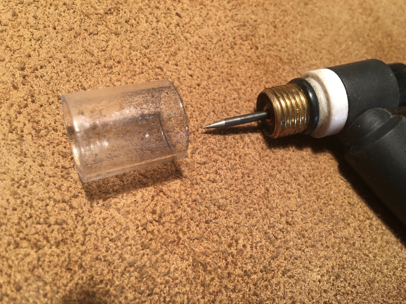

The pyrex ones are pretty robust. Don't break easily. Don't know anything about the e-ciggy ones.I tried using the glass parts from e cigarettes, trouble is you only need to look at them for them to shatter, the ceramic ones are bulletproof in comparison. if you're clumsy like me, you'll need to stock up on the glass bits

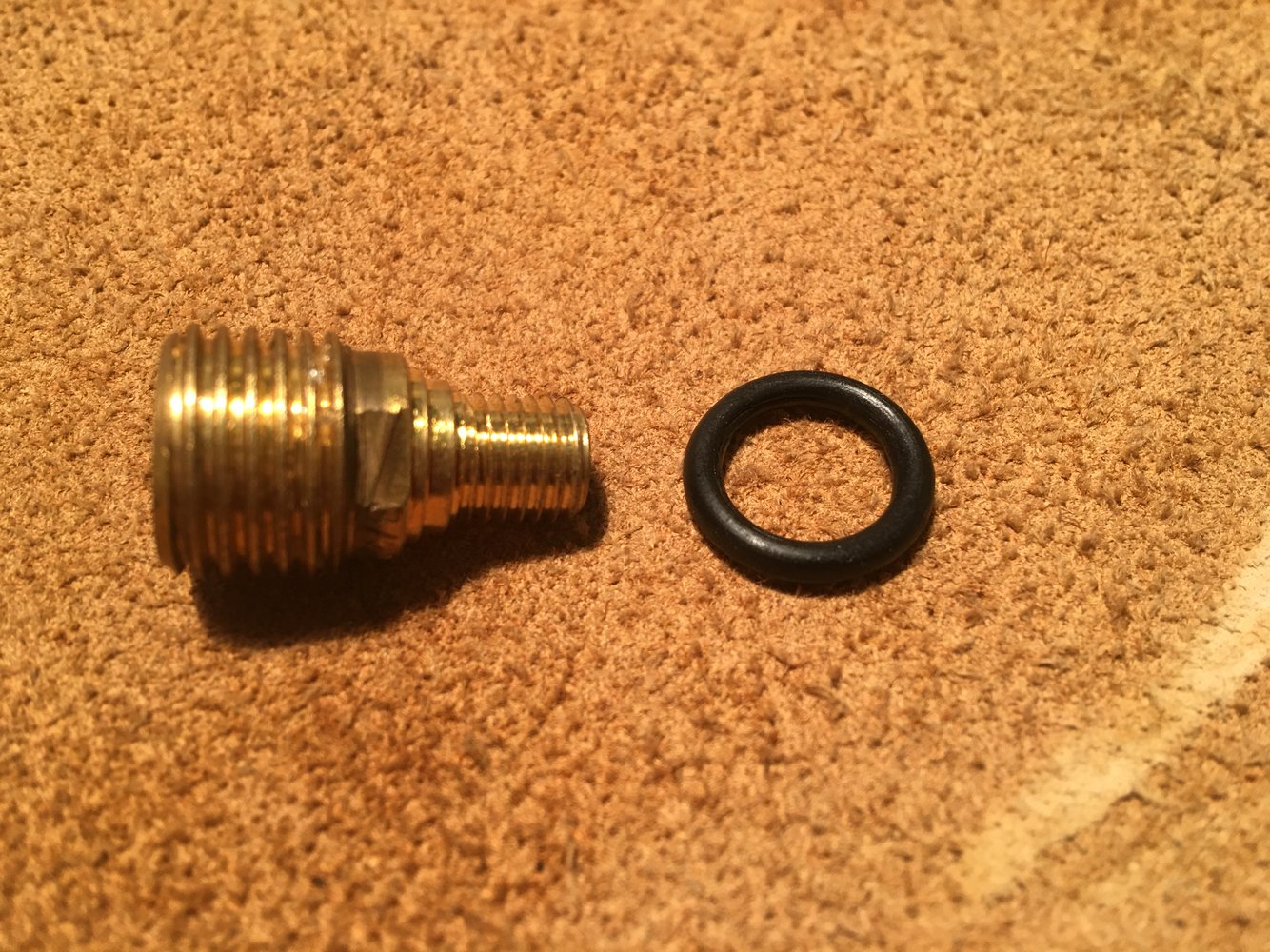

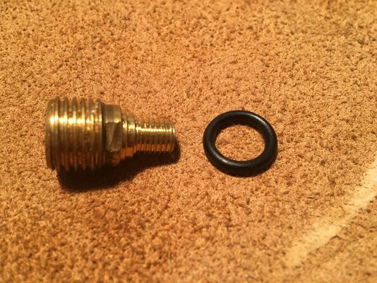

With two of the green orings, I imagine they swelled with heat. It would rotate but not pull off, didnt matter how much I wiggled it in every direction. Did eventually get it off perhaps 6 days after I first wanted to.I'm curious that you're having issues getting them off. I've had them fall off with wrong size o ring. Using the wrong material o ring might cause the glass to fuse on. Can't use the standard ones. I look through the pyrex to weld.
I ended up with a few for that by accident. Tried to mod them...failedI just measured up the WP9 torch, looked on Ebay for the pyrex tubes, quite af ew size available, and found 'O' rings to suit, I will see if I can find a photograph
