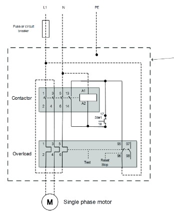

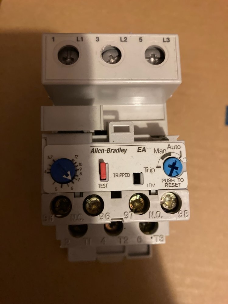

ok...question...A1 and A2 is live and neutral on 'modern' contactors, there's only the 3 phases (and earth) in the original contactor coming in, still 2 connections to the coilNo but the coil voltage is likely 400v
basic answer will prob help with what to research...
@daleyd that's just a pic of the original contactor that was used before someone fitted a single phase motor
