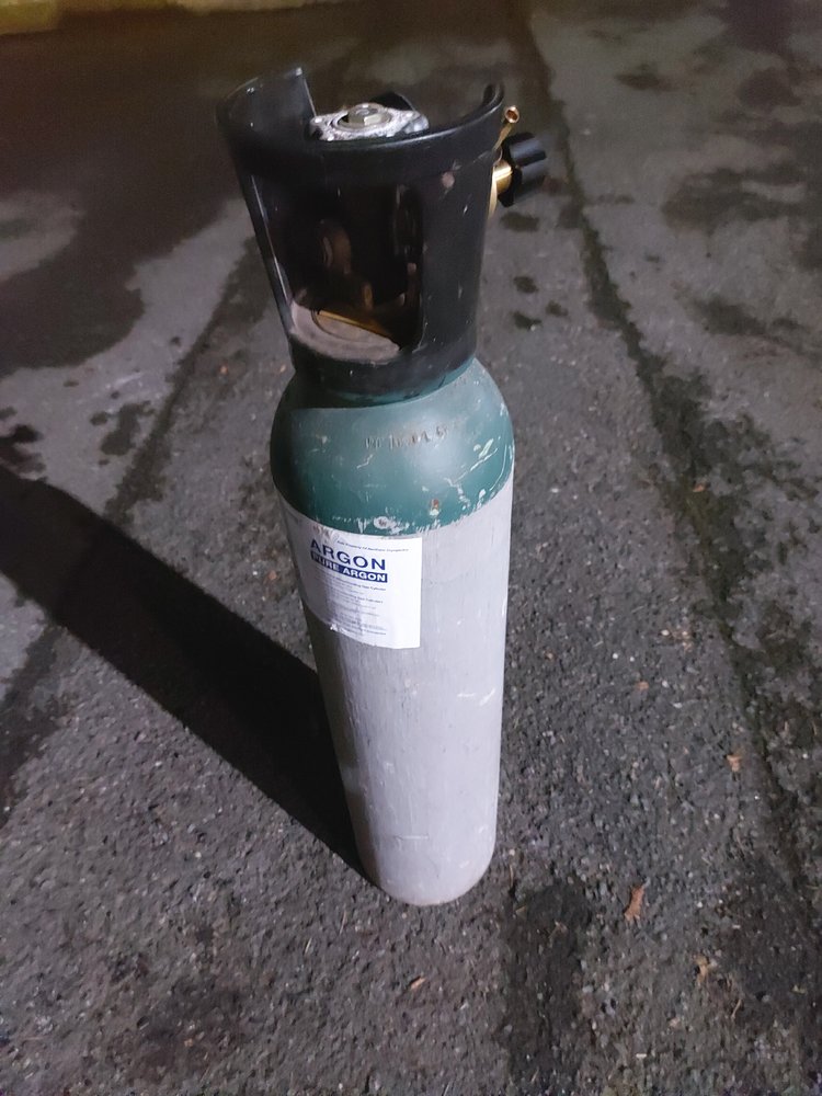

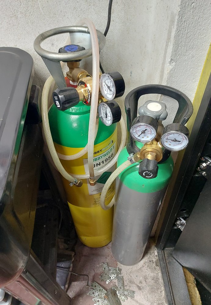

In my back garage (not very accessible) I already have a rent free Argon cylinder for my TIG.

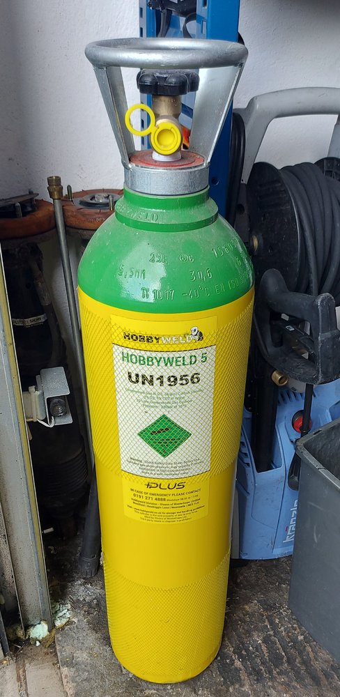

(I have a MIG and large Hobbyweld 5 bottle in front garage)
I have a second MIG welder coming now for my back garage and ideally I'd like to just use the pure Argon gas with it too instead of buying a 3rd rent free cylinder.

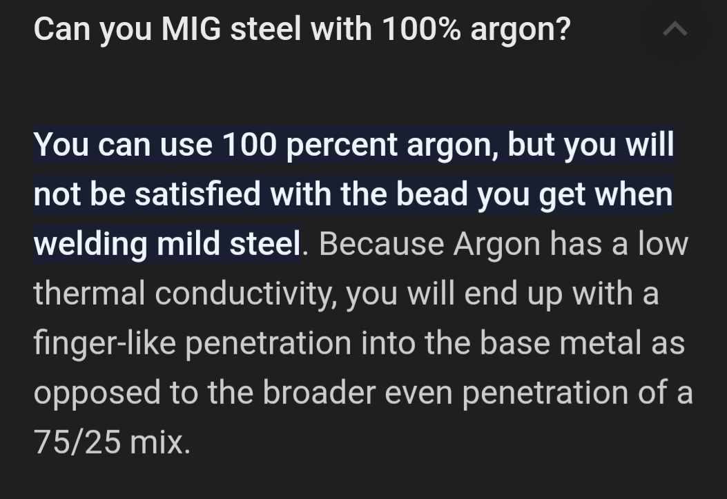

I mostly weld car bodywork or up to 4mm mild steel is 95% of what I do. I see all sorts of MIG gas available when I Google it not sure if pure Argon has any particular draw back on a MIG for mild steel.
