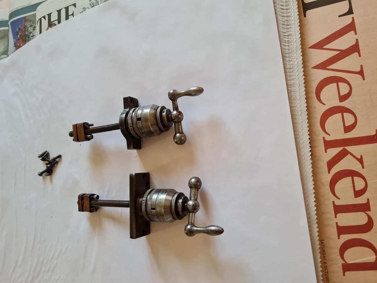

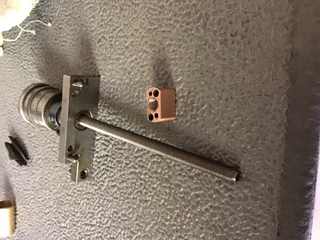

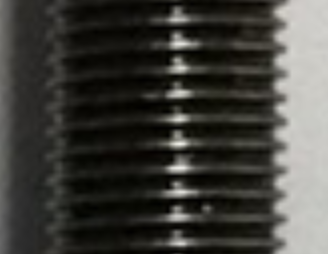

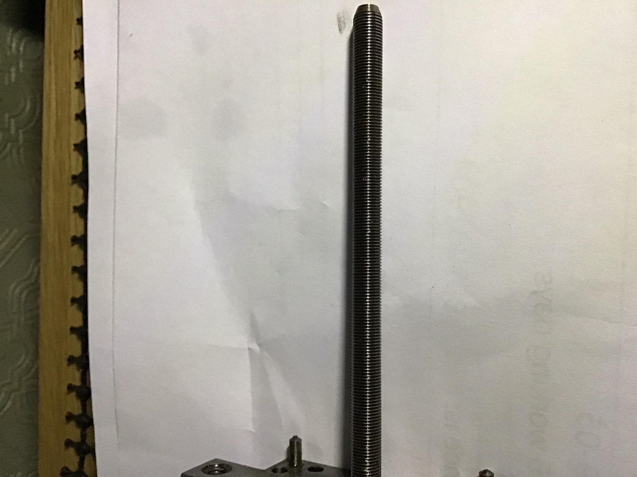

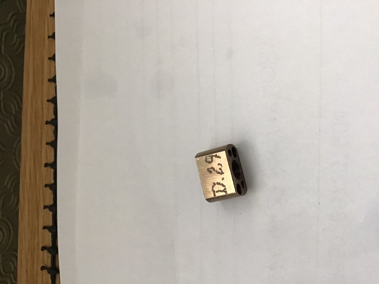

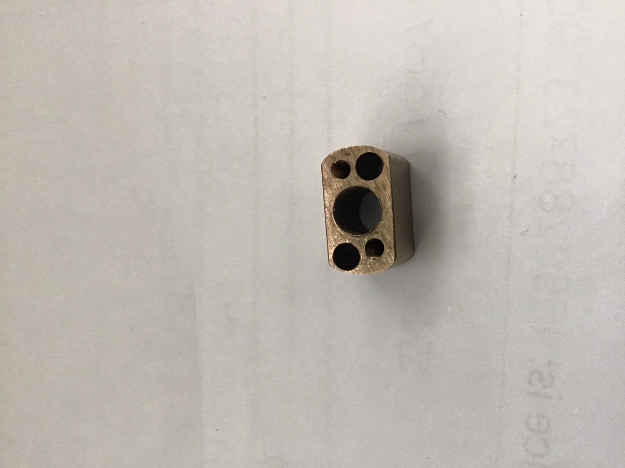

I have to find or get made a replacement lead screw nut for my Pultra 17/70 crosslide but I need to determine the thread , the screw measures 6.27mm 0.247” and 20 threads over 1/2” so 40 tpi but all I can find is 1/4” X 40 tpi M/E threads and I wouldn’t think Pultra would have used model engineering threads, the grub screw threads are 6 BA.
