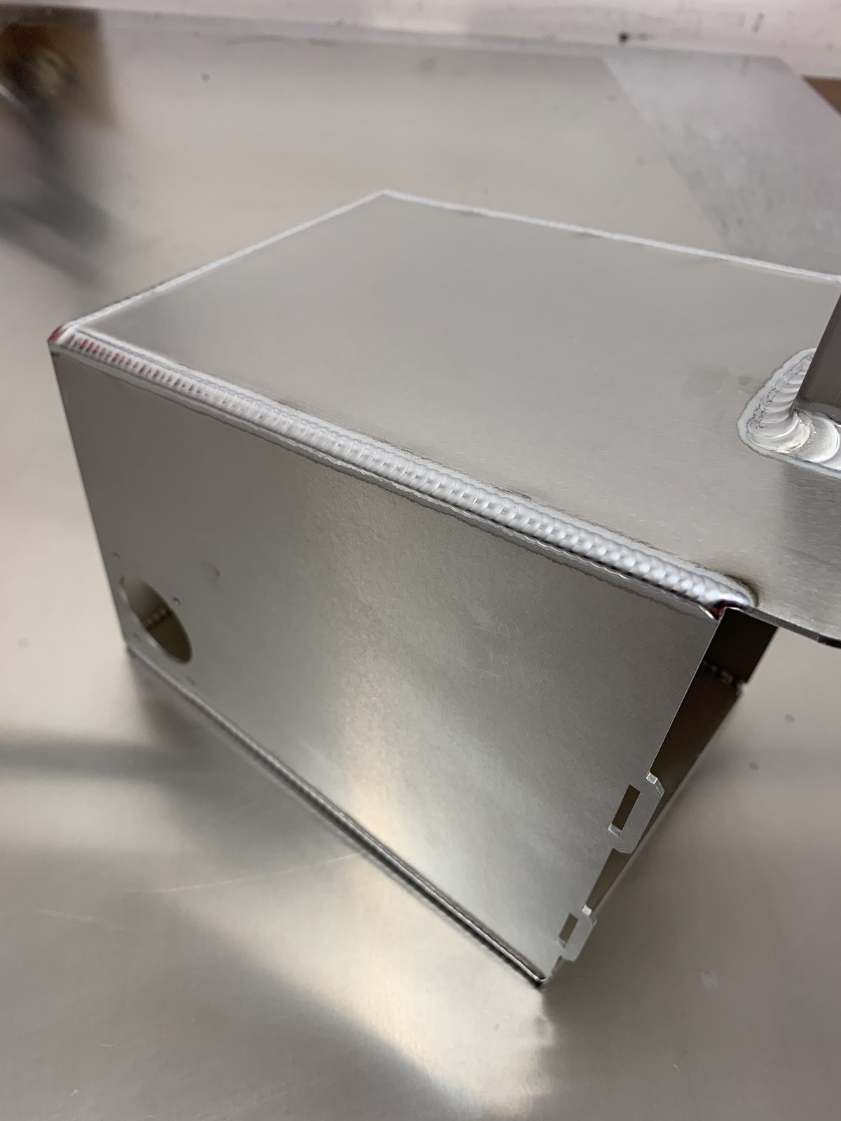

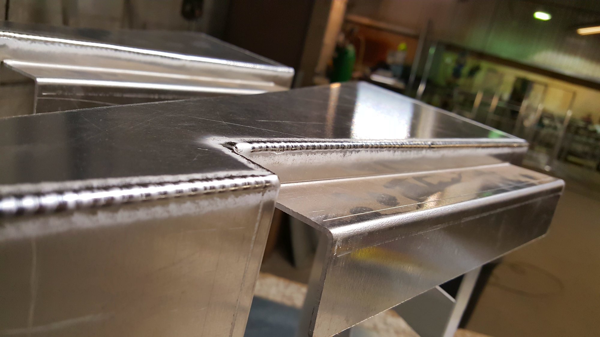

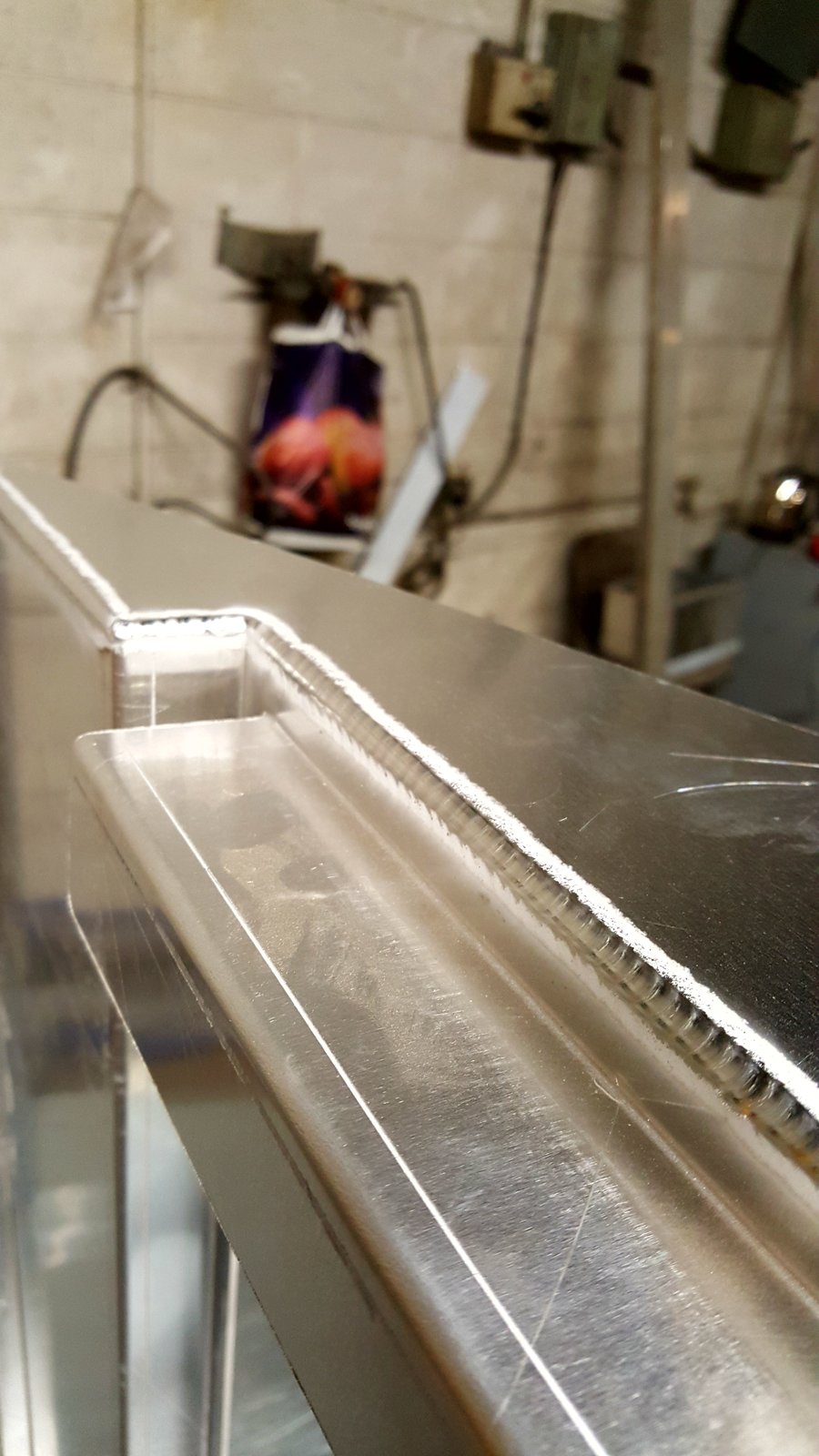

First and second just pulsed 3rd autogenous I look at stuff on YouTube sometime and wonder how to he'll do they get it so neat, both do the same thing one looks better but takes a little longer 2 mm plate,So what's going on there?
let me guess... pulse autogenous in the first photo, and regular dabbing straight AC in the 2nd and 3rd photos?
Very neat welding, either way!!

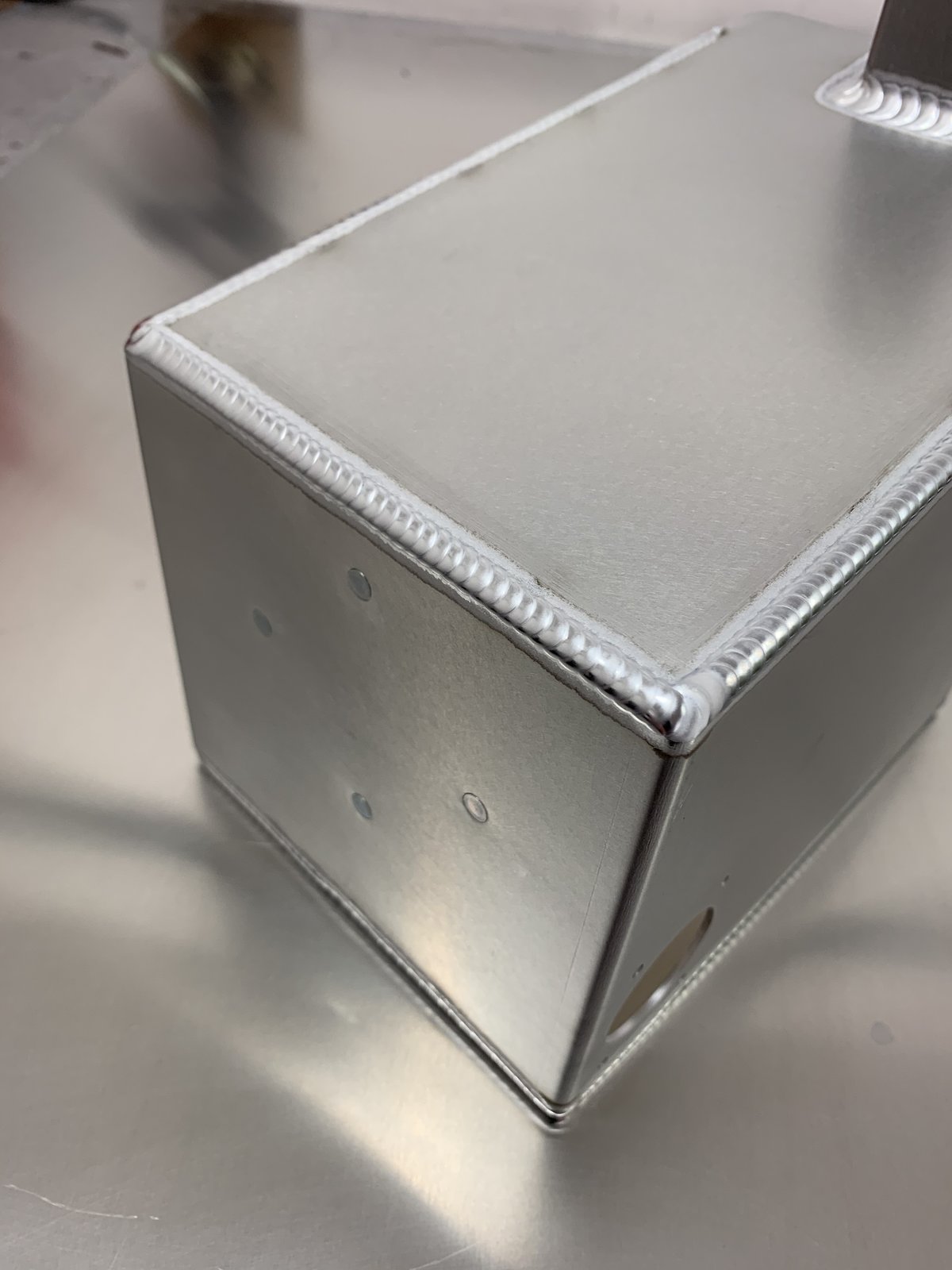

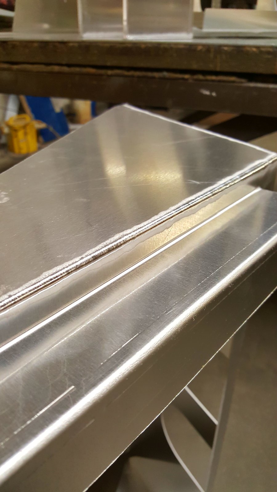

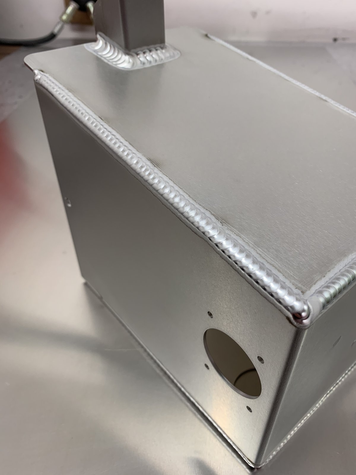

Traps for pigeons I try something a little different whenever I get to do them, it's the only plate I get to weld no rod, just fused using the pulse, and then last picture pulse turned ofVery tidy ,, what is it again just out of curiosity .
You can have pulse on AC or DC, if the machine supports itTwo things jump out at me, well 3. It's very neat. Didn't know you could have pulse dc? And isn't autogeneous with ali risky for cracking - dependant on the material spec I guess?
Lovely workView attachment 268470 View attachment 268471 View attachment 268472 Nice. I sometimes use pulse without any filler. Only when the joint is a closed outside corner though.
Must have a look in the Selco book then...You can have pulse on AC or DC, if the machine supports it
1xxx (pure) and a lot of Si alloy sheet isn't too sensitive to cracking, if its not a critical joint you can usually get away with autogenous.
It's very easy with AC pulse at say 2hz and the right settings to make a lovely looking job of outside corners, even if it's not too strong.
If you have say 1.5Hz pulse, do you time your movement to the pulse? Ie 2 pulses? Can you see the pulses through the glass? I guess you can?I’ve mucked about with pulse on outside corners but if you have it at 1.2-2hz it’s so bloody slow.
whack the pedal down and throw the filler in the joint always works better for me.
You’d have to move on every pulse to get even ripplesIf you have say 1.5Hz pulse, do you time your movement to the pulse? Ie 2 pulses? Can you see the pulses through the glass? I guess you can?
