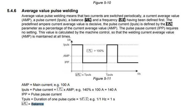

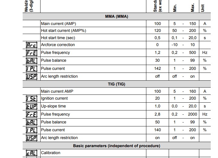

I will have to have a mess around with all the settings when I get a chance.
The manual doesn't really say what the balance is or at least not from what I have seen so far or maybe I am just not following.
It seems however that the display current you set is average current and you can set the pulse current as a percentage of that. The low pulse current is then set automatically depending on the balance and pulse current as the display current will always be the average. Or at least I think that is what it means

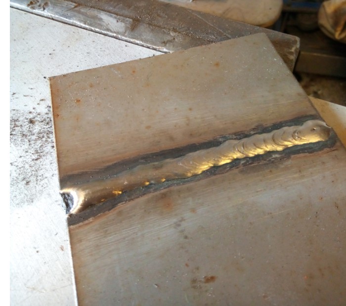

I tried a quick test on some 1.5mm stainless with 2.5 rods, just a butt weld and I didn't really have much time to mess around with things but this was the result, not great but not bad either on thin stainless.
