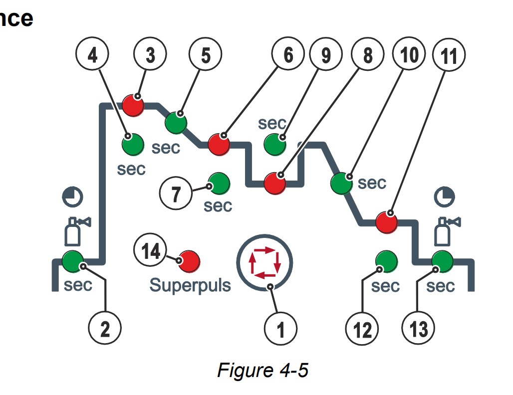

I eventually remembered to look at the settings I use with Super Pulse on the EWM Phoenix 355.
I have 3 different custom programmes set up, Job 130, 131 and 132. I use job 131 most of the time.
I don't have times set up for hot start and crater fill sections as I use the torch trigger to control the duration and they are only used when in 2T or 4T normal, I always use 4T Special.

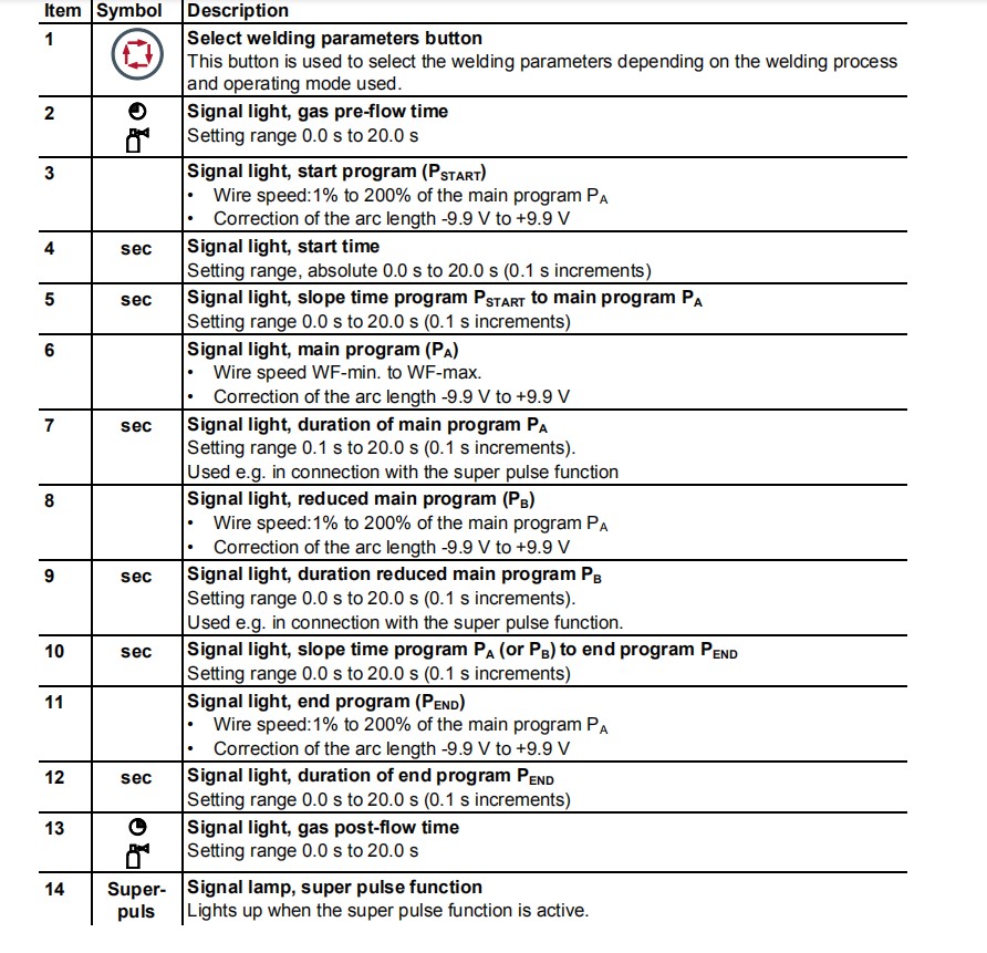

Here is a drawing and info of what each section of the settings represent.
Here is a video showing all 3 of the programmes and the settings I have in them.
