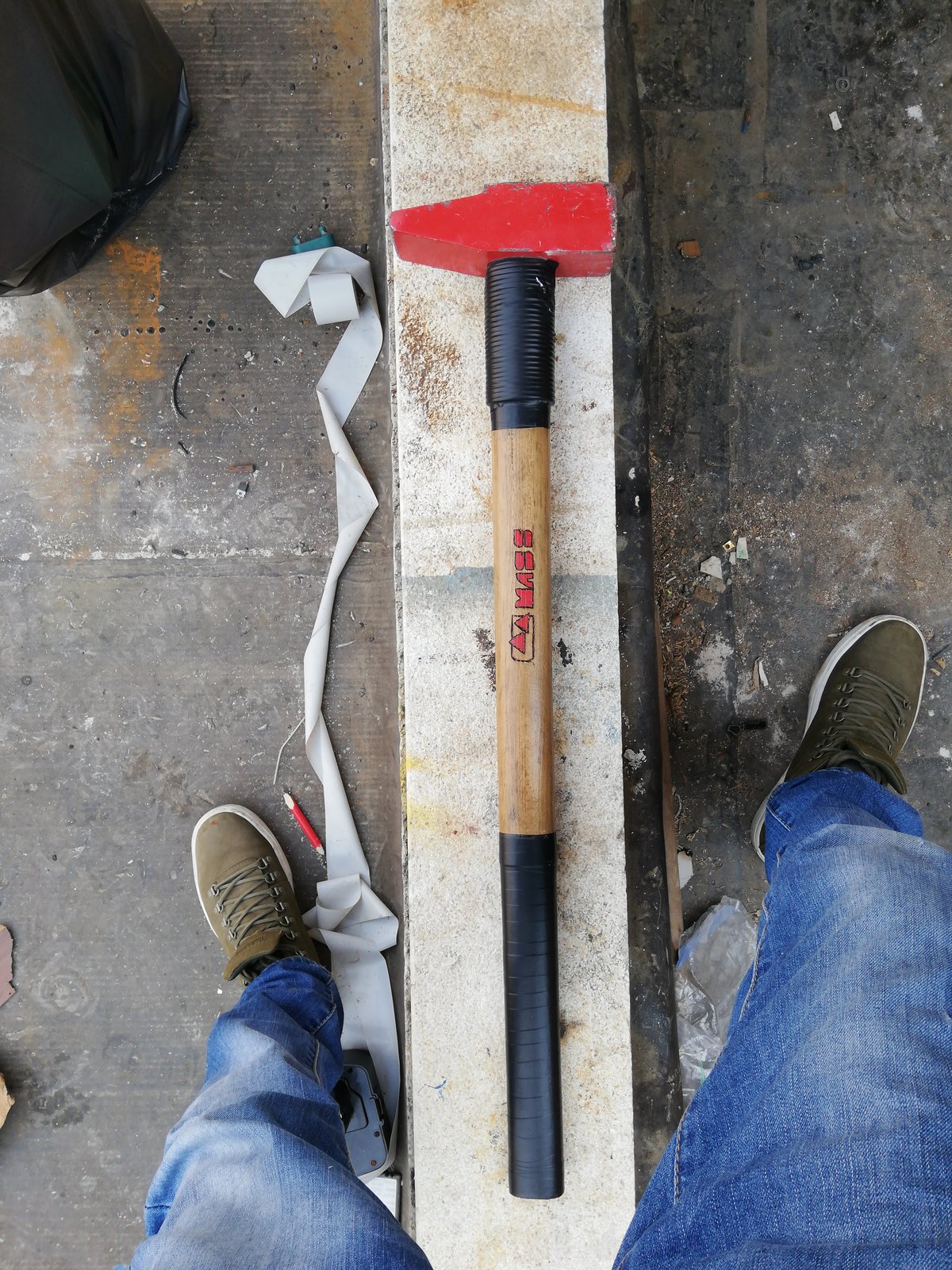

Yes maybe the sledgehammer is to much dangerous I know that ,I use to swing on a wedge splitter ,destroy wood stuffsave it to use or display there is a differance but as for use its prob not going to be that good
and your a braver person than i am you either know what your doing when welding what does seam to be strange as your asking what you need to use to fix the metal pole what seams to me are you dont know what you need to do to weld it well
but you have welded a sledge type hammer that im assuming your are using to break concrete etc swinging a 14 pound lump of metal over your head when you dont have enought experance to weld ?
pleass dont see this as an attack on you personly but as a bit of advice i dont know how to weld well and i will ask questions thats what the fourm is for but to weld some thing that is lighly to cause harm when you dont know what your doing is not a great idea

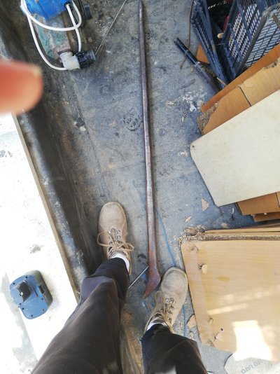

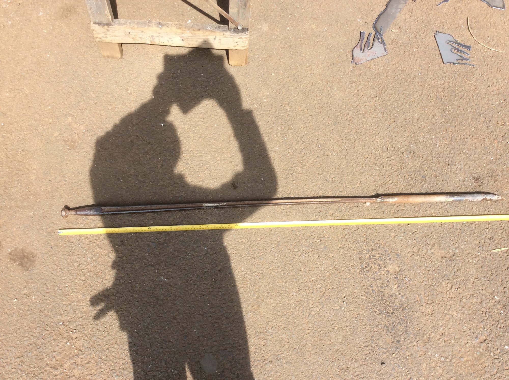

Yep that's the idea put it on the "could be useful someday"7018 are not thevrod to use. You can get small pack of repair rods suitable for higher carbon steels and cast.
That said you basically going to get rough with an item like this so i would not bother.
I have repaird many a medium carbon decking lifting bar etc by heating to red and just mig welding that generally works but if its a proper high carbon i can garantee it will break.
Best bet is repurpose the steel than try and create the same again. Put it on the" could be useful someday pile "
Cheap bars are ten a penny a good one would not have broken

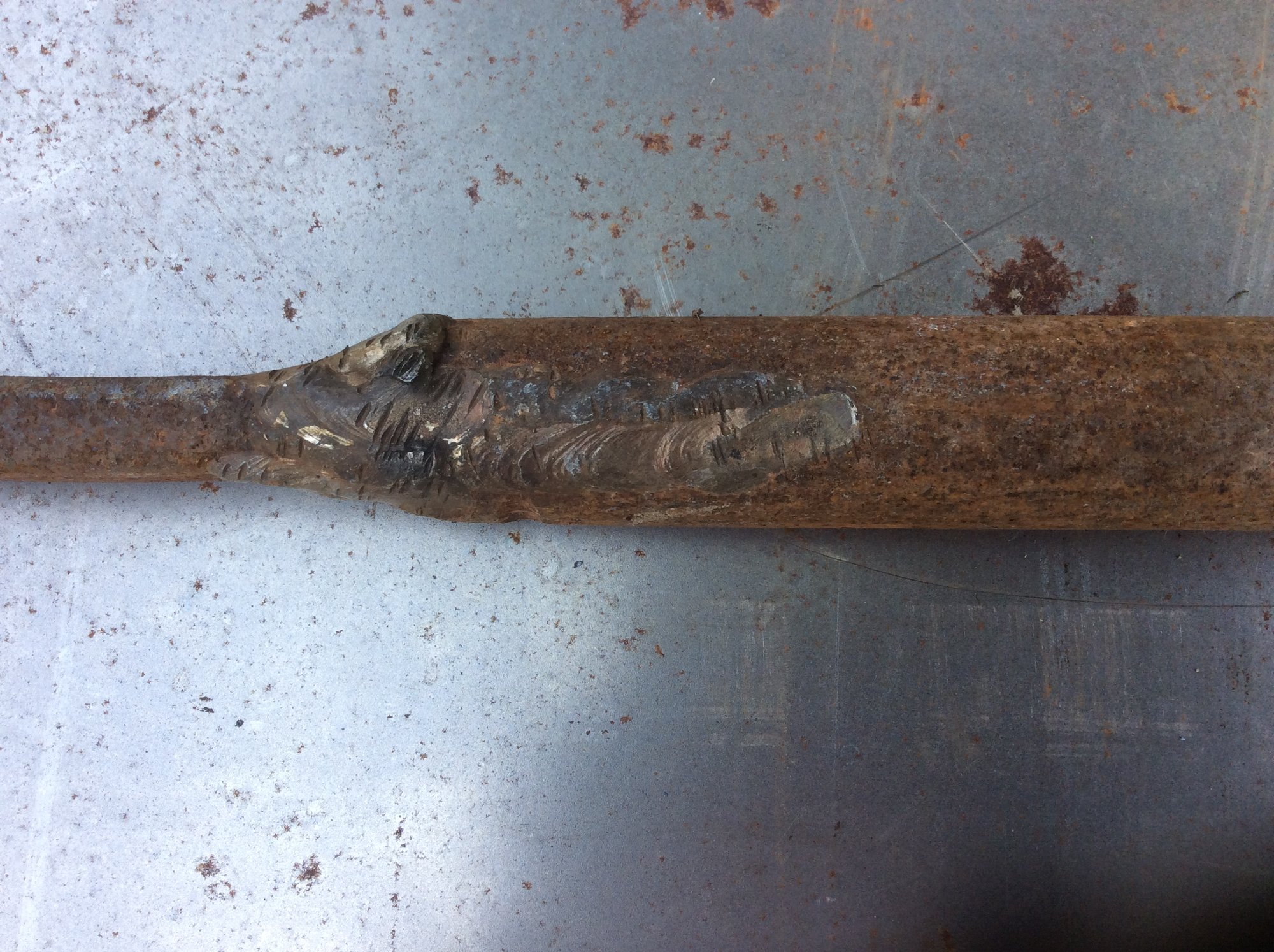

I can tell you that a weld in high carbon steel actually comes out more than snaps. Leavung a crator right around the toe of the weld pulling out all the bead
Its likely the pry bar could actually be welded ok from hot if it was say
En19 but the issue is nobody knows what it is.
The weld bead and its below the surface penetration plain comes out from the parent metal. Fairly course grain in this area.That's interesting what do you mean with
"Leaving a crater around the toe of the weld "

I will do this way
Bevel
Tack preheat to red
Weld
Just 4 strike of hammer
Slow cooling
If it works ,ok if not I teach myself a lesson (don't waste time)
About the hammer I have one that is been welded on the striking face , isn't been heat treated so Is relatively soft ,is that dangerous ? I think yes but not as a to much hard one
Is right my though?
I found it on the field I definitely didn't weld that ,the red one yes is welded on the middle section
