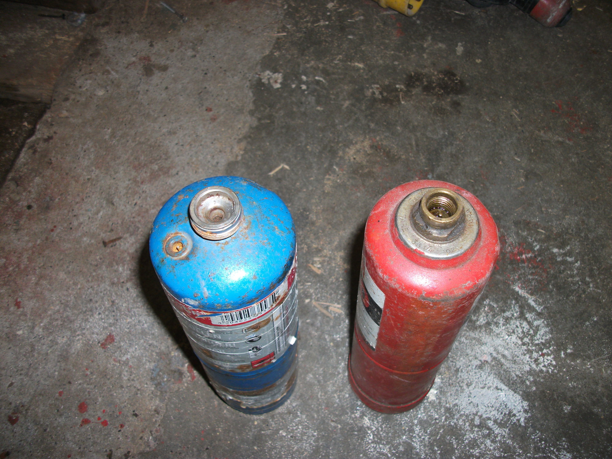

ready made . the disposable ones I have drilled and tapped the top and threaded a shrader valve in and soldered it as well because the bottles are thin then made an adapter to fill them as wellwell calor will say that when u can fill them for 50 pence and they charge a tenner . I have an adaptor to fill large propane bottles at the shell garageDespite the warning on the bottle not to refill, BS?![]()
just make sure the attendant don't see u doing it or they will kick off
and as far as safety is concerned using thin bottles they are thicker than the old camping gaz bottles and aerosol cans of it for refilling lightersha ha how much to fill a large bottle at the garage?well calor will say that when u can fill them for 50 pence and they charge a tenner . I have an adaptor to fill large propane bottles at the shell garagejust make sure the attendant don't see u doing it or they will kick off

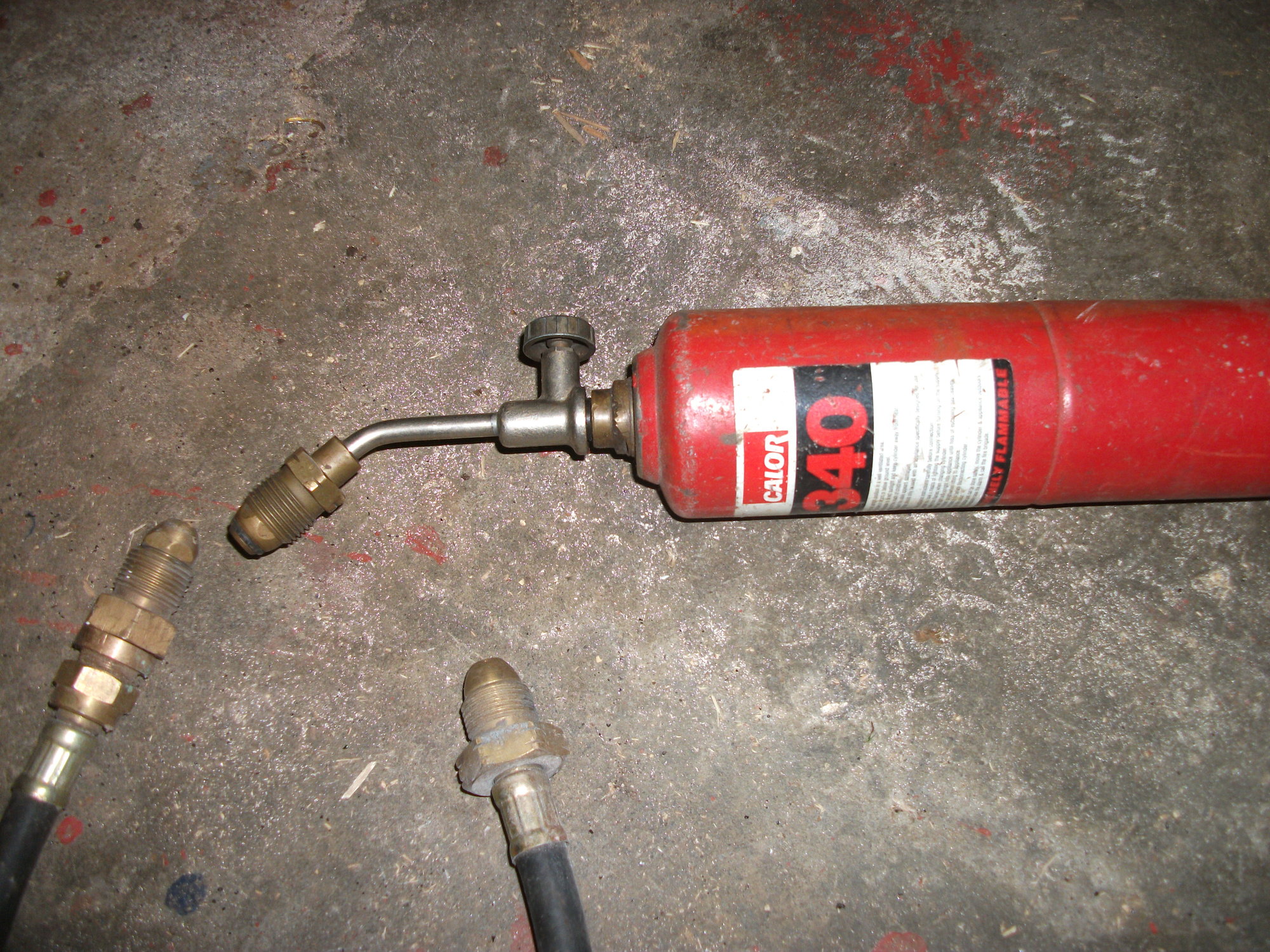

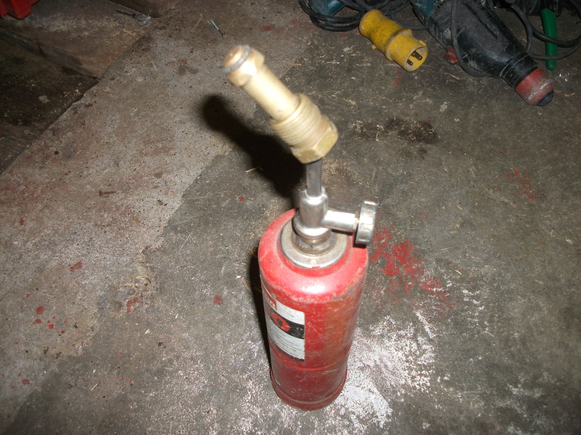

this is what I use. just cut the burner end threads of and re thread whitworth get a pol conector and drill out the sleeve and thread it screw it to the torch job done t5he only thing that needs removing is the one way safety valve fitted in the torch
the bottle u fill off has to be turned upside down and the filled bottle uprite underneath it so presumably u have large propane bottles to fill offThank you for that. It will save me quite a bit in the long run.
cant remember . I only got one filled a few years ago but cheaper than getting a bottle exchanged . I only fill the small ones because its well worth it
that top one does look as though it will screw in to the refillable primus 2000 bottles and the bottom one is the adaptor for the refill at the garage I can check tomorrow that the thread is quarter whitworth on the primus bottles and torch but to be honest it looks 2 small the threads look to be half inch£30!@brightspark do you think this could be a solution?
