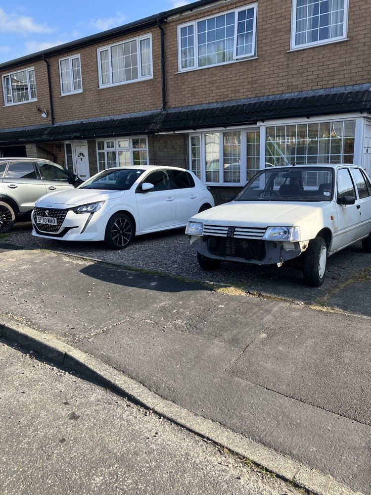

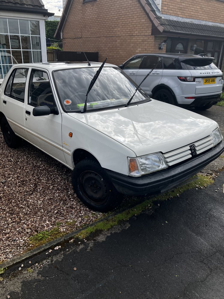

Bit of a coincidence here…..ex’s courtesy car turns out to be the 30 year newer version
i know which one i’d rather have
