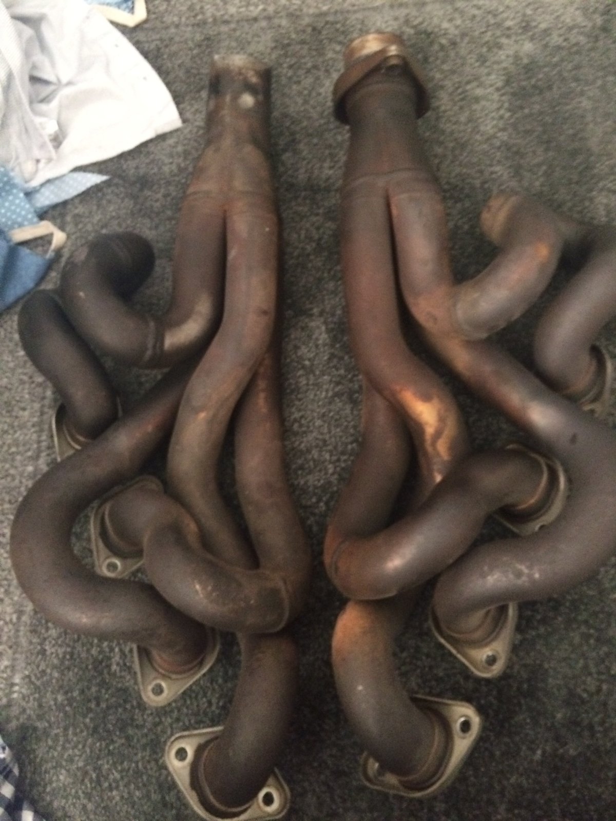

Lovin those manifolds, equal length I assume?

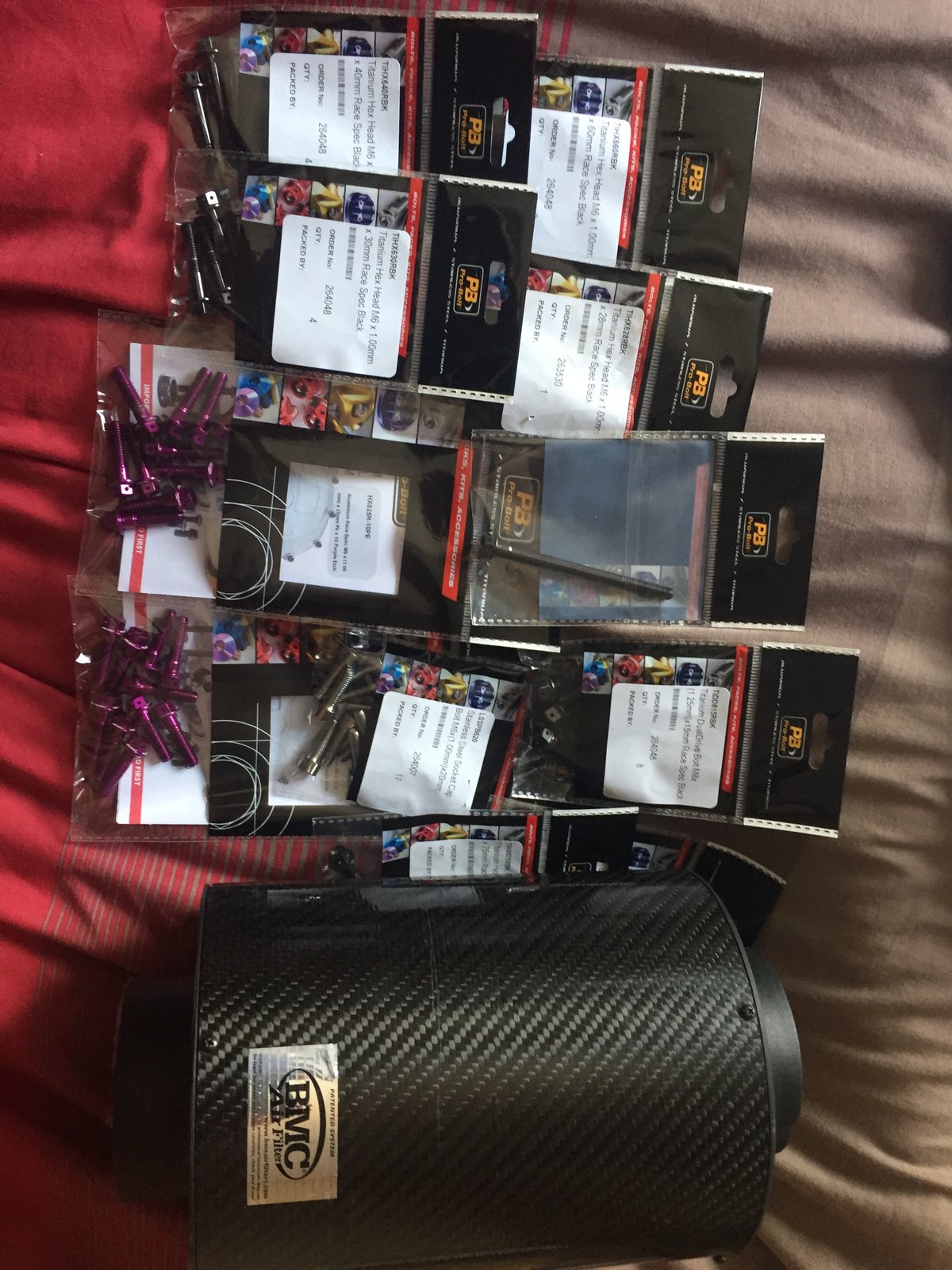

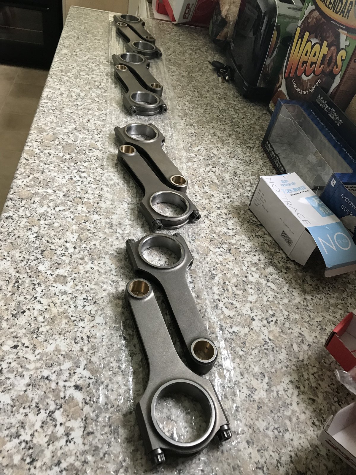

But after a long wait the special order is in Rods have arrived
And a few small bits
Swirl pot - lift pump
6 pot hi specs
Bmw timing tools
Starting on chassis relay box too

Those rods looks very similar to the k1 and manley rods. Have they got the arp2000 series big end bolts in them? As that is usually a weak spot for high performance engine.
