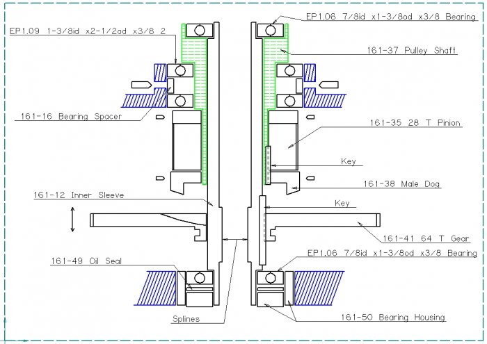

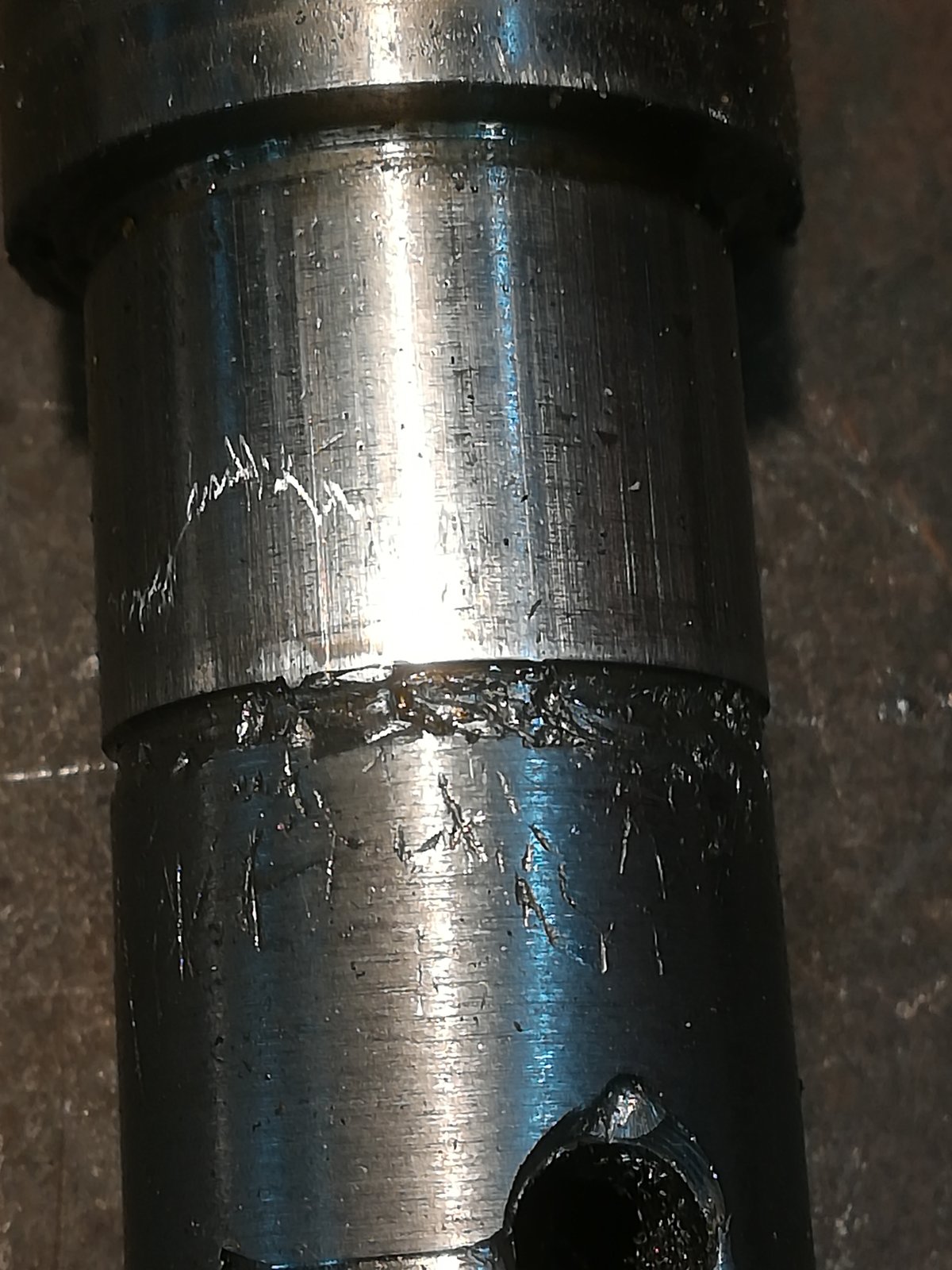

Looking for lower quill bearing for progress drill (double row thrust ball) tried the usual suppliers but no luck yet, @ronan & @rtbcomp did you change yours.

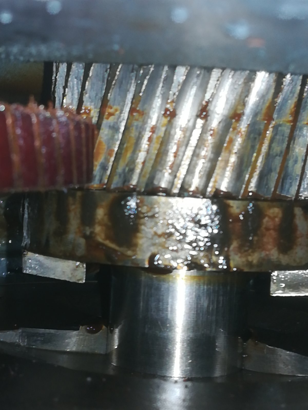

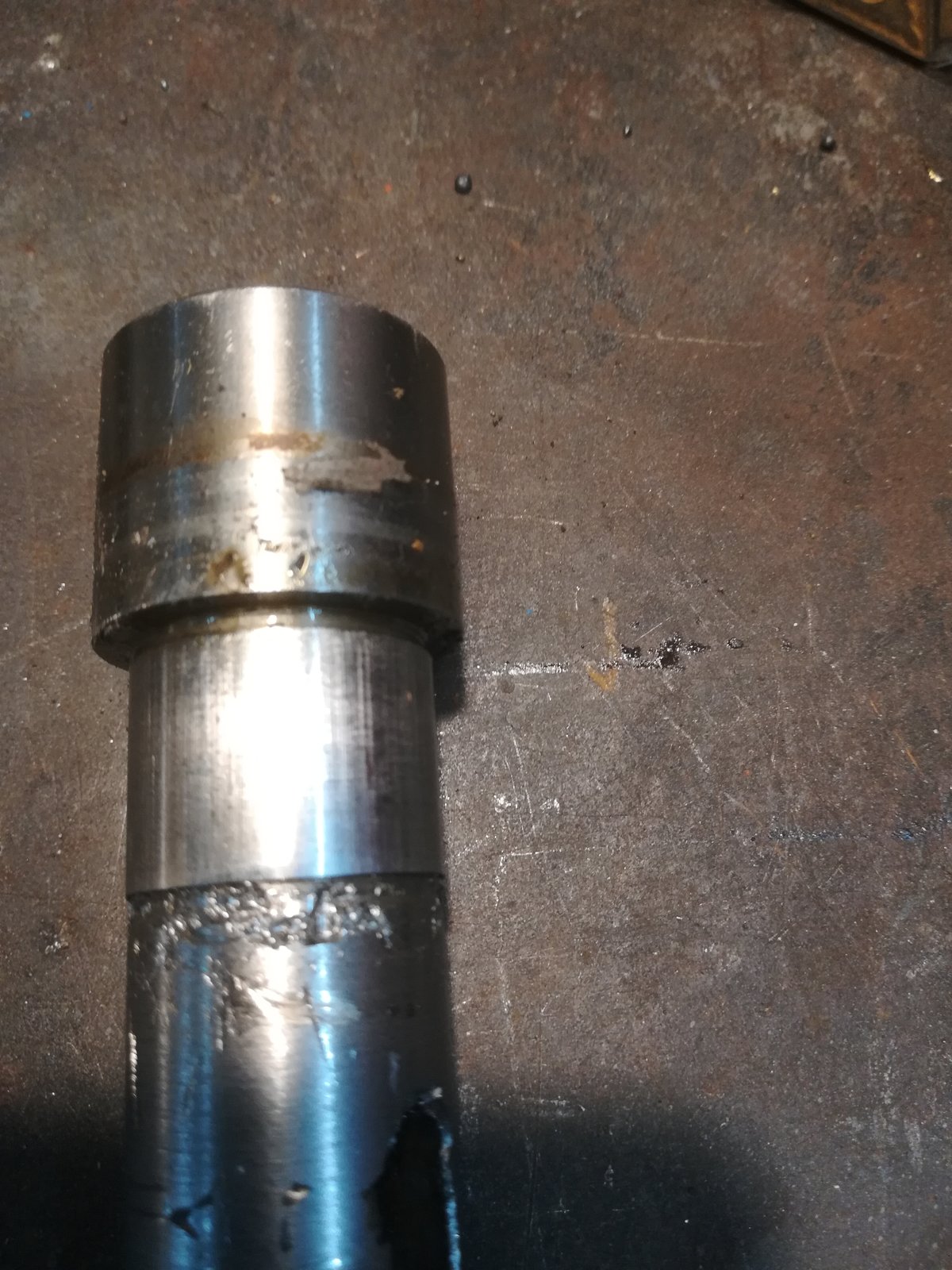

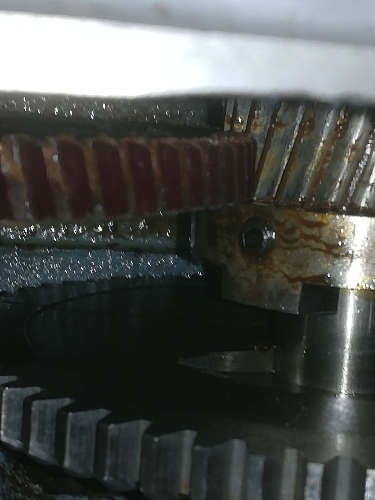

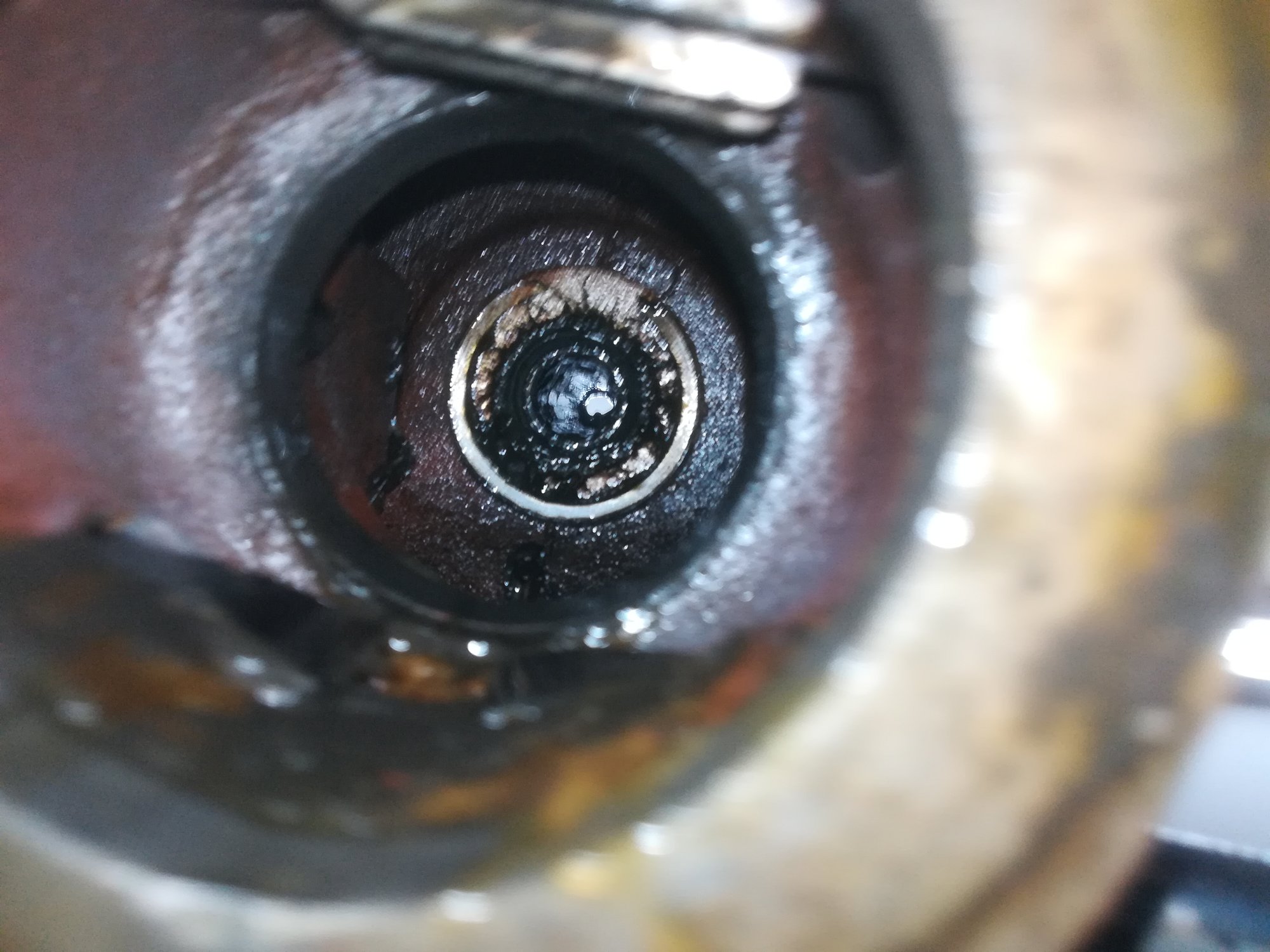

Drill locked solid found a 3/16 x 1\8 bit of hardened steel mixed up in quill above the lower bearing has made quite a mess of both the inner & outer quill, might have to build up the inner to re cut circlip grove.
No noise just locked when started cant find any thing broken the bit is so hard wont file almost like a broken ball or case hardened part.
