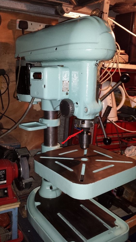

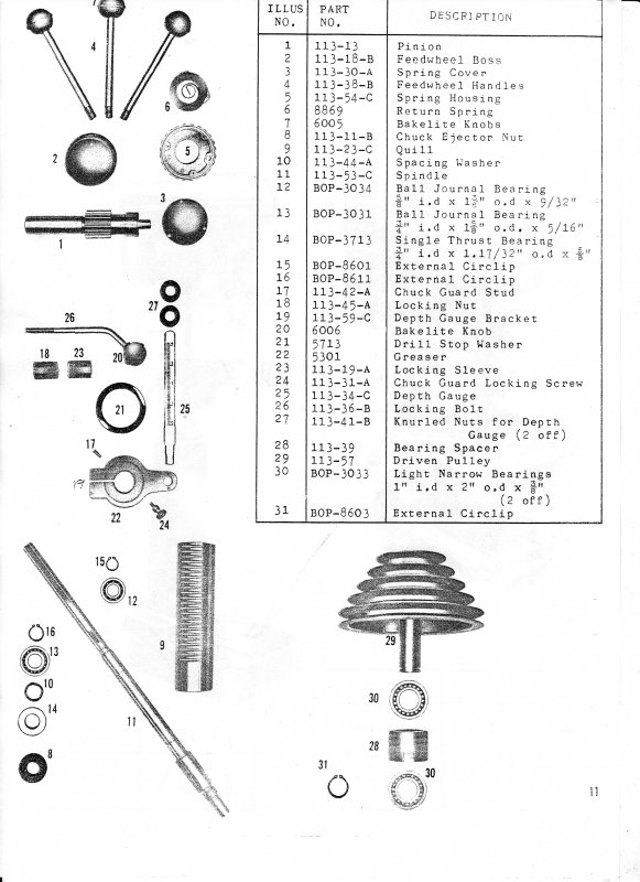

Hi, I'm new here and would like some information about a Progress No 1 I recently bought.
I am asking if anyone knows if the knurled collar on the quill is removeable. I think it's on a 3/4 32 tpi thread. The collar has a spanner hole but I can't shift it. It looks like a right hand thread.
I've seen info on this forum about Progress number 1's so I know some of you guys own them.
I changed the three phase motor to single phase and it was well worth it. A heavy beast but stable.
Can anyone help?
