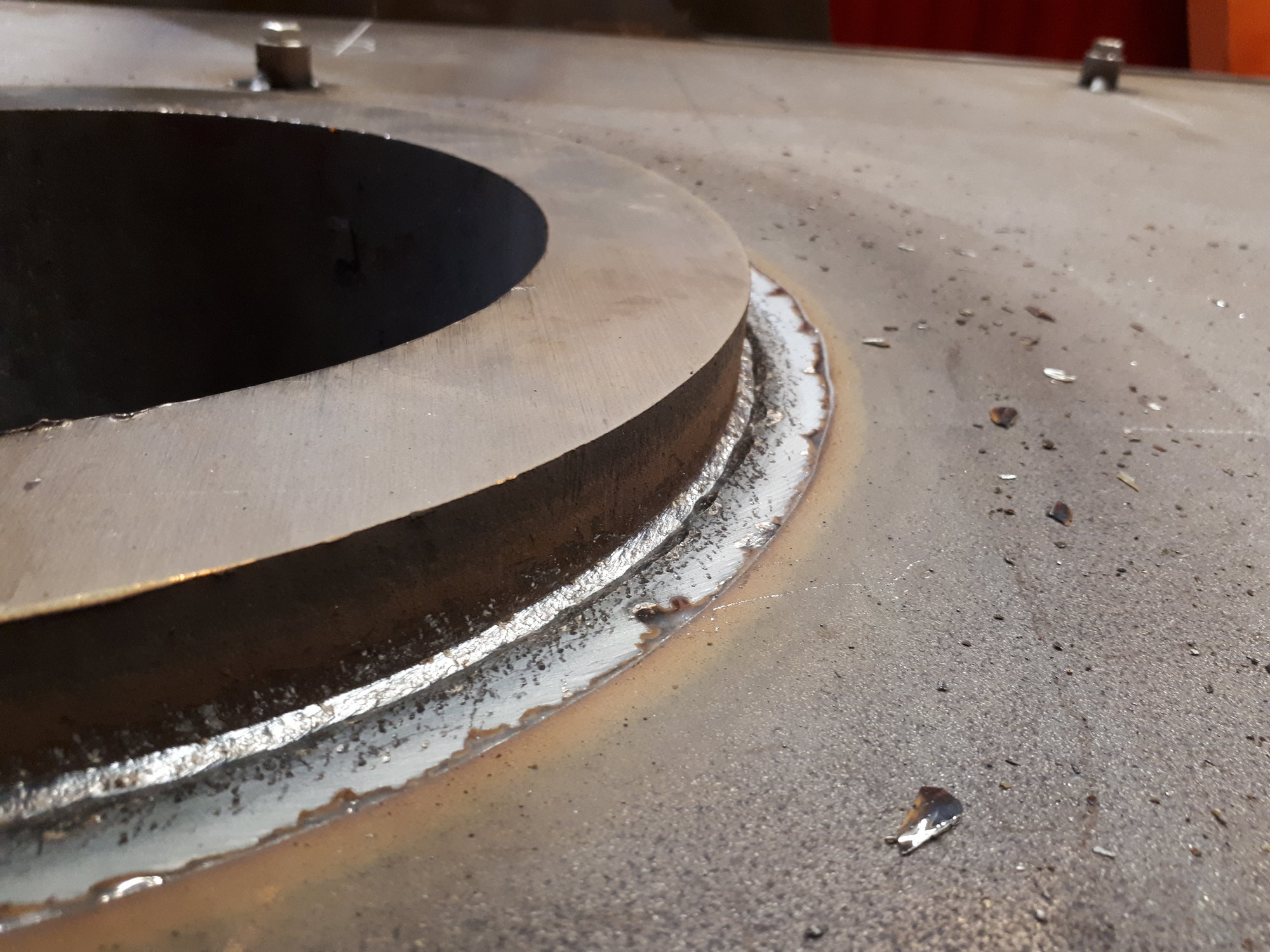

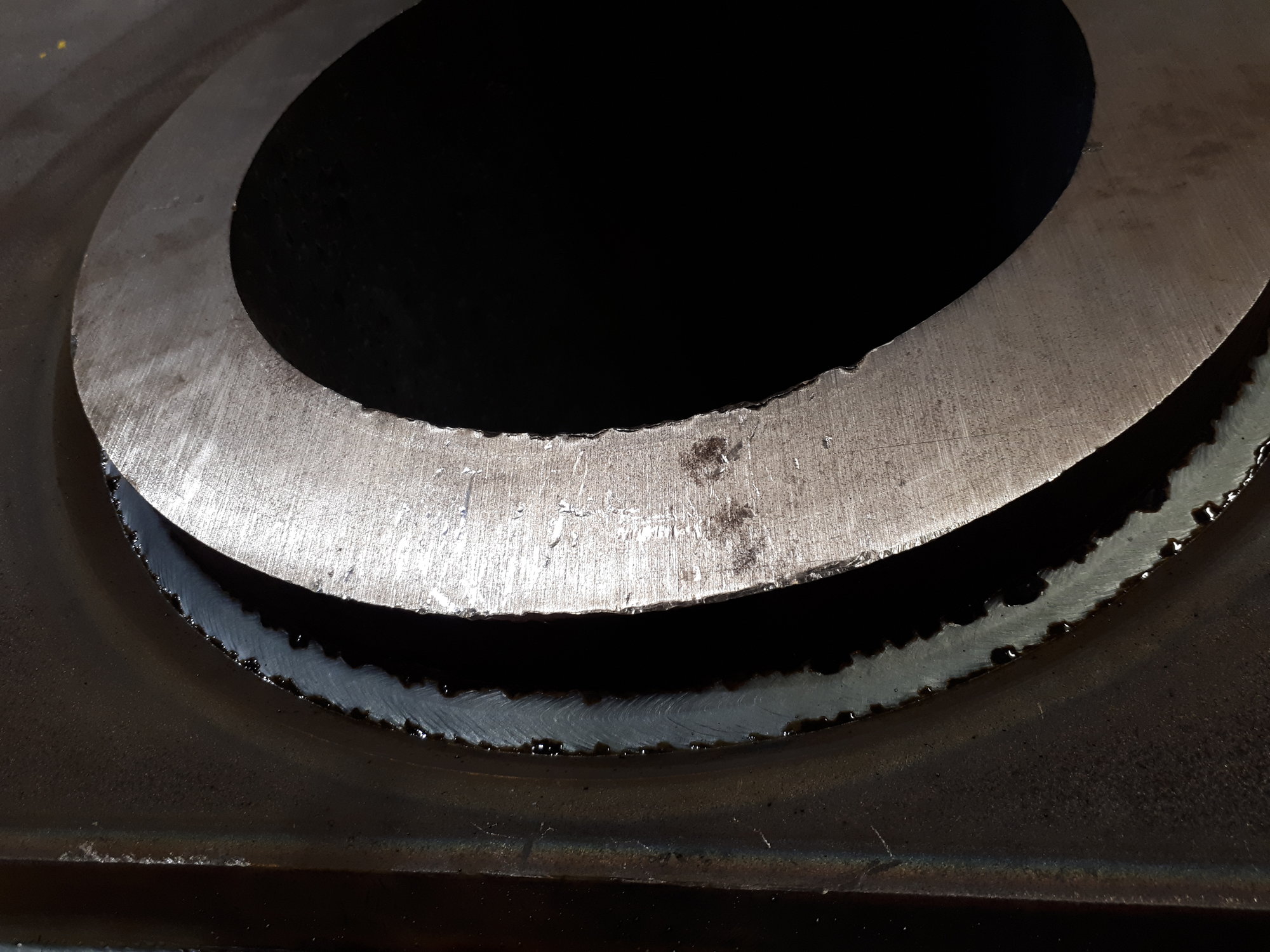

its hard to upload pics on this site...the speed i can only get from the pendent...i got the other parameters off the fronius machines...the sped varies according to fill group...but that is what is being read...im trying to convince company to take a macro ..i agree its all bait narrow and its when we get into 2 beads per pass we get into trouble
easiest to open an account on Imgur, upload pics and post the BB links from there.
I'm surprised a company has dosh to build a robot cell but not enough dosh to employ a welding engineer, (you know what i mean, no offence to you) I mean, I'm not a welding engineer either per se, but i do look after our manual pipe welding WPS, training and quality control for in-house work (chemical plant), and I know enough to know when I need to ask, and who to ask. I have a welding guy, several equipment guys, a WPS guy, a training guy, several NDT guys... gotta have a "guy" for everything and it sounds like you need a welding and WPS guy.
I hope Ed's training stuff is better written than his self-worshipping website. What he says is right, and clearly the problem you're having is related to the exact sort of problem he sees all the time. But on principle I'd be trying every avenue other than that one.
