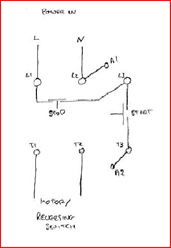

Any transformers on this machine that would reduce the voltage for the control switches or is it all 240v switching
Is it possible to check resistance between the motor wires and the case of the motor to see if it has a short, not ideal with a multimeter but may show something.
