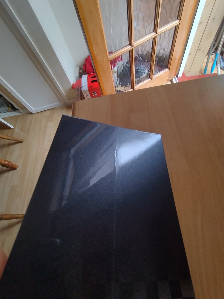

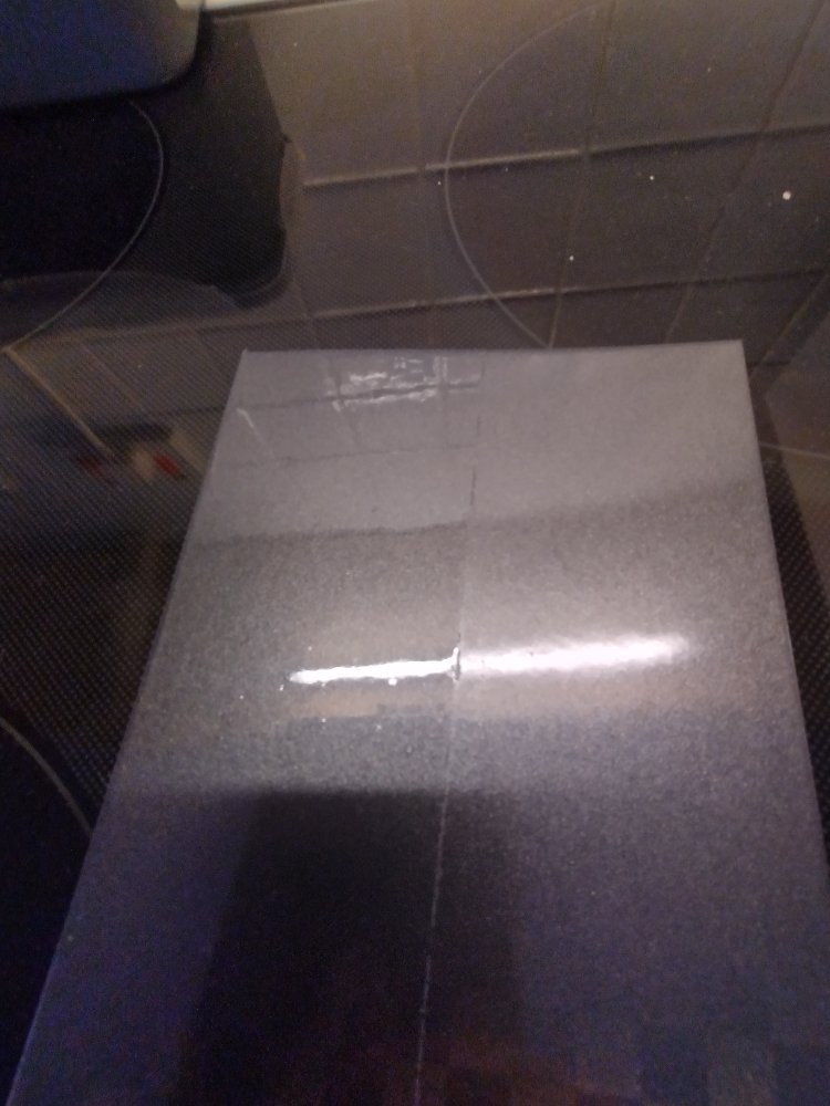

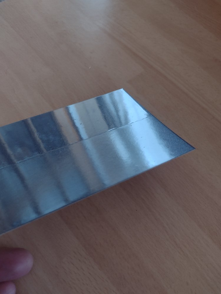

Not much of an in depth review I'm afraid, I don't use much 1k clear as it tends to be very poor, I needed some to flash over some door jambs so tried this pro xl ultra, hopefully you can see how much nicer it looks Vs another brand, very much has a 2k look to it and could be left as is , vs the other died back to almost no shine
might be worth a look if you need 1k clear, drys fast too
