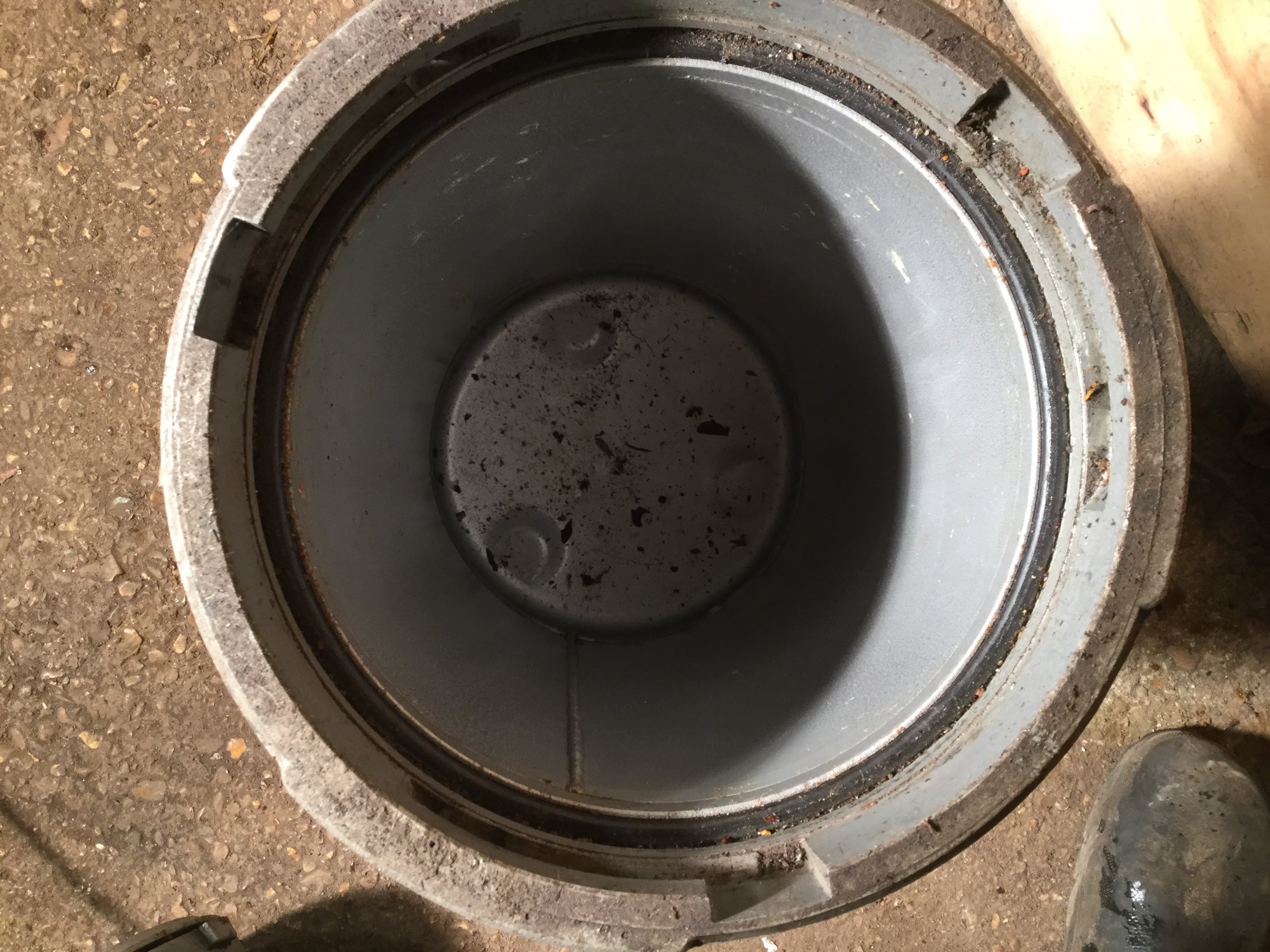

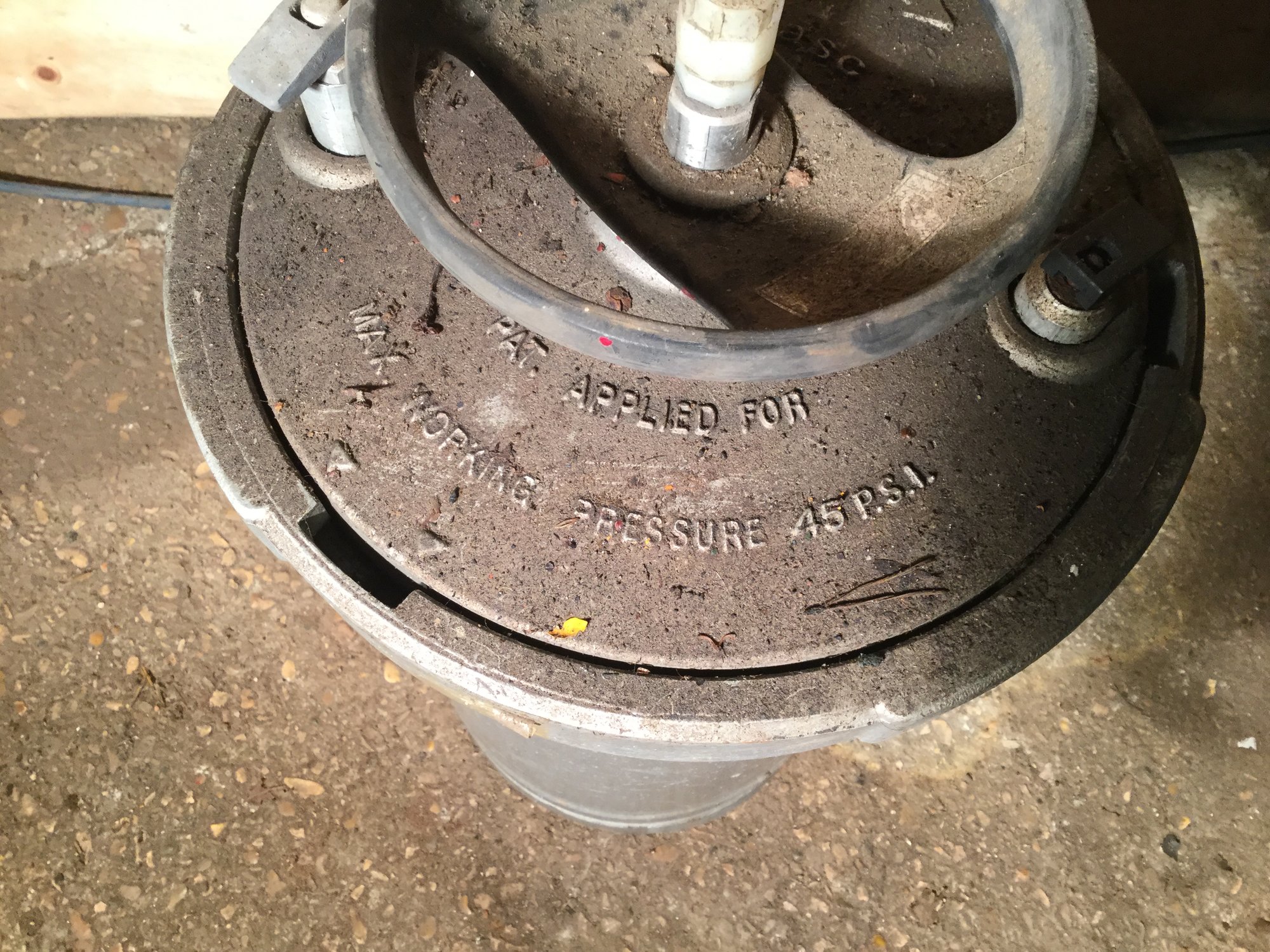

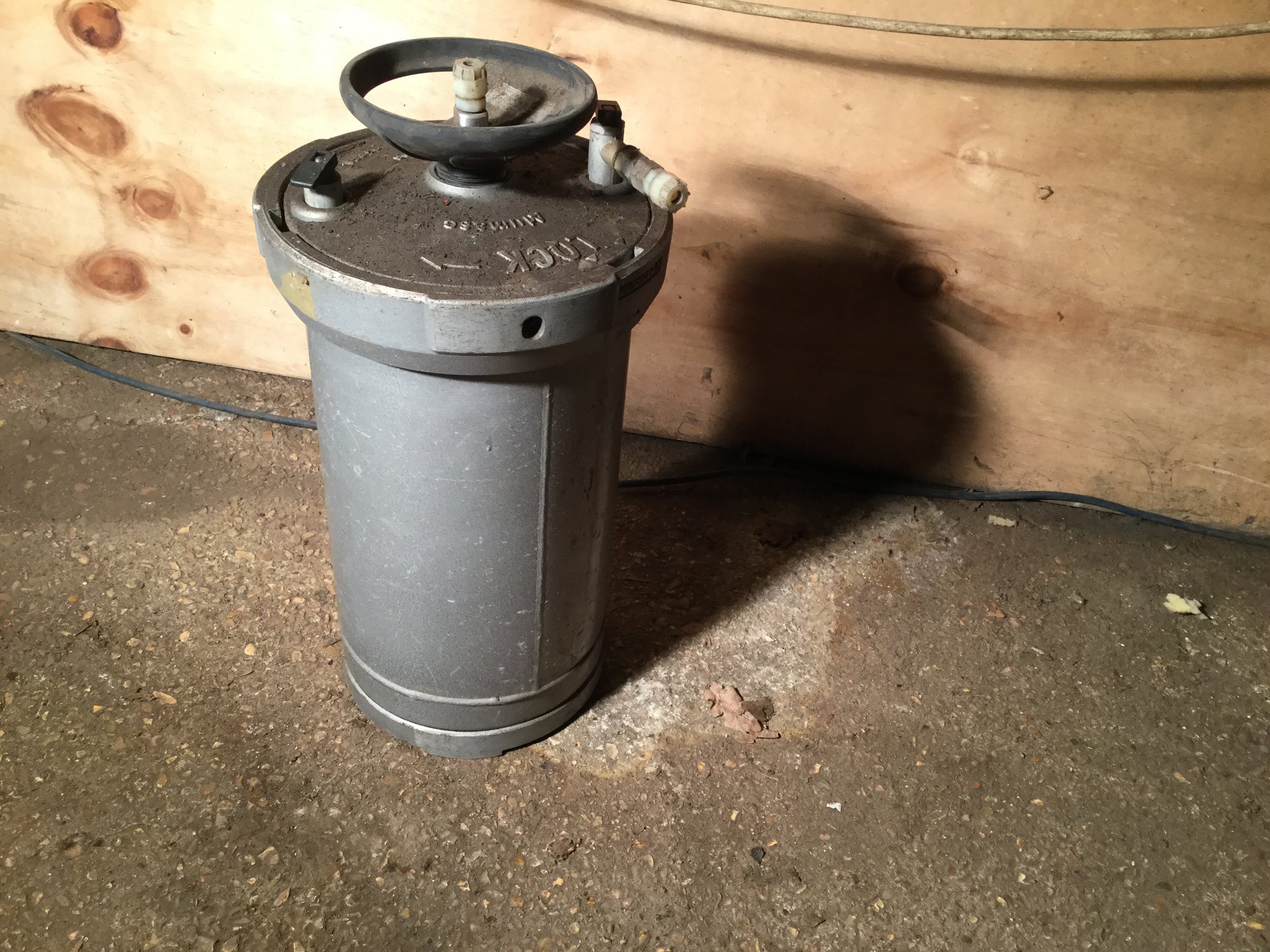

im going to remove the fitted valve, and fit a 40psi one.A pressure cooker's working pressure is 15psi, I'm not sure what the safety valves pressure is.
safety factors on pressure vessels a 4x apparently, so they should be good to 60psi.
ill do a waterpressure test up to 80psi before use - my guess is that the rubber seal is the weak point, and will start to leak, long before theres any failure of the aluminium.
thats how tbey seem to fail when the safety valves are blocked with food under their "normal" use. - and at least therell be no superheated steam!
- maybe a bit more for the safety valve, rather than the regulator valve.
