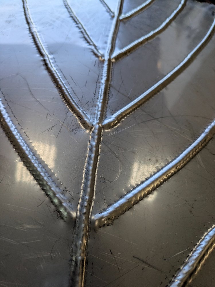

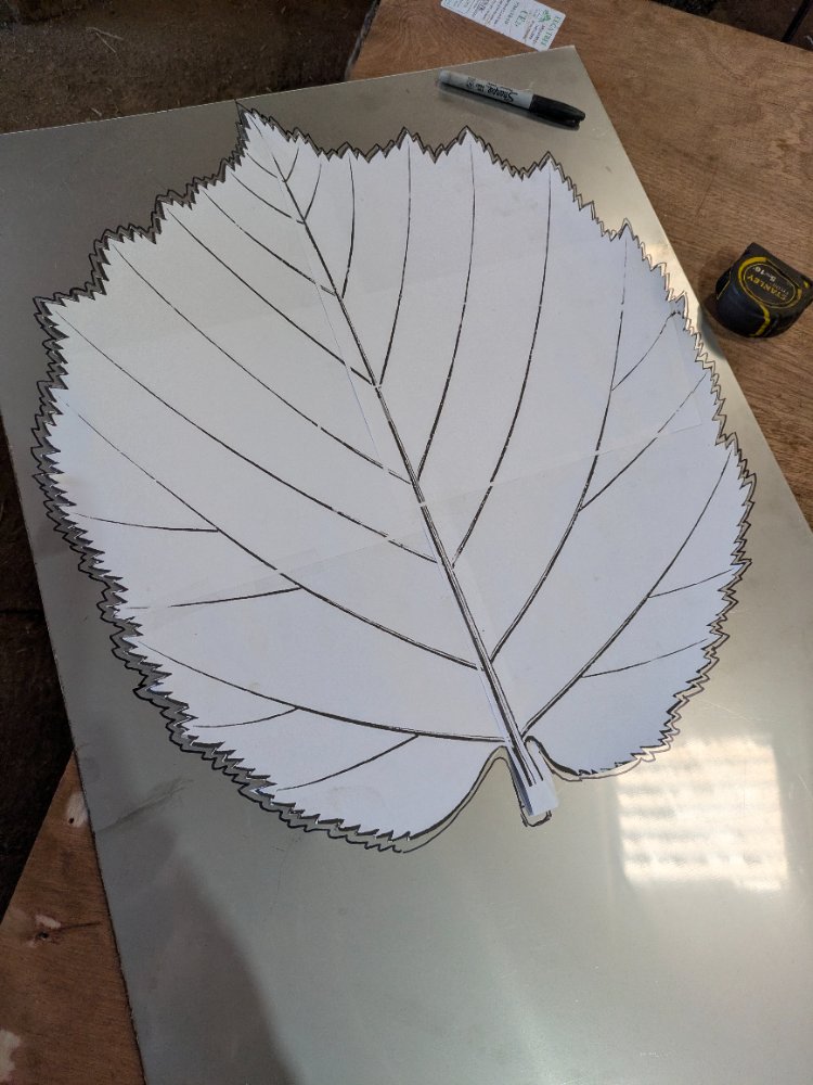

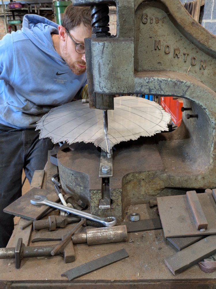

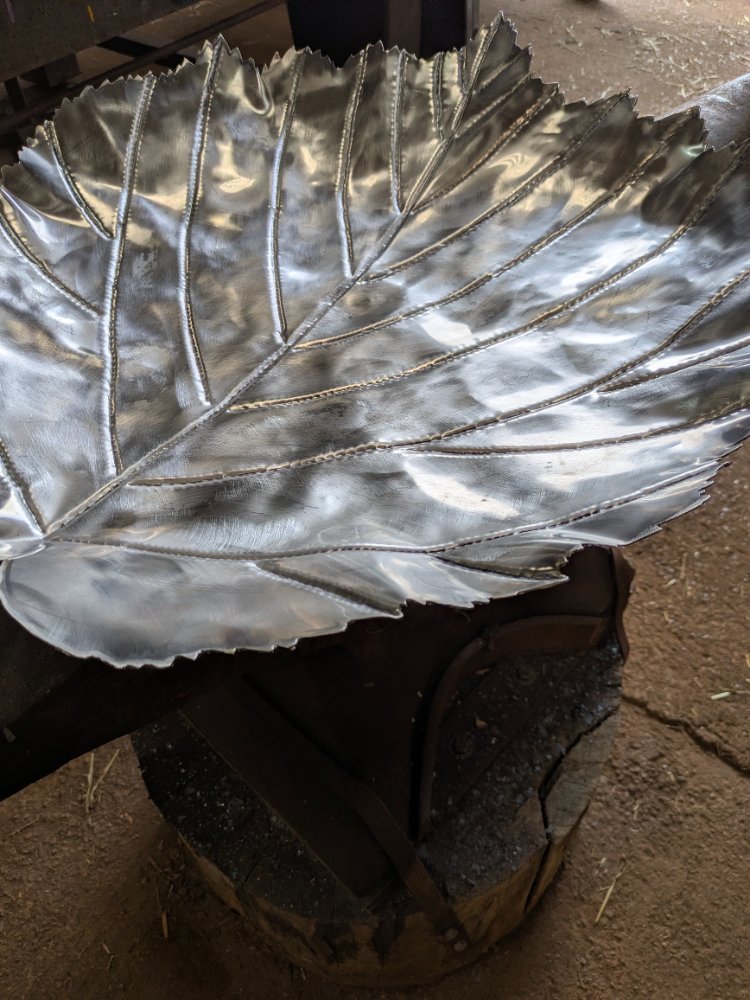

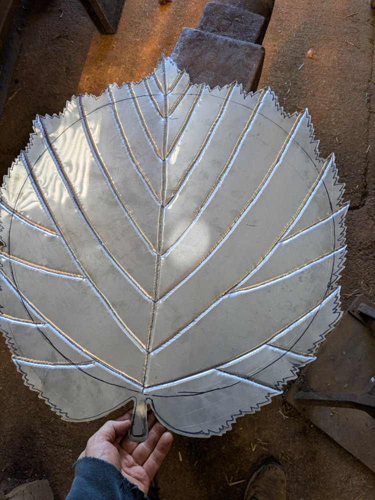

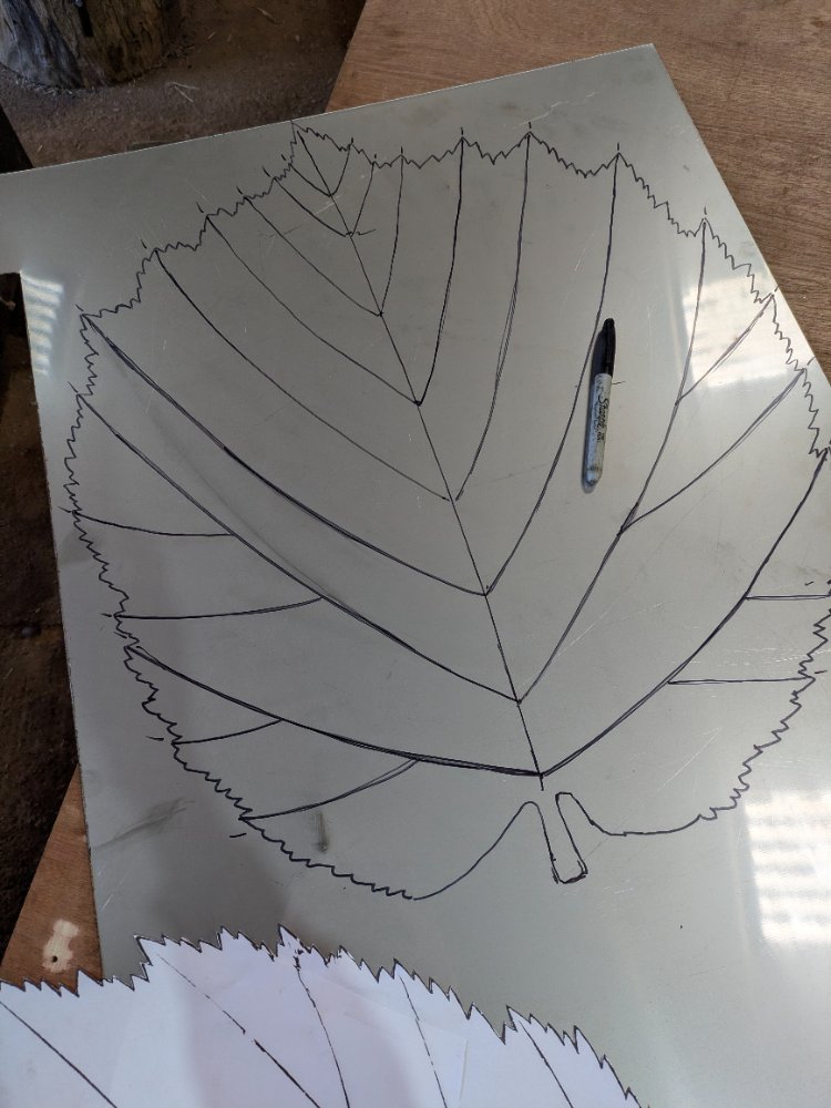

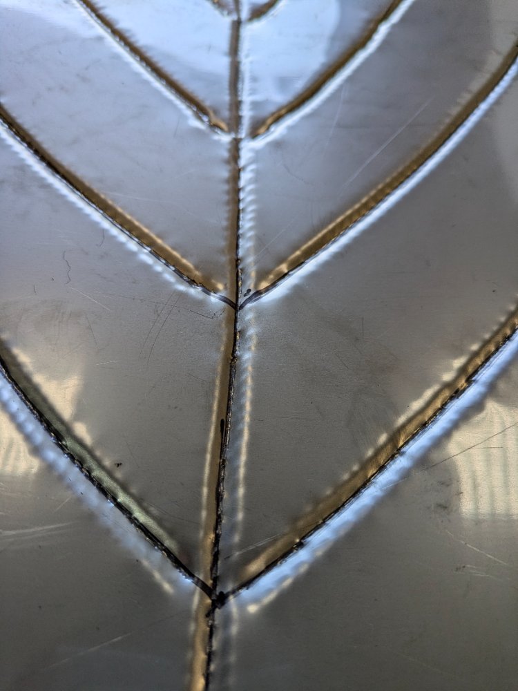

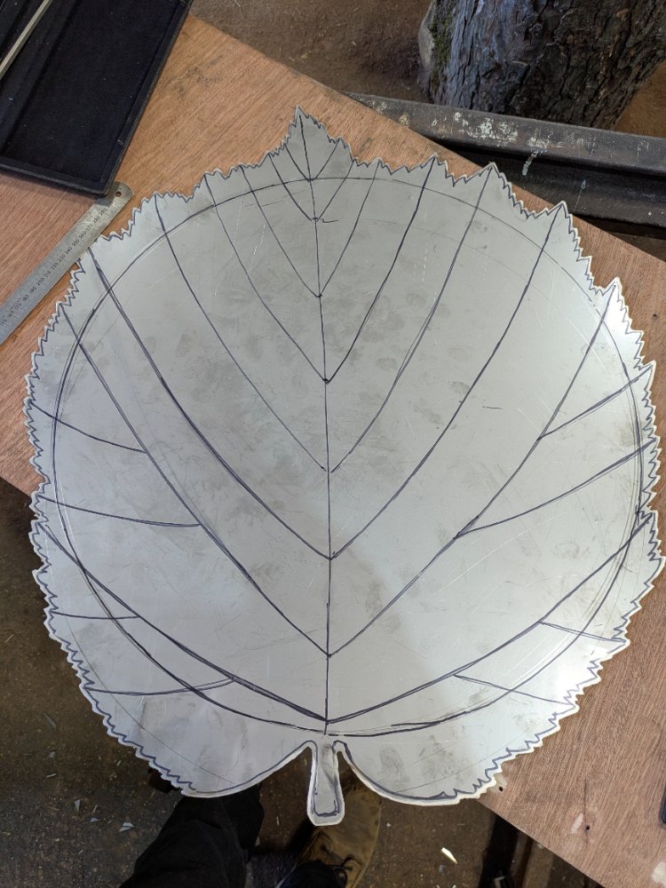

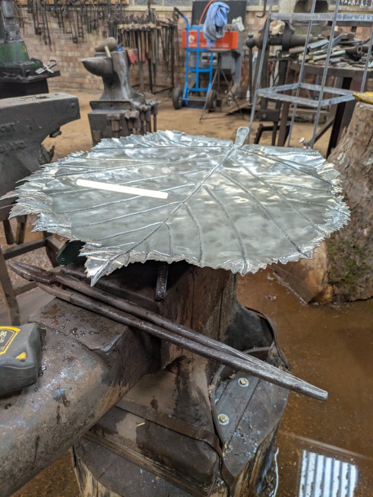

I'm working on a stainless bird bath at the minute with veins pressed under the fly press with some stainless tooling that I forged/fabricated from a bit of 25mm round.
It's going to have a hole in the middle so that water can be pumped up through the middle then trickle over the edges. Getting water to disperse evenly over the edges is time consuming but rewarding.
