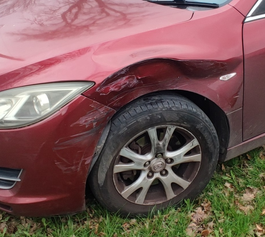

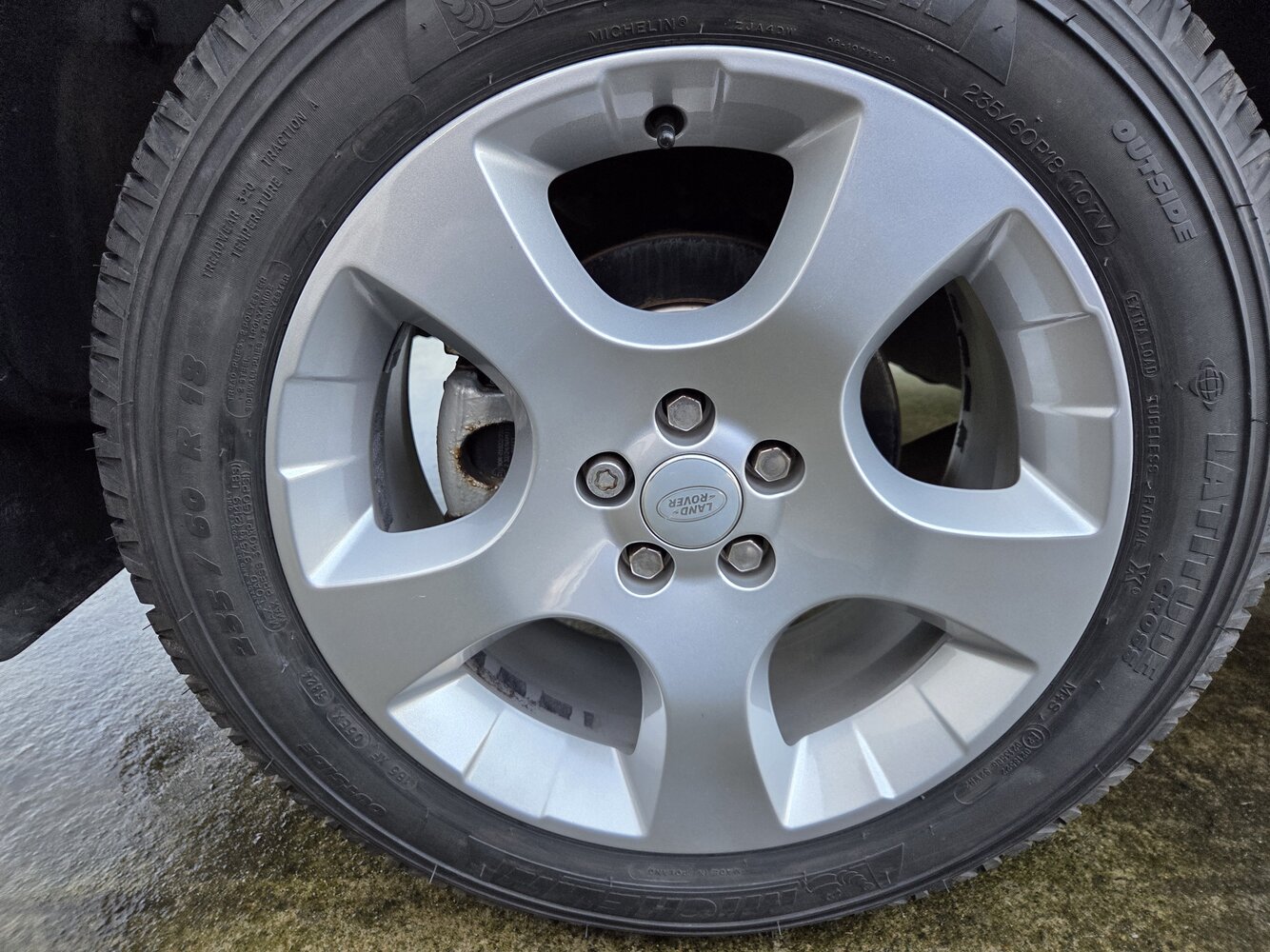

3-5 days and it took a week to get it booked in, they wanted an extra day for the diamond cutting. They are highly regarded though so ill post some after shots when done, sadly i have no before shots but the front pasenger side looked like it had a fight with a bin lorryOut of interest, what's their turnaround time? They're always stacked out with cars up on stands.

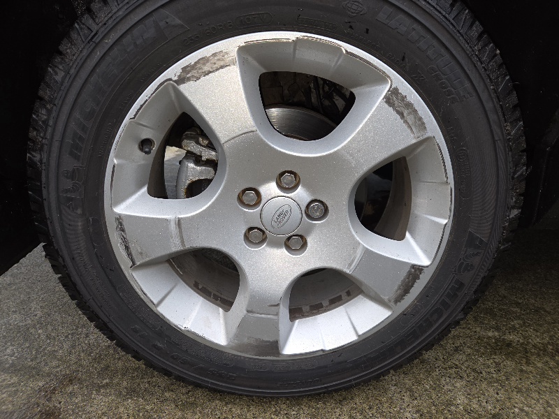

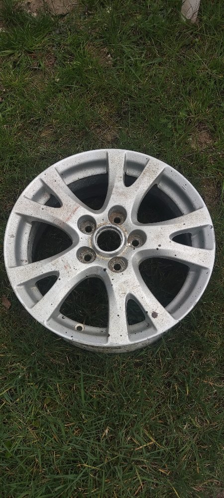

Mine looks similar. I'bve now.gotntwo spare wheels although neither look great, considering wheather to retire the crash scuffed one just in case theres any hidden damage.

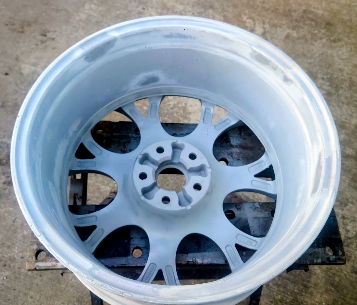

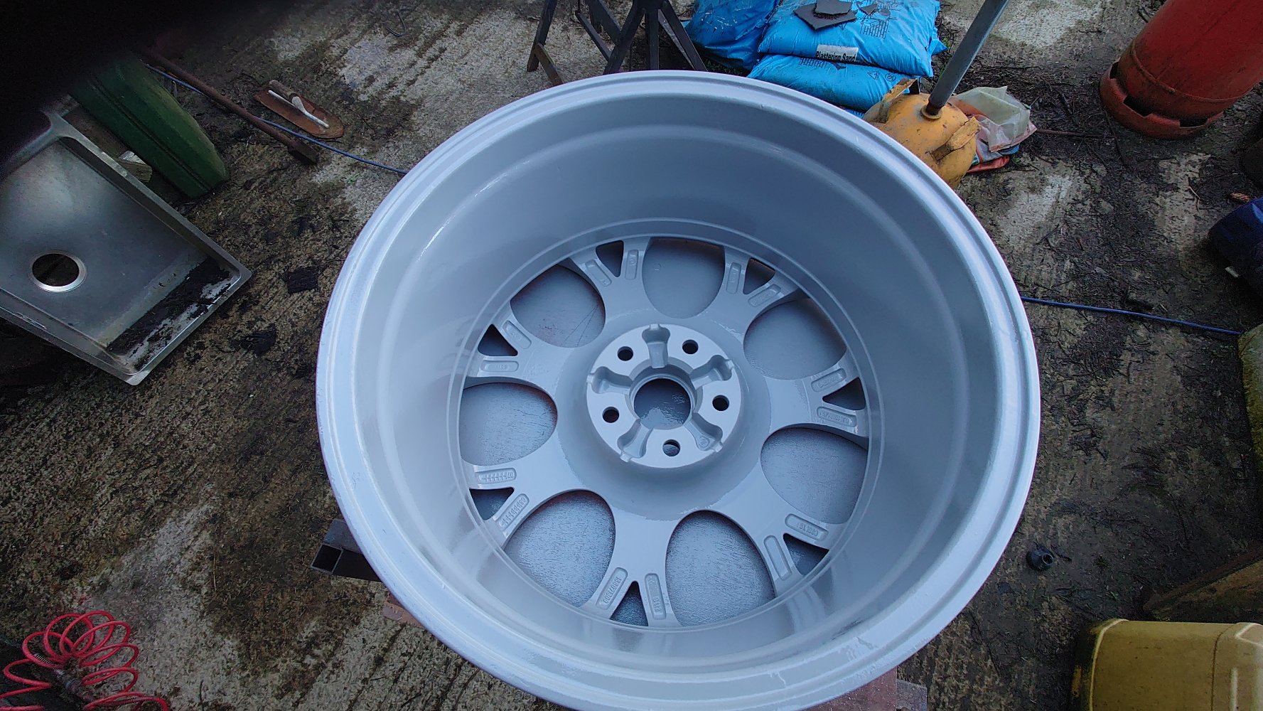

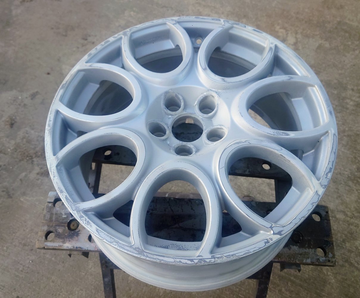

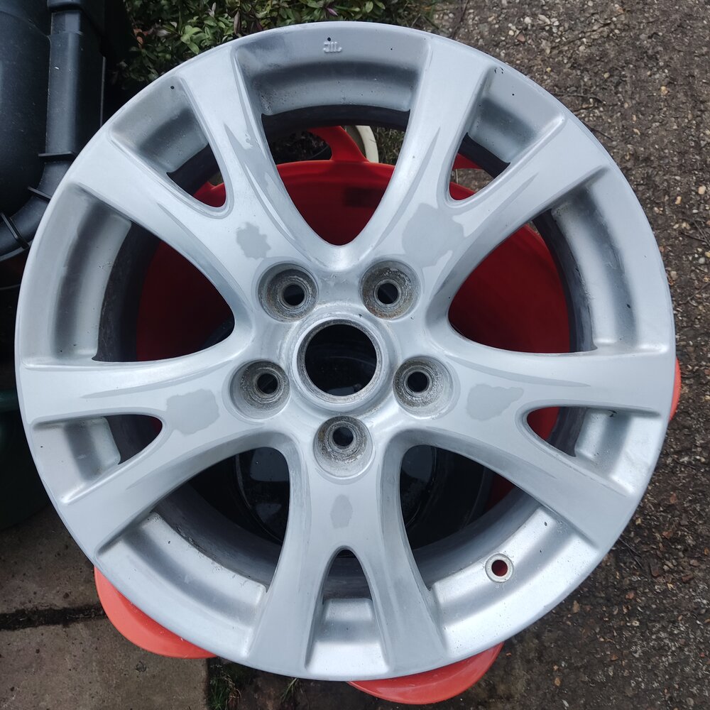

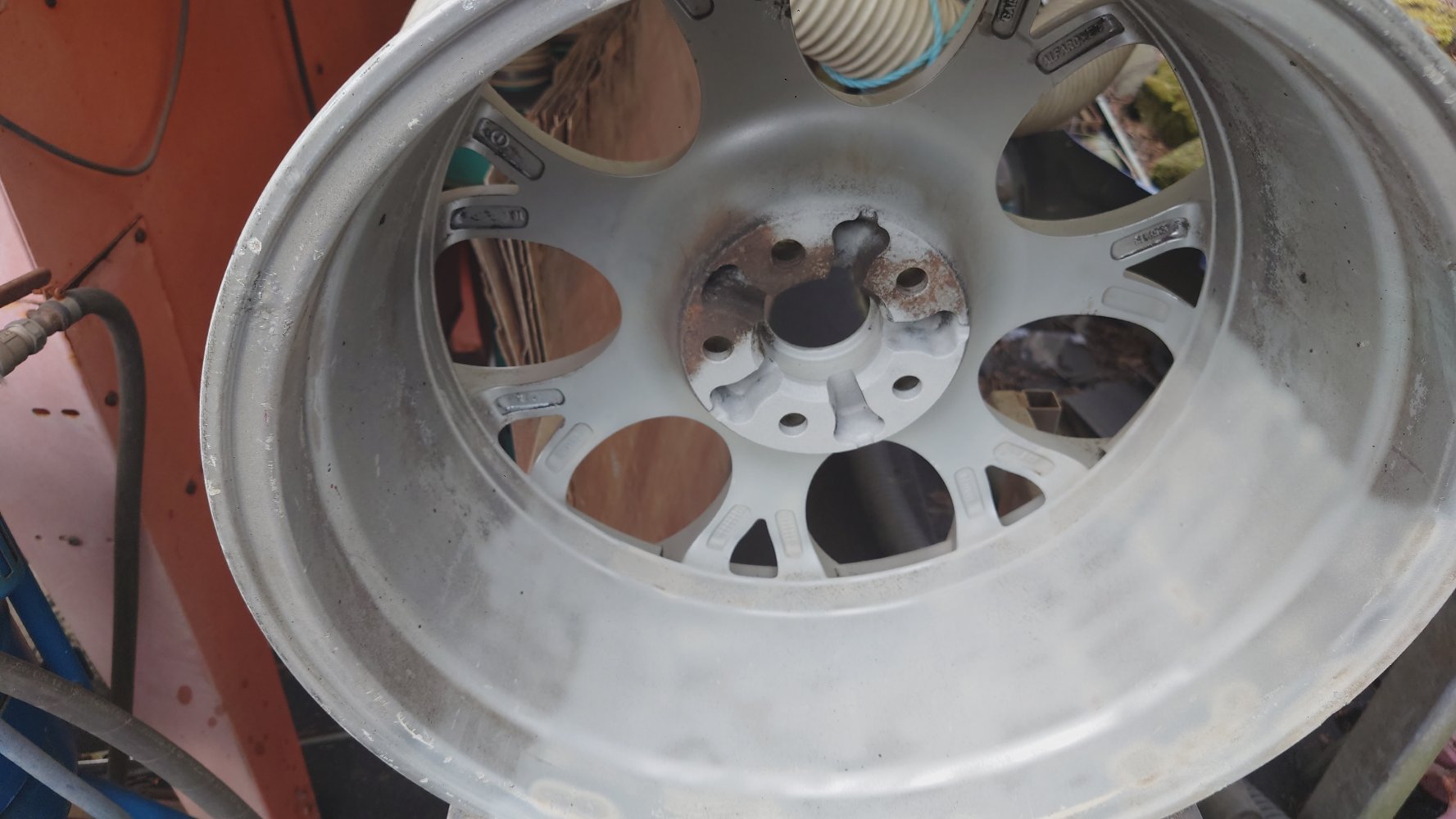

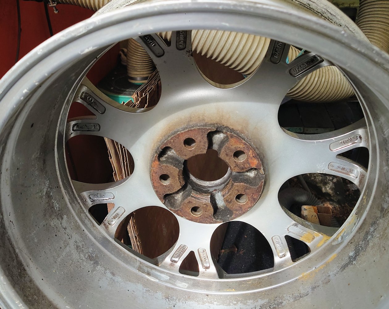

I dug out my first spare wheel which will be the first to repaint. After basic cleanup it sat outside for a while and suffered fence paint overspray and grinding dust, but I think its not too bad. Plan to key it, primer the bare sections, flat it, base and top.
The current question, should I epoxy primer the whole rim or just the bare sections? I'd like to minimise the prep.
