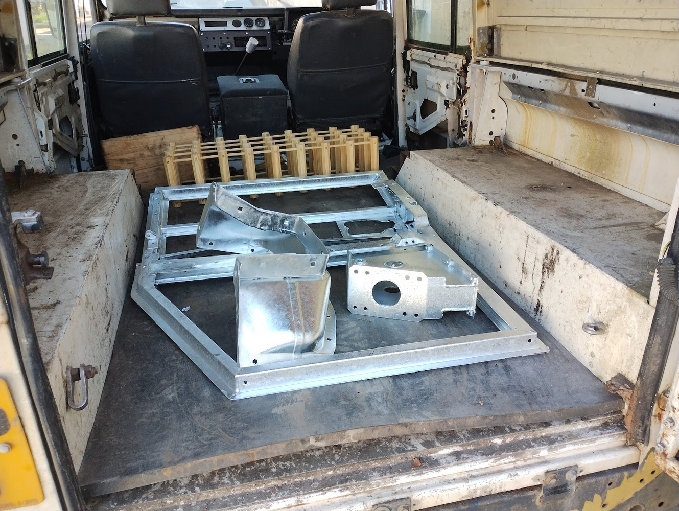

whats the best way to prep car panels that are galvanised ? will most lilkley be using epoxy primer
2k acid etchEtch primer, all day long.
I have to say, iwould use mordant solution before epoxy. Apparently the gasses from the process can get under the primer if not neutralised.
Nick
Is that "would" or "wouldn't"?
I don't think theres any gasses involved in dipping in zinc. We all know if it gets too hot it burns off, but hot dip is going to be below that temp.
