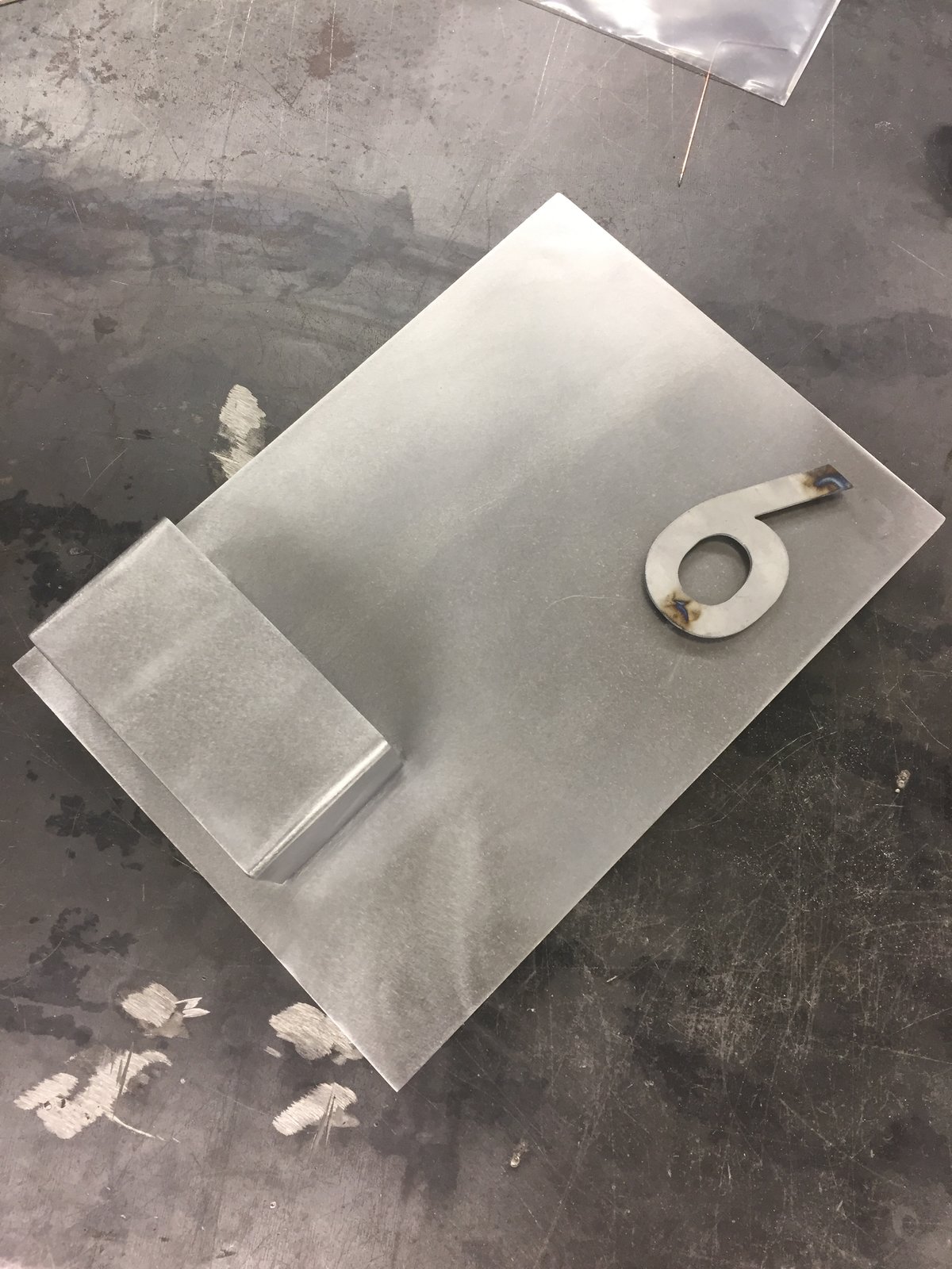

I've had good success removing scale with hydrochloric acid. I've mainly dipped small parts but you can paint in on with a brush. The scale melts off leaving a surface that looks like it's been blasted (pic below). Once the scale is removed the surface will go rusty really quickly but rinsing with bicarb of soda helps prevent that. You sculpture would take a 5 litres (£20) and a couple of hours to do.
