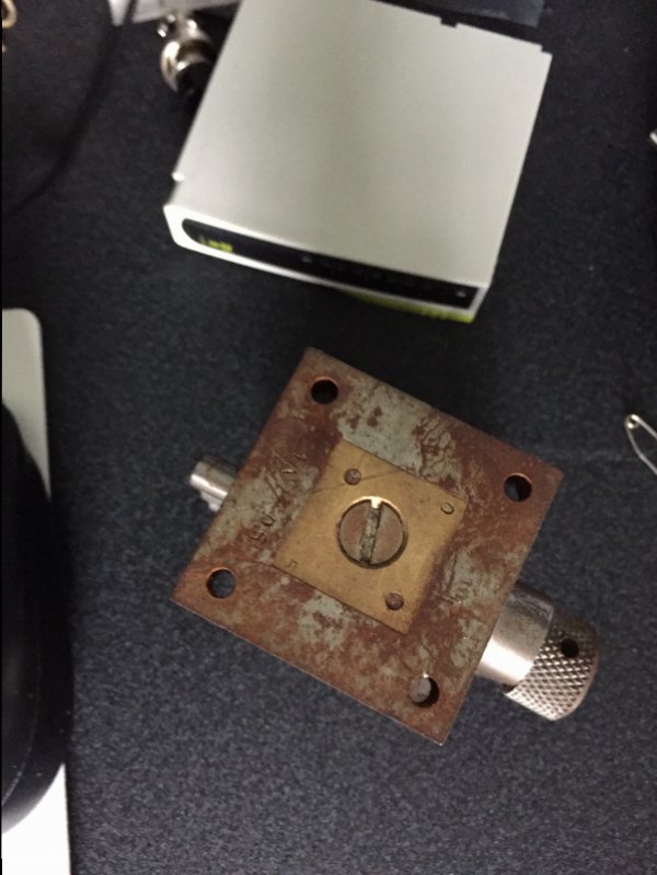

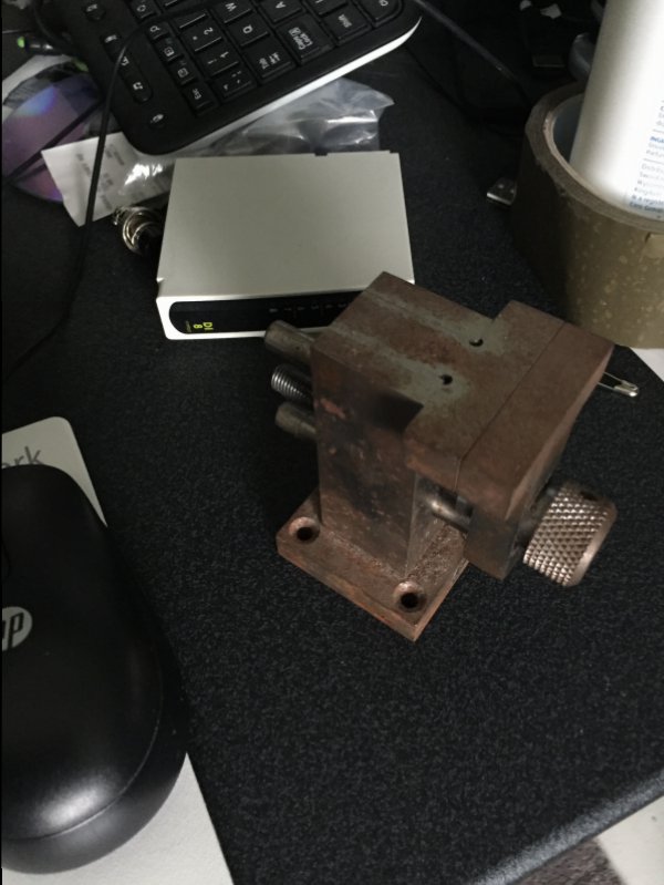

This was my effort from 20odd years ago, usually sits behind my computer monitor doing sterling work as a business card holder nowadays. The bottom brass square had to fit all ways with no gaps, the whole thing was filed, scraped and chiselled from proper old scaly metal. The one saving grace was that during workshops there was no revision for exams so you could go out and get plastered.There will be others here somewhere that have also done apprentice or exam pieces like the one you describe. It was a standard piece of work, years ago
