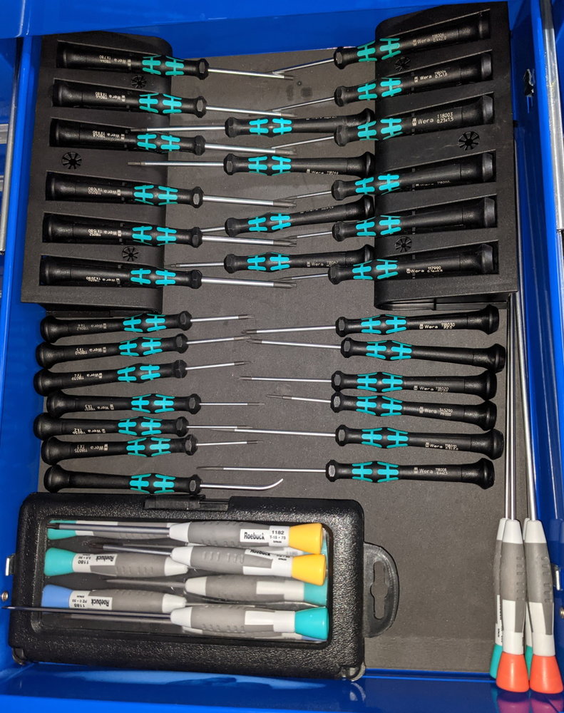

I think Roebuck was/is the house brand for Buck and Hickman, kind of a Zoro before Zoro. They are good quality.

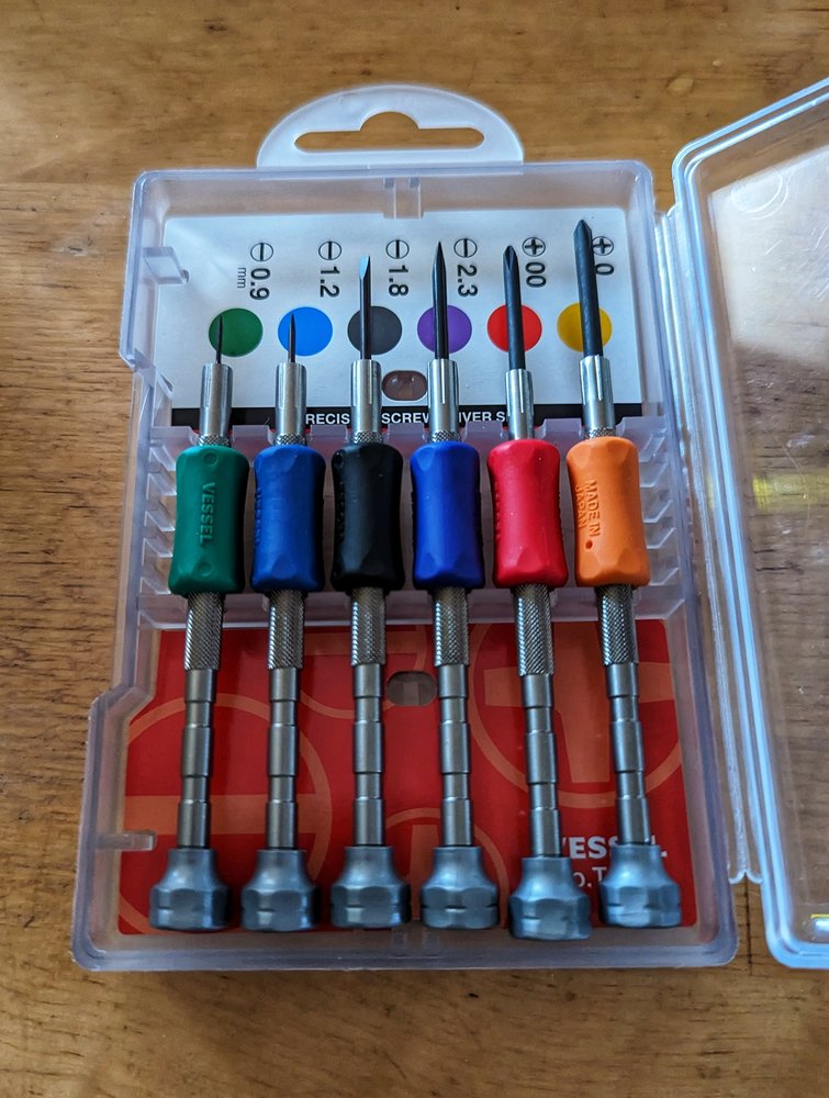

Would I need to saw the ends off to enable them to fit in the collet?
Hopefully not. It depends on what series collet you use. You need one with the small diameter of the collet larger than the rotating head on the screwdriver. Poke the screwdriver into the back end of the collet, add the closer nut and screw into the holder.
