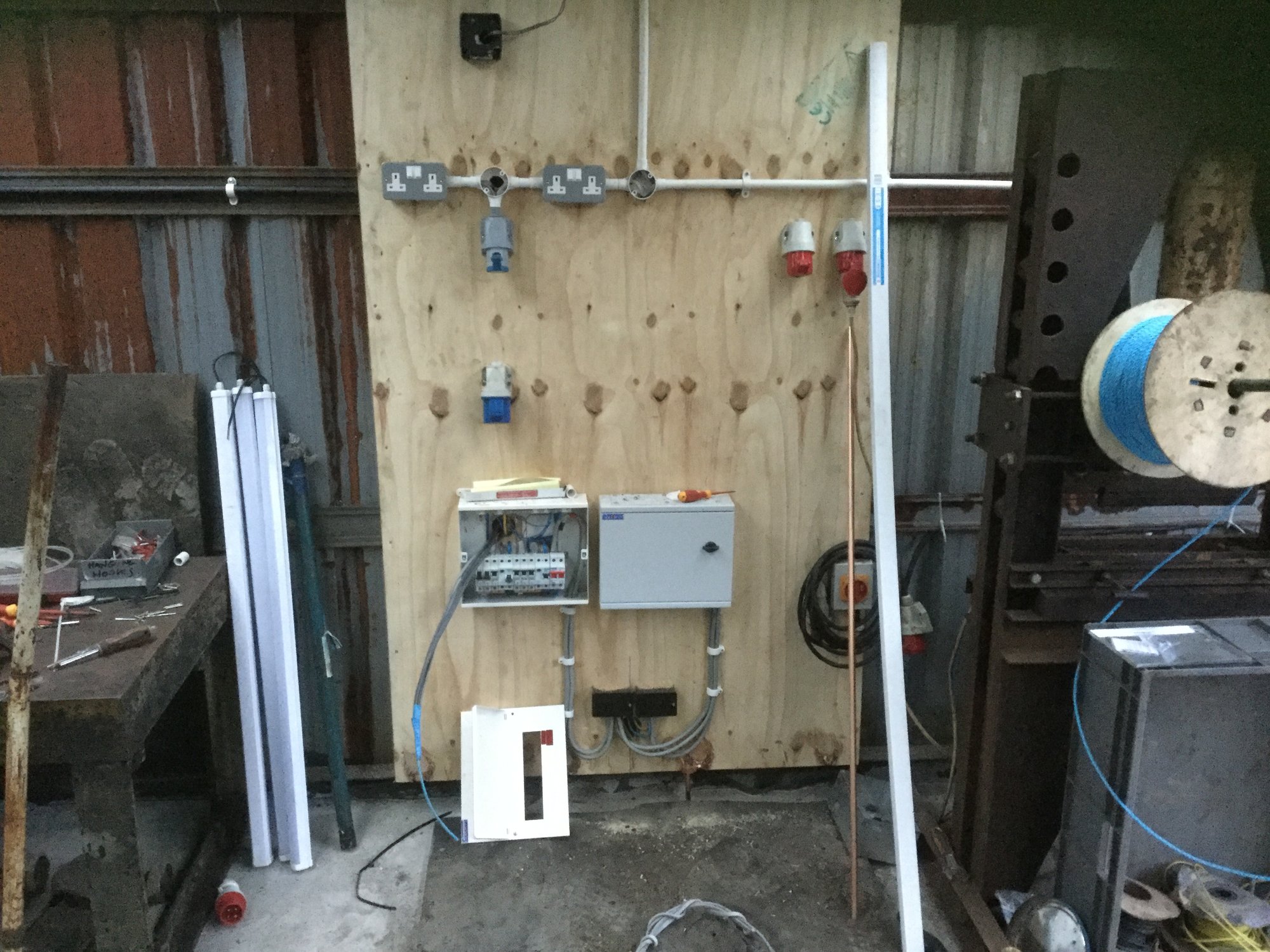

So, I have a board in my shed, supplied by a 16mm swa, so I want power to my new barn 50 meters away. I have no spare slots in the board. I know how to get power there, but what would be the correct way to do it, going back to the board in the house just isnt a sensible option.
Load will potentially be top end of a 2.5 cable so proposing a 4mm SWA burried.
whats your earthing arangments
