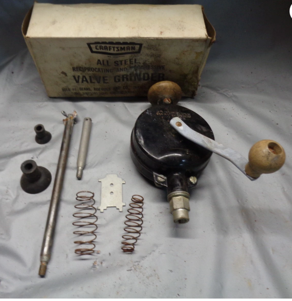

I would have liked one of those, but couldn't find one.Bought one of these from Sears in 99 - brilliantly simple bit of kit, used it a lot -
Stole the image from an ebay ad

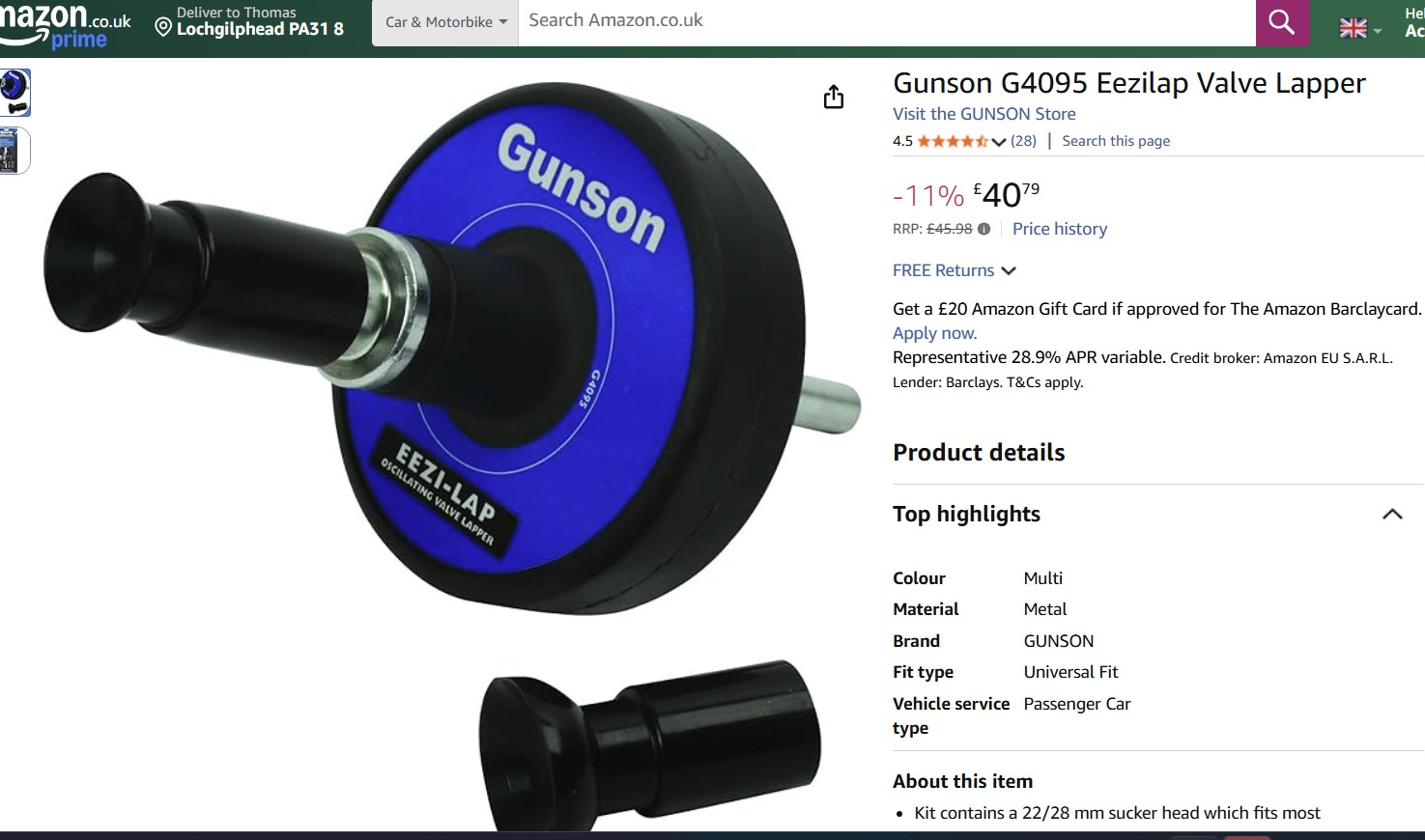

Bu66er, I did find a few with poor reviews so chose the Katsu as folks on here have bought that brand.The one you have linked to gets dire reviews, for better quality they are dearer, looks like the Gunson G4095 Eezilap is far better at a price.
