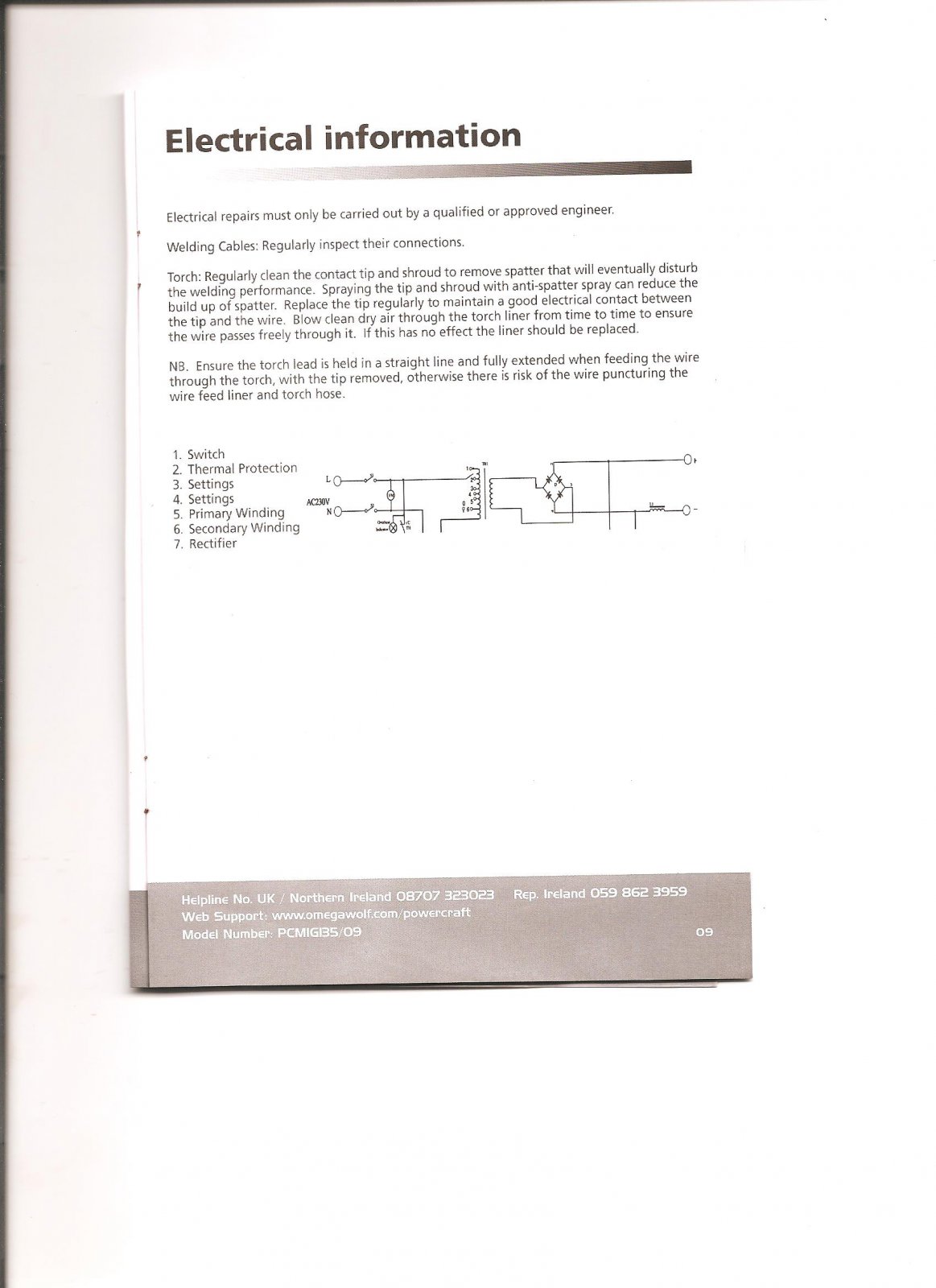

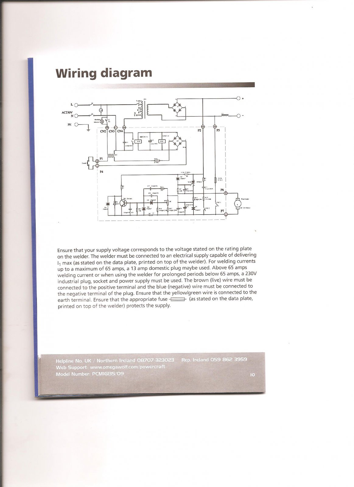

you would not happen to have a wiring diagram for this welder,my switch was stuck, I took it separate and the springs went everywhere,I got it all back together but I don't know if I have the cams in the right sequence,if you have a wiring diagram could you post it here or I will give you my email address.
Thanks
