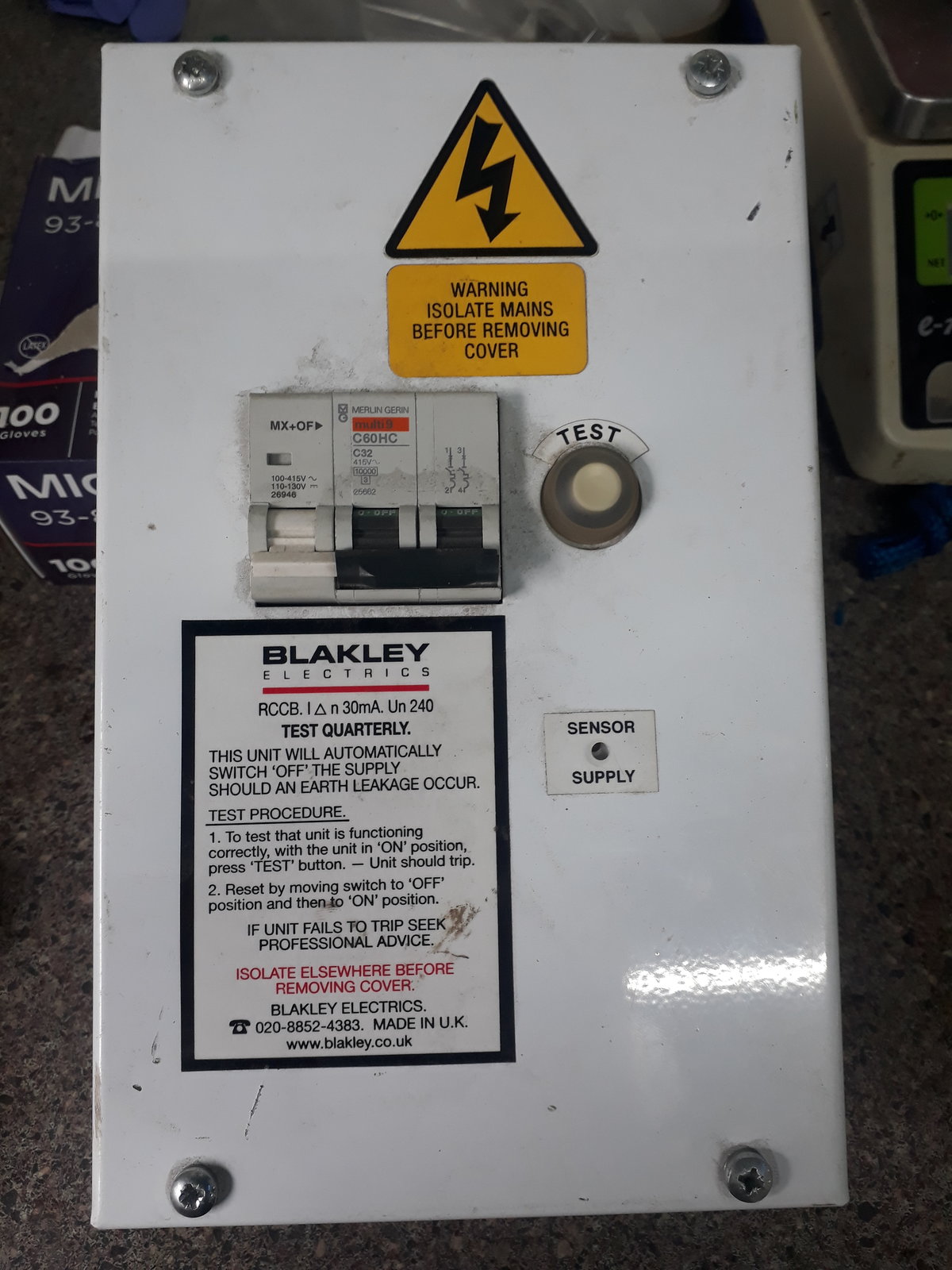

nowt wrong with that but hardly necessarydouble it up and you have 12mmnowt wrong with that but hardly necessary
4.0mm will cover you up to 32 amp . you can couple two together if you want it higherhe dont have the 6mm now but he said he will do me the 4mm even cheaper in 4 core
making it 8mm and use the armour for the earth
just use the 3d as the earth then and put an earth tab on the armoured glandthe seller just said the 4mm is only 3 core!
that's up to you and your power requirementsor am i being a tight ass not going for 6mm! he said I can have the 100m or 4mm 3 care for £100
it looks big what else is inside thathas a 32 amop mcb in it right now, didn't measure it, can tomorrow tho... think it's about standard size for those
that blue box behind it with 100 printed on it in white... it's a box of rubber gloves (to give a bit of scale)
ha ha always the way!no idea, I've never opened it, I bought it but then changed my plans
