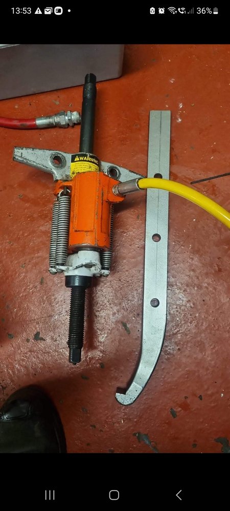

Was just gonna use 15mm mild steel and obviously woukd be 2 so a thickness of 30mm to pull through, I wouldn't know best grade of steel to use or where to go to start getting it from and ideally want to get some lazer cut to dave me some timeneed some good steel....not the norm mild stuff....
Wait which bit do you mean ? I wouldn't make the actual arm, im on about the links that go between the pulling arms and the puller itself. Or are you suggesting the links should be aswell.They should have forged hooks ,not just profile cut,made from
en24 grade steel.id forge them for you if you were nearer.
They should have forged hooks...
I’m suggesting the legs with the 3 holes in.
No sorry im not looking to make legs just the small links about 75mm with hole in either side thst link the leg to the body. However if someone did have a spare leg I've only got 2 not 3 which woukd be niceI’m suggesting the legs with the 3 holes in.
