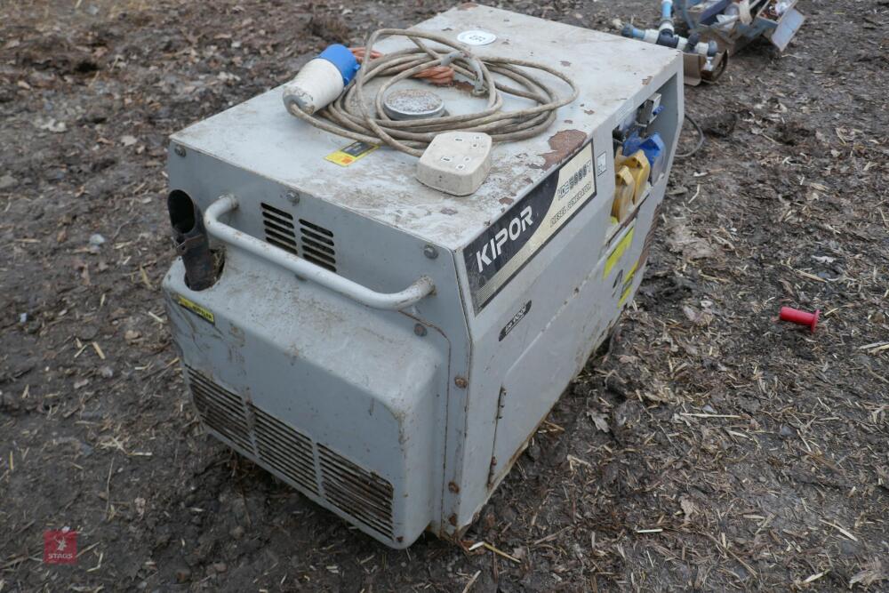

I'm not sure what taper the Chinese use on their generator builds.New plan forming ,

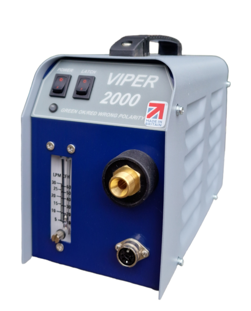

Stick a 170 DC Zanardi welding alternator in this Yanmar L100 Diesel I already have
And get TIG off it with one of these
New plan forming ,

Lister sr2 and sr3 here…. Good machines. Brush on the end of both iirc.I'm not sure what taper the Chinese use on their generator builds.
It could be a British (common), Japanese (Japan-built complete gens) or Italian Taper (Italian Market machines). Note a lot of Japanese engined gensets are British Taper - because the engines were bought in by the container load & assembled into gensets in Europe/UK (Pramac, Stephill, Harrington etc sets).
I'd not just assume that a Zanardi is a direct fit onto the Kipor engine Taper shaft. Also I suspect that the Zanardi welder alternator is quite a bit longer than the Kipor item & won't fit in the Kipor chassis.
4-pole 1500rpm industrial alternators are vastly superior in general over 2-pole stuff, which are portable sets designed for power tools and pretty insensitive, unfussy loads. A 4-pole with a 2/3 pitched winding, more mass a decent exciter and AVR will provide a better, more stable output than any 2-pole set.
The greater mass & flywheel momentum give better stability and better motor-starting capability (along with the better alternator). Hefty flywheels is how relatively small output Lister SR/ST & TS/TR gensets punch well above their weight.
If you've the room & can find a decent one for sensible money, an industrial genny is just so much better tbh.
