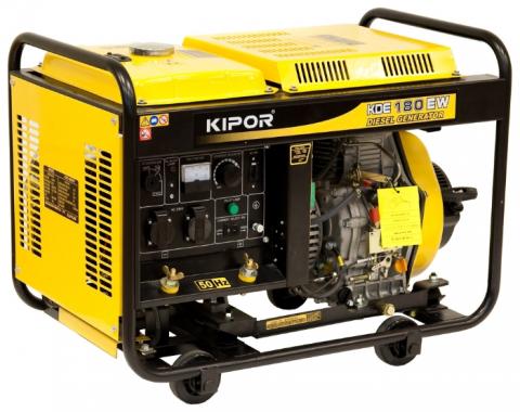

I'm not sure what taper the Chinese use on their generator builds.
It could be a British (common), Japanese (Japan-built complete gens) or Italian Taper (Italian Market machines). Note a lot of Japanese engined gensets are British Taper - because the engines were bought in by the container load & assembled into gensets in Europe/UK (Pramac, Stephill, Harrington etc sets).
I'd not just assume that a Zanardi is a direct fit onto the Kipor engine Taper shaft. Also I suspect that the Zanardi welder alternator is quite a bit longer than the Kipor item & won't fit in the Kipor chassis.
4-pole 1500rpm industrial alternators are vastly superior in general over 2-pole stuff, which are portable sets designed for power tools and pretty insensitive, unfussy loads. A 4-pole with a 2/3 pitched winding, more mass a decent exciter and AVR will provide a better, more stable output than any 2-pole set.
The greater mass & flywheel momentum give better stability and better motor-starting capability (along with the better alternator). Hefty flywheels is how relatively small output Lister SR/ST & TS/TR gensets punch well above their weight.
If you've the room & can find a decent one for sensible money, an industrial genny is just so much better tbh.

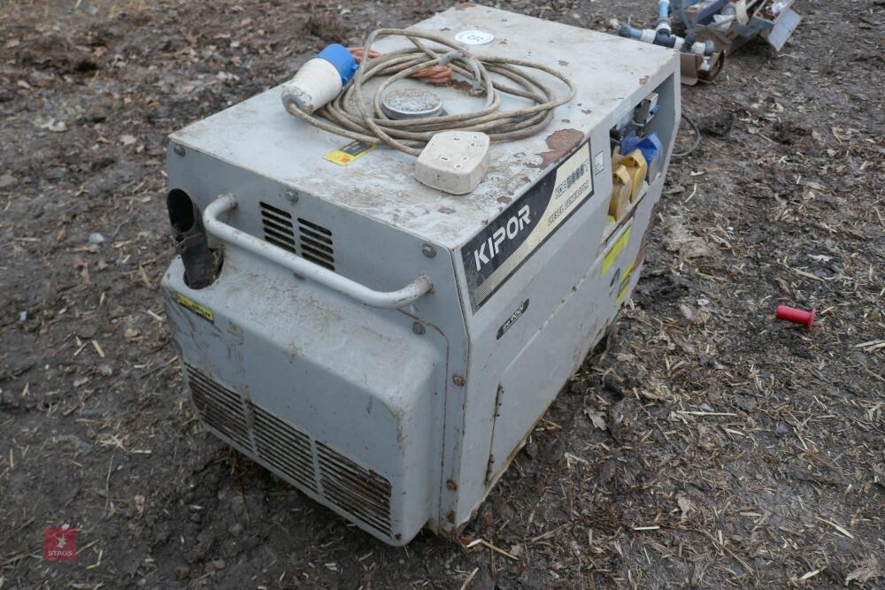

The Kipor needs taking apart anyway as the rotor is dead and the crankcase has an oil leak, I will see what taper it has then.
It's had its extenal exhaust removed and is piped out to a bigger external exhaust, a welding alternator could be shoehorned in.
This machine sits inside my workshop so I don't have space for anything much bigger, nor do i need anything more than to run a 3.2 , duty cycle isn't a concern as I'm not fabricating big stuff.
