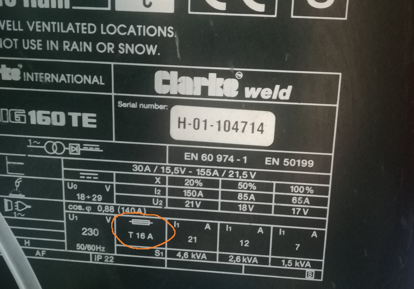

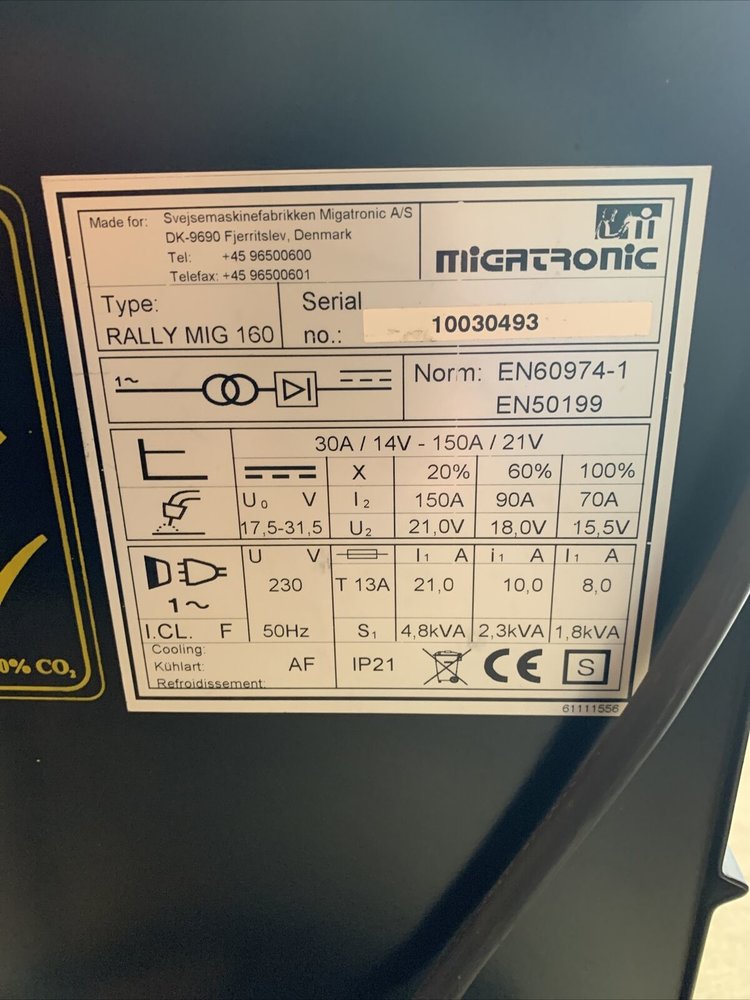

When you see [Must be hardwired} written in the machine specs does this mean that the power wire from the machine as to go directly into a wall mounted socket ie no plug, or does it mean it can have a 13amp plug but you must not use a extension lead.
Cheers
