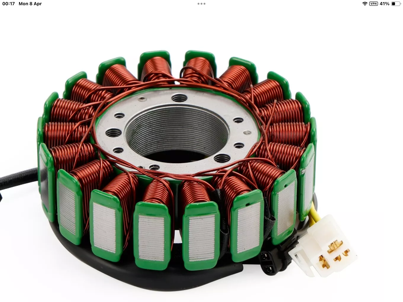

My son’s Triumph Daytona track bike has never charged the battery, so today I set to and removed the rectifier and measured the stator.
The rectifier measures shout on all but three points and the stator measures short on all points. I think the rectifier has taken out the stator due to being run with the shorted rectifier.
I can get a stator from eBay, Triuph can’t supply one anymore, but I am dubious about the lack of any type of potting around the windings.
Does anyone know of anything I could use to secure the windings more securely please.
