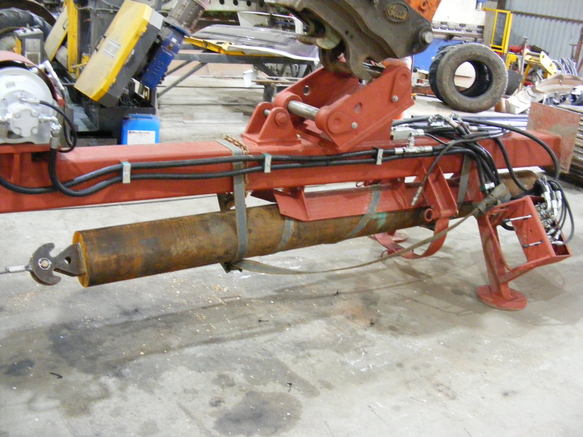

Local agri dealer sells them and the hammers wear out, they use cylinders with a thick base (30mm) plate and fill with concrete and cap with a thinner plate.
If I could make a suggestion, fit wear strips on moving parts as they are easier to replace than a full strip down.
was just to stand the thing up to see if it hung OK
