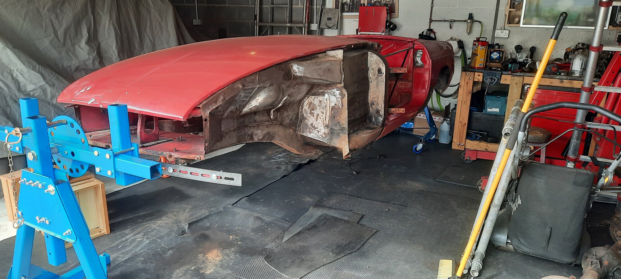

Now thats a plan thanks.Why not have everything ready to put on the epoxy, and do it as soon as it arrives?
id be verry carefull getting it blasted the metal gets hot and it lets the stress out of the metal and creases itShortly ill be having my mgb shell blasted. Its will then be coming back to me bare.
Is there anything that could be tipped/poured over the body that would keep flash rust away for a day or two? The I can put some epoxy down
Thanks
been there and done it got the teeshirt blasting stuff for people
just told them not my fault you were told end offtake it from me doors and wings can be ruined. i used to do them with kiln dried sand at reduced pressure and were wrecked even if you just blasted round the outer edgesIt would depend on the level of finish your blaster gives you.
If there are dark pits or patches you will get flash rust out of them. If the finish is universally sliver it should stay away for several days unless it gets wet.
Some blasters treat everything like 6mm plate, time is money. If your blaster does a fair number of car bodies wing doors and quarters should be OK unless someone rushes.
Bonnets will be wrecked
That's the sand it's cheap but not very cheerful. Aluminium oxide is dearer, yes, but it's heavier and sharper so does the job quicker with less heat and recycles many times.take it from me doors and wings can be ruined. i used to do them with kiln dried sand at reduced pressure and were wrecked even if you just blasted round the outer edges![]()
...The bell end had used steel medium and full pressure from the gun, lad was very sorry, boss was fuming and i got my £300 from them which was still not enough to cover purchase costs..lesson learnt that day.
