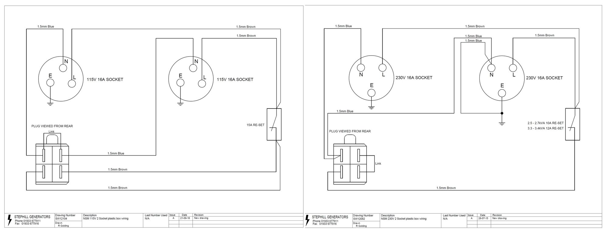

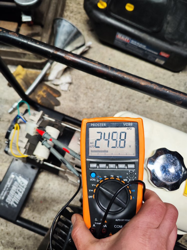

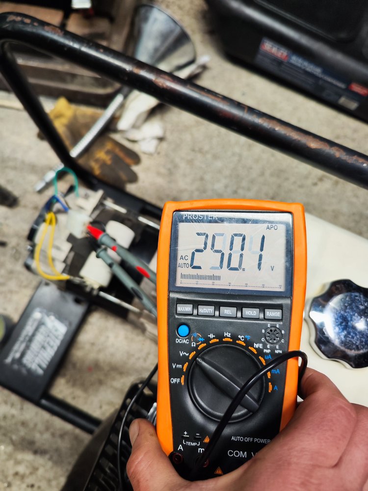

I have been given a small 110v only Honda petrol generator.
It is of no use to me while it has got a 110v output only hence the question if it can be converted.

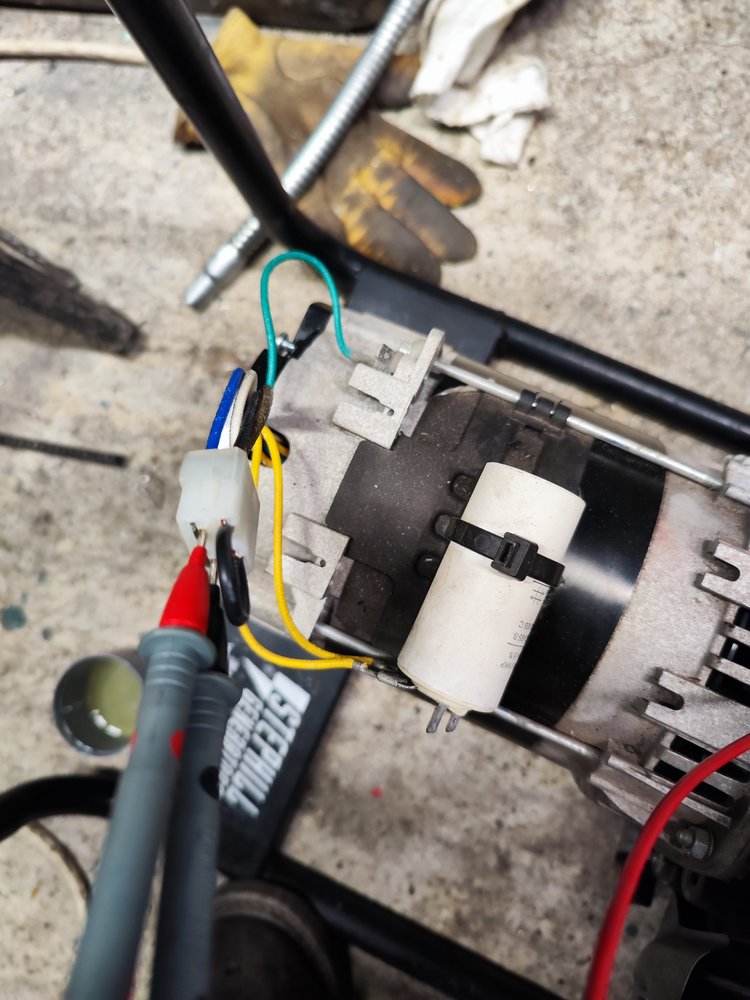

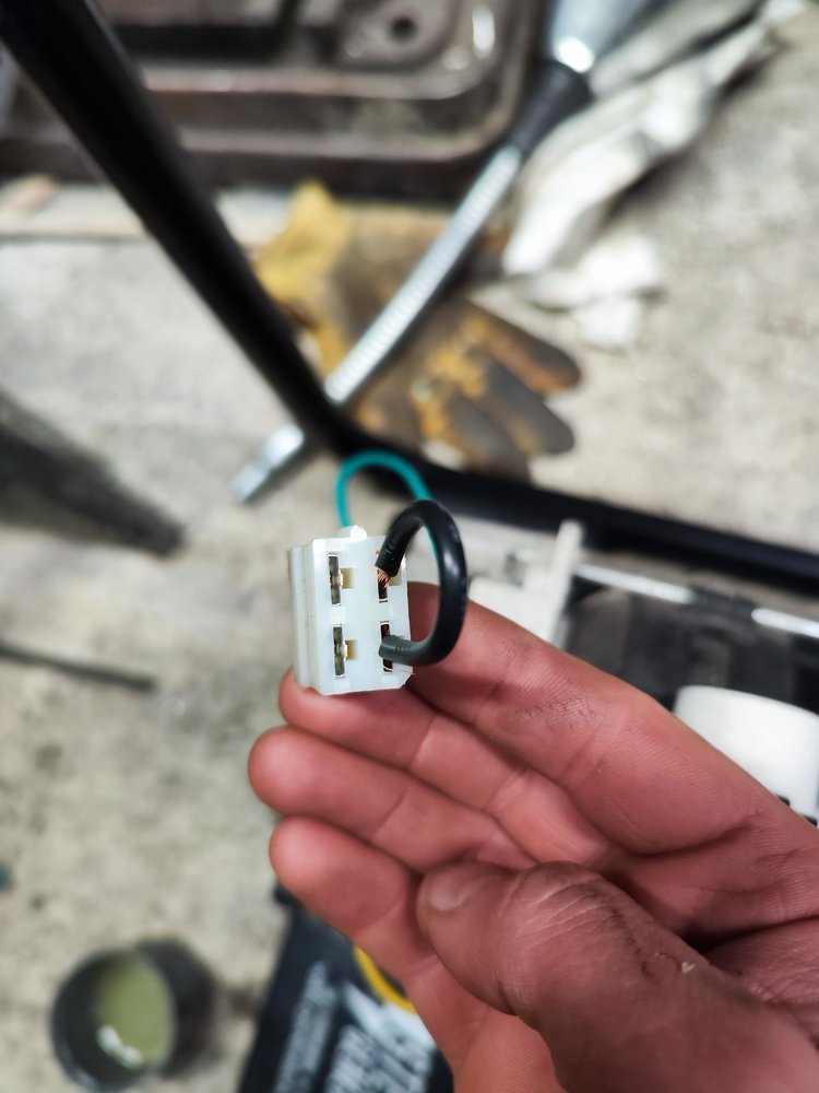

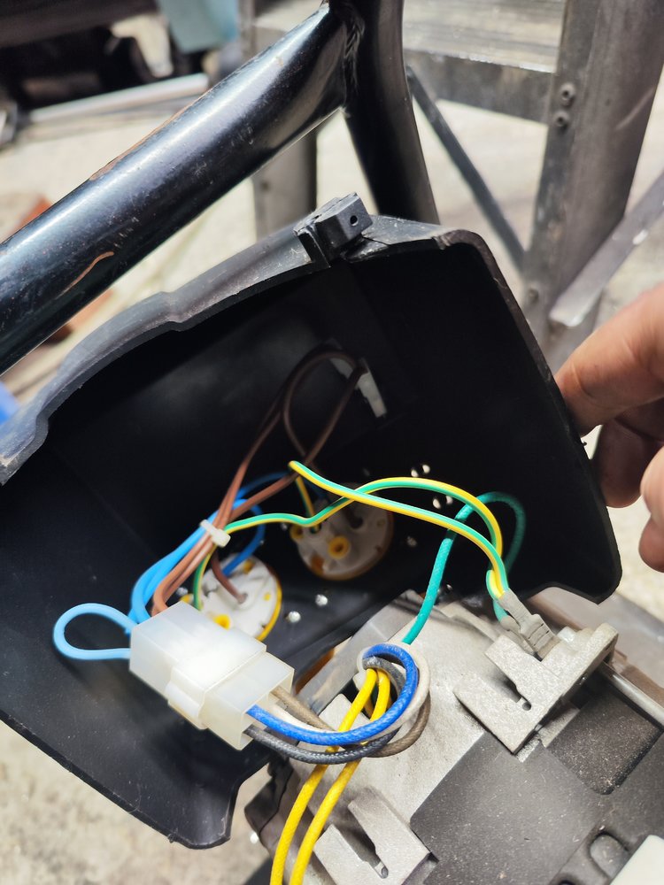

There are 4 wires coming from the 'alternator' (blue, black, white and brown).
My initial thoughts are that this is a 115v only alternator as it looks like blue and black are 'jumped' together to form the neutral side of the output and the red and brown are also connected together going through the overload switch as the live side of the output.
The two yellow wires coming out of the alternator are going to a capacitor.
Any thoughts?
