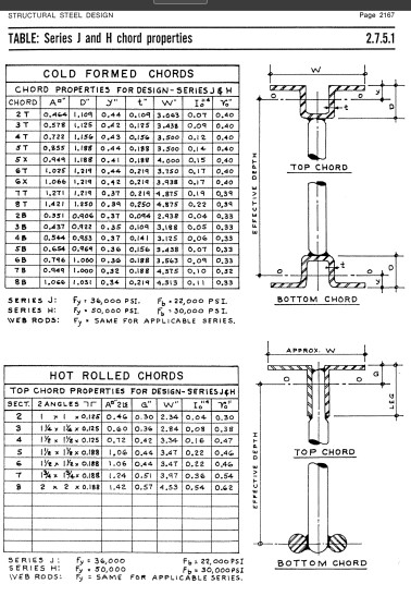

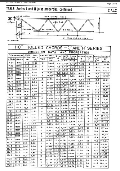

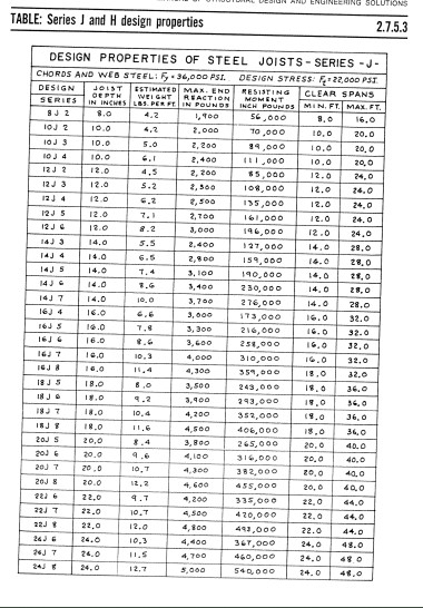

Thank you that'd be v usefulIt took a long time, but I finally found a sheet that details all the dimensions of standard bar joist's.
when I get back to my desk, I'll try to dig it up, and scan it.
Normal Hot rolled angles, hot rolled round rod.

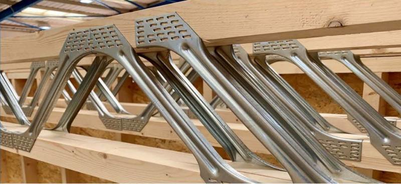

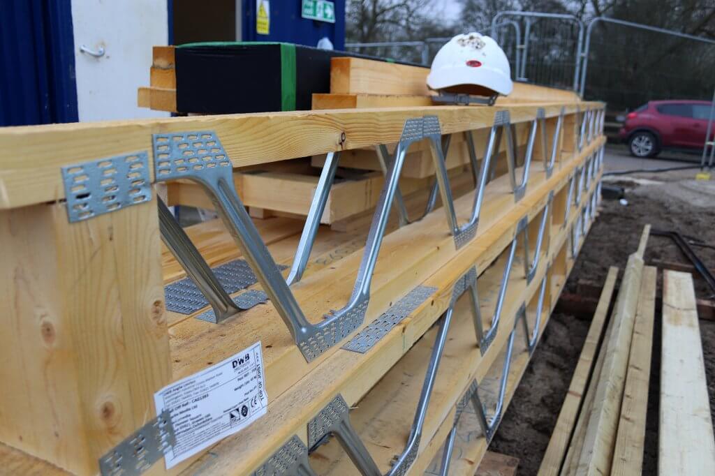

Anyone any ideas where to get the metalwork for these open web timber joists please?

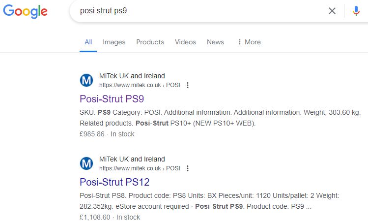

Thank you, excellent site.Posi-Strut PS9 – MiTek UK and Ireland
www.mitek.co.uk
Sign up and see if you can purchase them.Thank you, excellent site.
...and you probably have to jump thru a bunch of hoops (and pay allot of money)Yup, I think they come by the thousand
Here they are:Thank you that'd be v useful

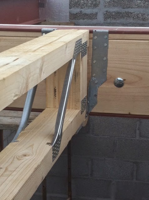

You don't even have to make zig-zag rods, I have seen people just make "Vees" put the bend at the bottom.Brilliant, that really is very useful
I did the long bar, made a bender, used 20' lengths.Making the zig zag might be more efficient if you are starting from a stock 10' length of round bar as you do not need to cut it up into small bits. However, to do that you do need a lot of space around your bending machine with a long length.

there not really that much just formed pieces of metal with strengthened parts done by a former with 1mm steelWhat exactly are you using the beams for?
I've worked in the roof truss & floor joist industry for years and wouldn't fancy making these up myself without the correct design software (there's more to these than meets the eye), a hydraulic press and suitable bench with jigs.
No software needed, nor hydraulic press's.What exactly are you using the beams for?
