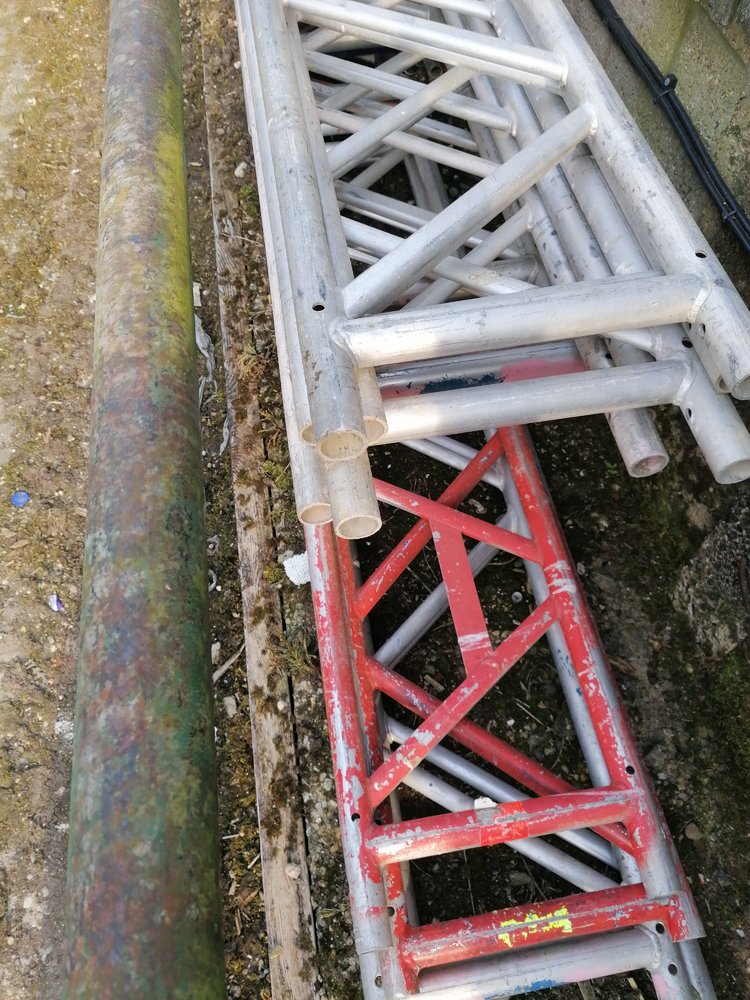

Expense, I've got the timber but at some point I will also be making something like thisAs this is a welding forum, why not leave the lumber out, and make bar joist's.

Ouch man.Expense, I've got the timber but at some point I will also be making something like thisView attachment 448905
Sorry, good point, nothing round I was just trying to demonstrate the open web type thing.Ouch man.
why go to all the trouble with round pipe ?
I think you're probably right but I'm asking because I don't know for sure.for start off i doubt hes going to get the truss metals as they are company made for there trusses
