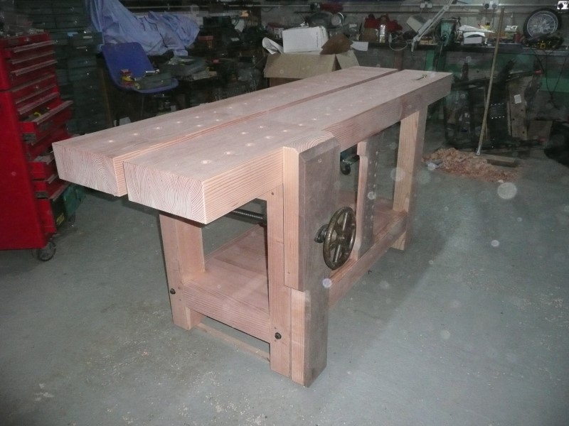

Bench is coming along nicely, I’d be afraid of using it in case it gets marked or dinked
I'm rapidly running out of corners

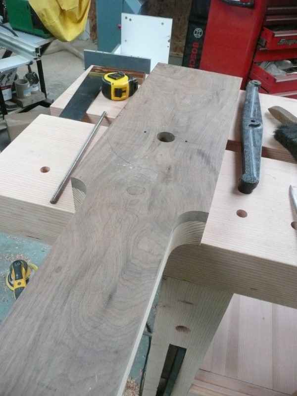

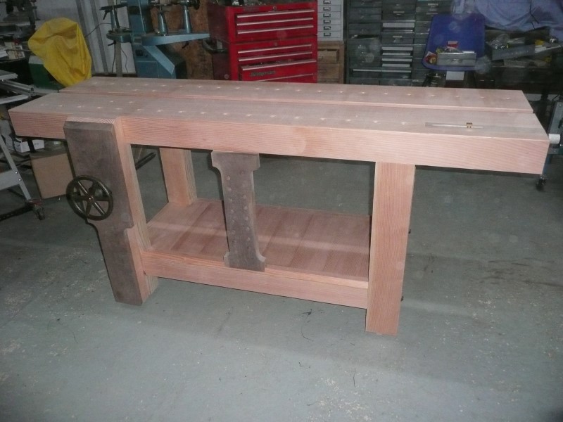

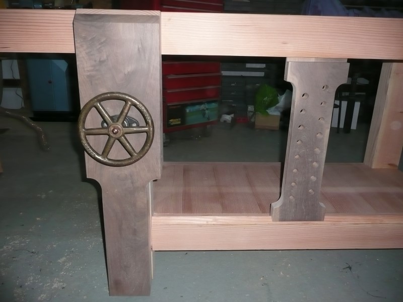

Looks like it's snowing, I must give the camera lens a brush.I got a good day in today, and did the fiddly bits that are hard to put right if you get them wrong. I cut the bottom of the sliding deadman first, this is V shape that slides along an inverted V shaped length of wood underneath the bench.
Then rough out the shape of the sliding deadman on the bandsaw

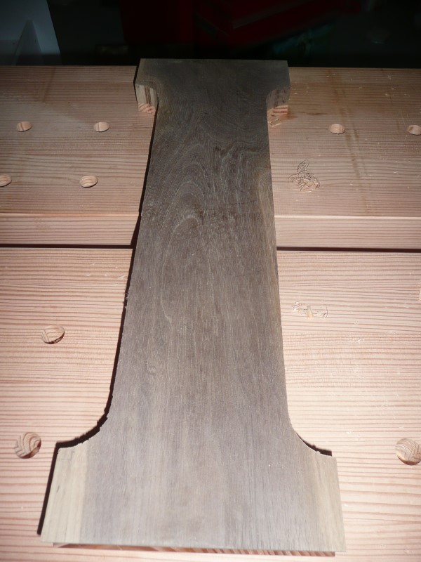

Same with the vice chop, I used a posh new hand stitched Liogier rasp to take away most of the material in the radius corners then finished off on my crap bobbin sander with the chinesium table that isn't anywhere near flat on the front side, so used the back. That will be going very soon, last piece of useless junk I buy, old gear or quality new from now on.
Looks ok, just need the vice height trimming and a bevel putting on it and a few holes in the sliding deadman.

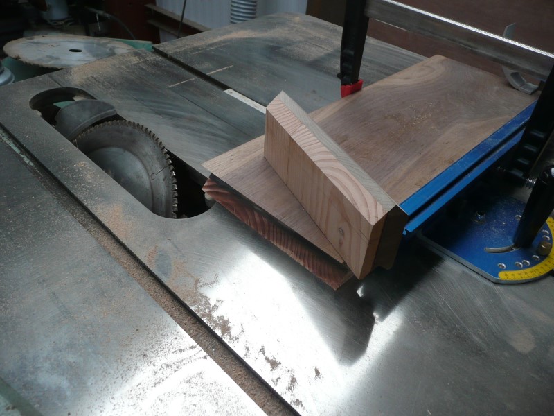

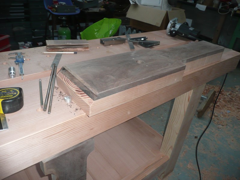

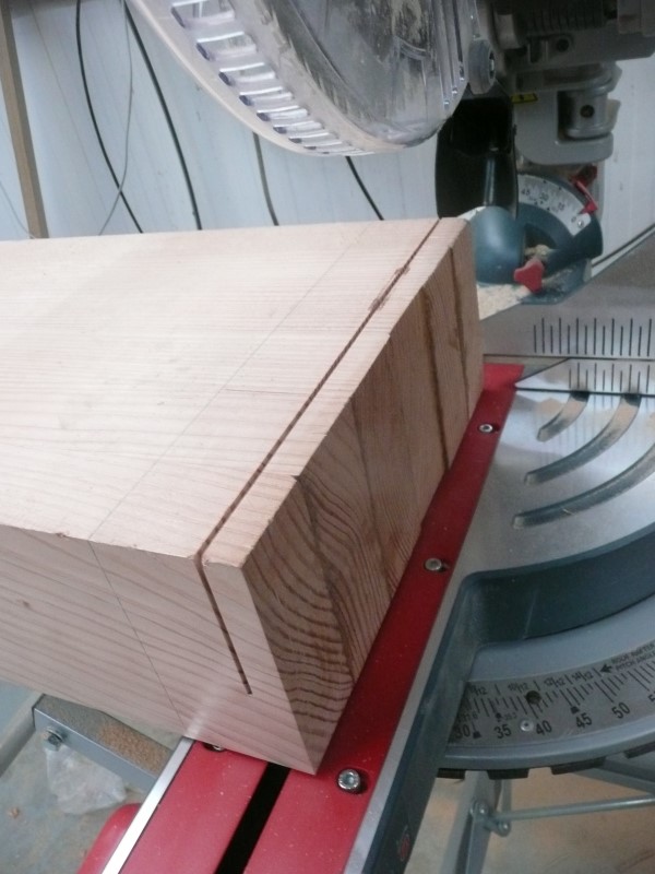

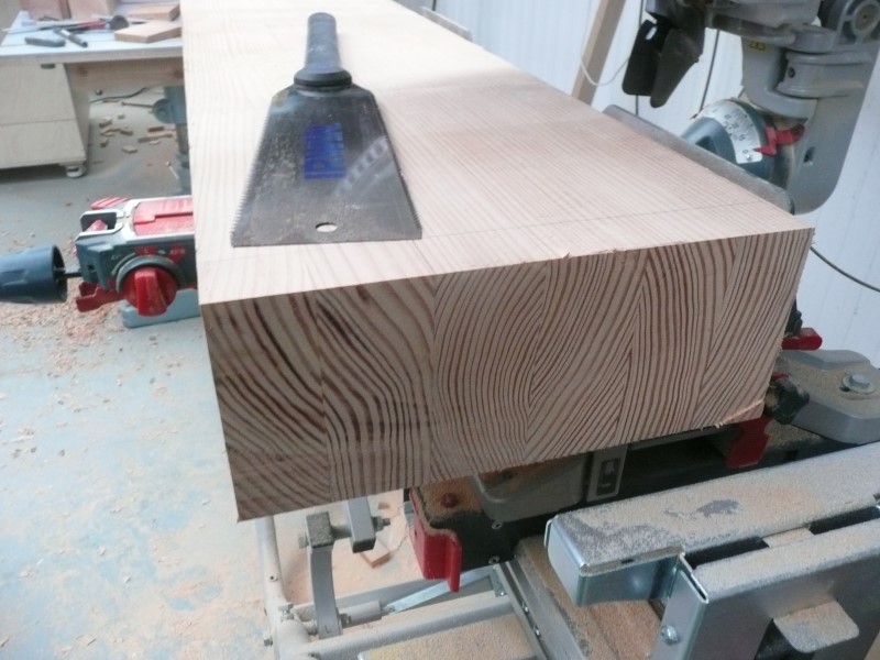

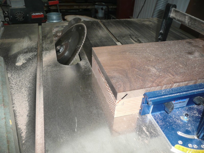

So cut the vice chop to height then cut the bevel, almost, saw blade not quite big enough. There are other ways of doing this, but I decided this was the safest due to the size and weight.
I cut the remaining wood with a Japanese pull saw put it on the bench in the tail vice and used a low angle block plane to cut it flush.

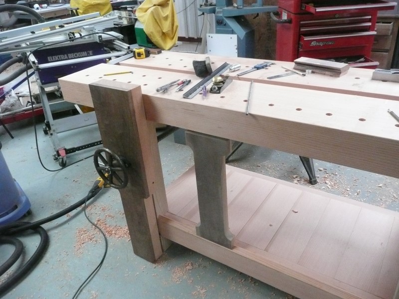

Then drill the deadman's holes.
And assemble it. I gave the vice chop and the leg it attaches to a good sand and installed the criss-cross pins all the way through, the holes will be covered with walnut dowel.
So all together, needs a good sanding then finishing with oil. I will probably use Osmo Polyx hardwax oil as I like the finish, and if you need to repair a bit its easy to sand down and blend in, not that I intend to overly mollycoddle the bench, but may not reassemble the dexta engine on itLooks like it's snowing, I must give the camera lens a brush.
I'm liking the bronze handwheel more and more, the vice moves nicely in and out, and if you spin the wheel it keeps going a bit longer, even though the vice screw is currently completely dry.

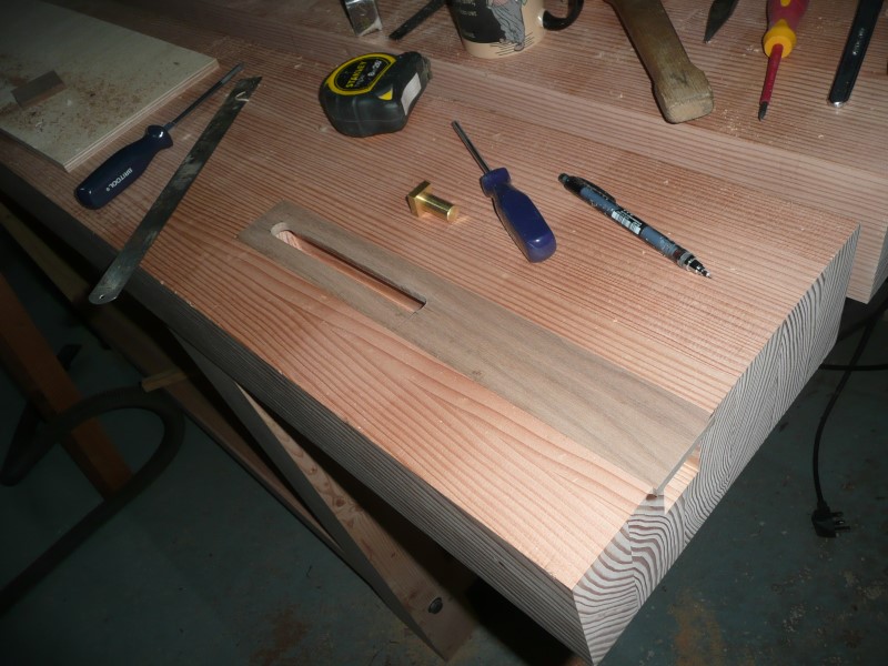

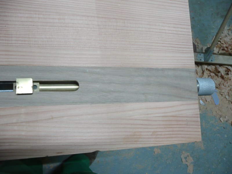

It will look different again once the bench is oiled. I still have a bit of woodwork to do, there is a tool tray that fits in the gap in the bench top. If you move this to one side it sticks up about 10mm to act as a planing stop. That may take a bit longer as I promised to start on the kitchen tomorrow.
