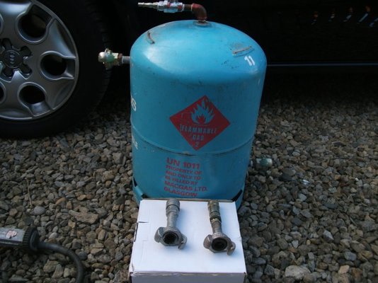

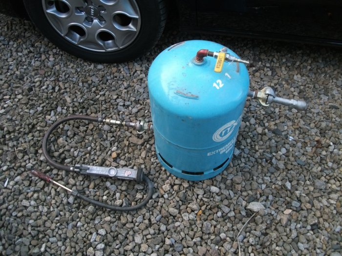

having a portable air tank is quite handy rather than running airlines a fair distance i already had one made up with c couplings which i use at the end of my airline and feed the shotblasting pot with. it cools the air and collects any water before going through the seperator to the pot. i just made 2 c coupling to plc and eurofitting conectors they clip on the tank and i fill it via the drain off tap fitted to the top to 125psi its good for inflating tires and using a windy gun for getting wheels off ect
