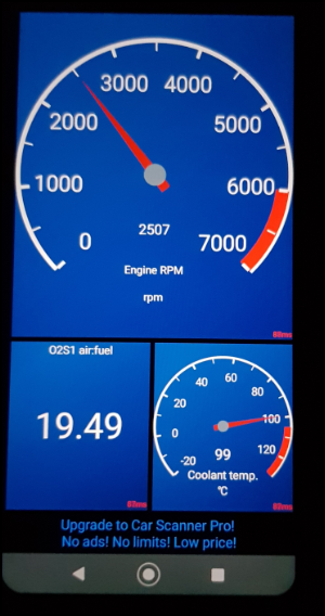

Car is a 2008 Peugeot 207 1.4 petrol with 75k miles on it. Starts OK, but has rough idle, turns very rough with a tiny bit of throttle (off-load) then clears as you rev it a bit. Gets worse as engine warms to the point that it will sometimes stall.

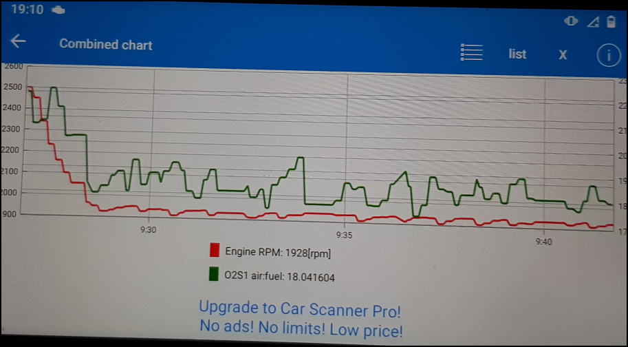

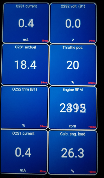

I plugged in my basic ODB scan tool using 'car scanner' and it gave just one fault - P1340 which the scanner identified as cam position sensor B circuit malfunction. However, doing some internet research it seems that Peugeot use that code for "misfire cylinder no4"

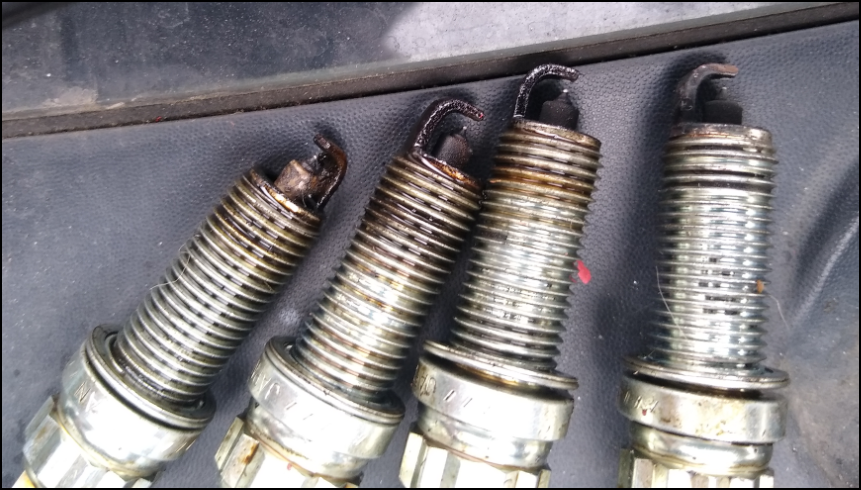

I pulled the plugs and sure enough no4 is white where the others are black (car has had several cold starts prior to me pulling them so no surprise at the black ones). Indicating something at least is different with cyinder 4.
Plug 4 is on the left.

Fitted all new plugs

I've run out of things to try now, I don't have access to a quality diagnotics tool so I'm a bit stuck until I find one. Looking for ideas based on experience if anybody has any.
