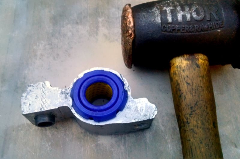

I've made a few sets of bushes and mountings that I couldn't get or were only available in lurid colours
It's pretty easy to do, I made a former by turning a bit of hard wood on the lathe, then wax the former and use that to make a mold out of silicone rubber.
Split the mold, remove the former, mix the polyurethane and pour.
The polyurethane is sort of translucent but if you want a colour they can supply pigments.
I didn't de-gas by pulling a vacuum, but it worked fine
See link for the company that supplied the materials
70 to 85 shore is the type you want, some people go for 90 but that's getting as hard as some plastic.
