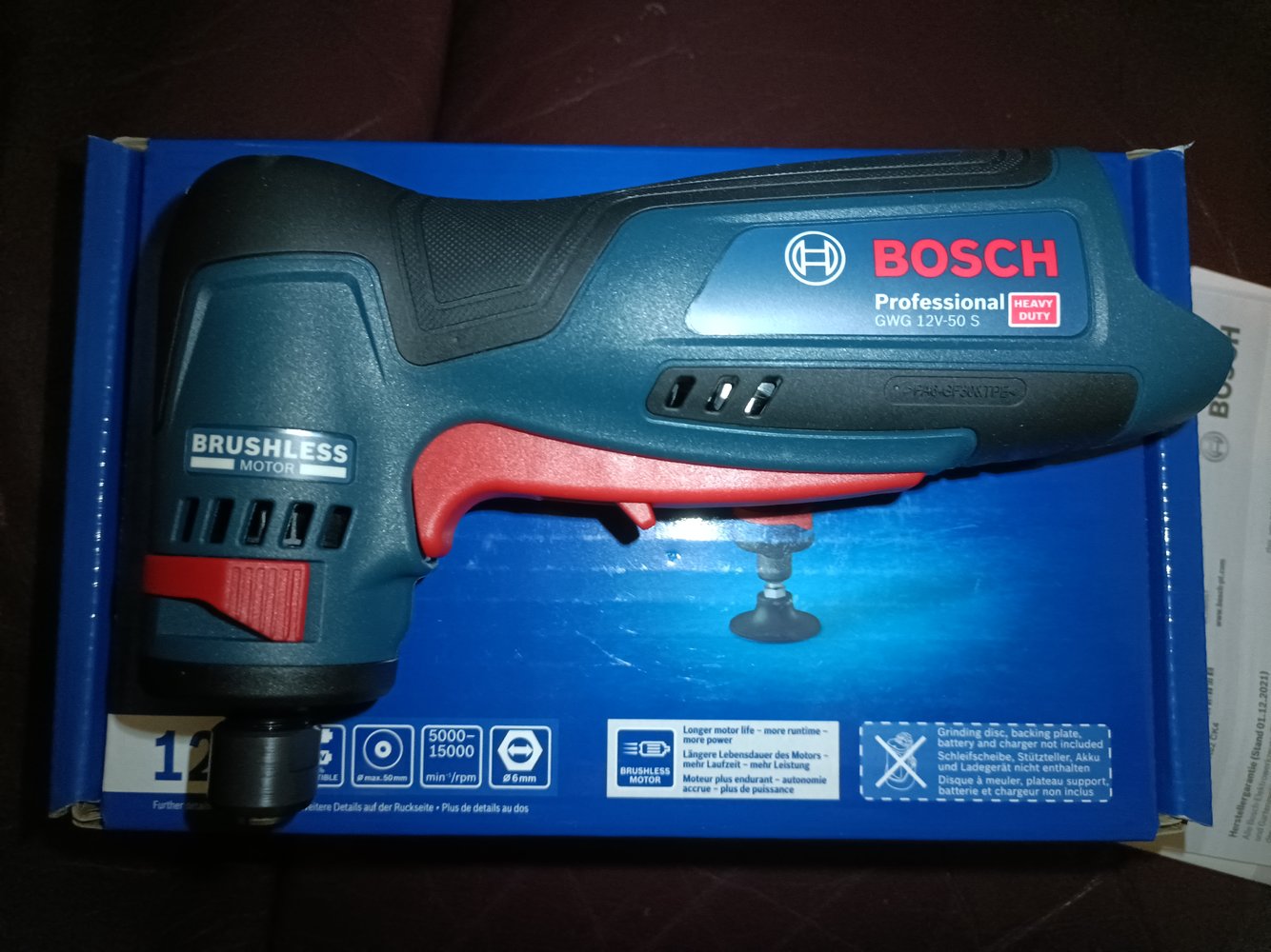

Der, there's posh. Brushless too

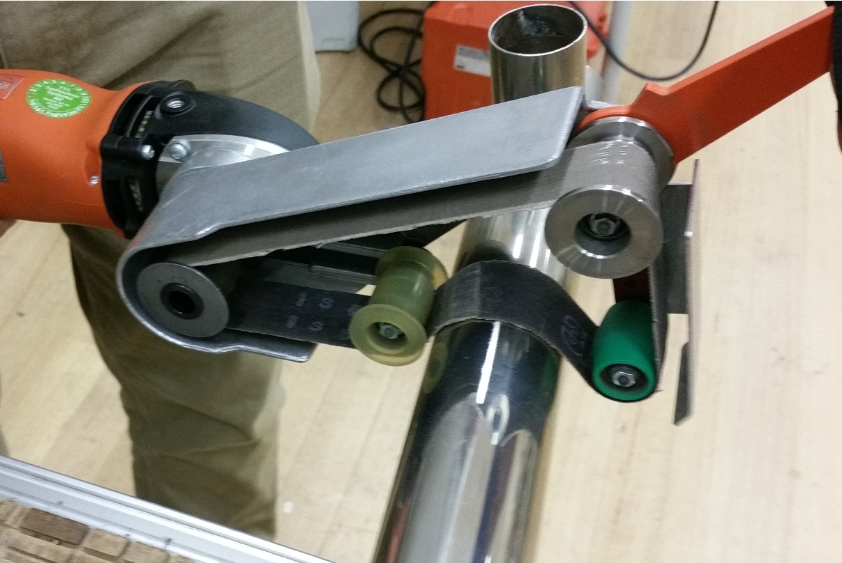

What's a tube polisher? Is it a powerfile - like this?
If so, I didn't know you could get Sotchbrite belts for it,
Much the same except one (or more) of the belt rollers is sprung loaded so the belt can be made slacker to wrap around tubes.
They will cover 90deg with ease, 180deg at the most.

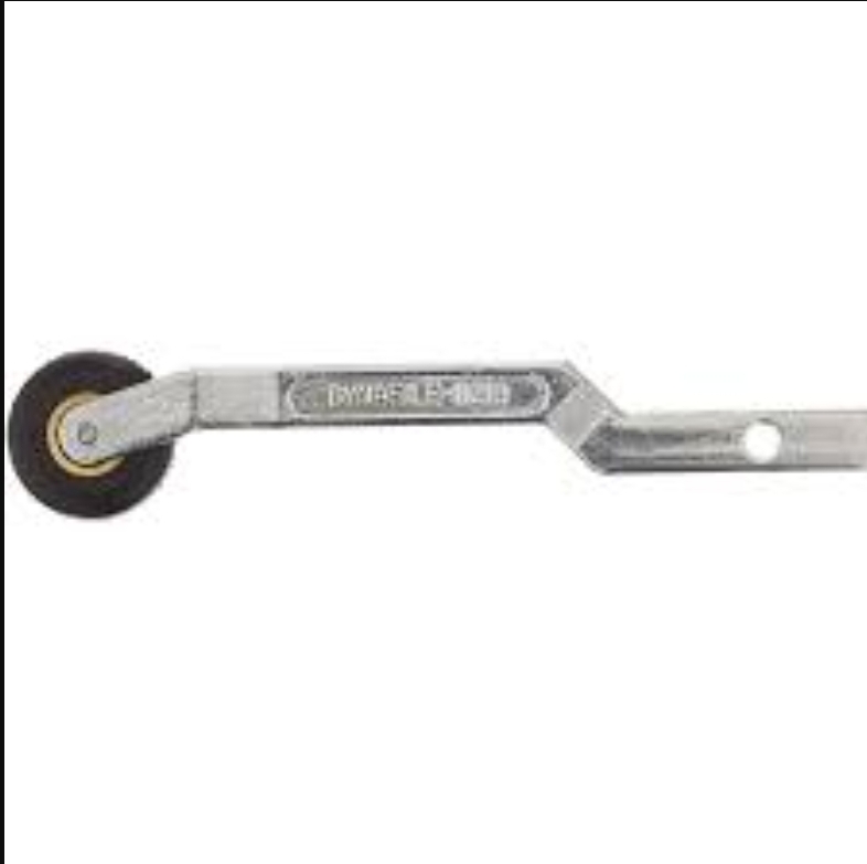

Or you can get/make a arm for a power file that has an offset wheel. That will give you about 45deg.
Scotchbrite belts are readily available for both, often sold as "surface conditioning" etc

Many thanks. I'd be starting fresh with the batteries, so my choice now could set me a down a long and expensive path@rmwesley The M12 stuff is very good can't comment on the bosch , ask MattF , a lot of peoples choices are made by what battery platform they already have , If you don't already have any the the worlds your oyster
I just want to take the right road.Does it come down to whether I like blue tools or red tools.
