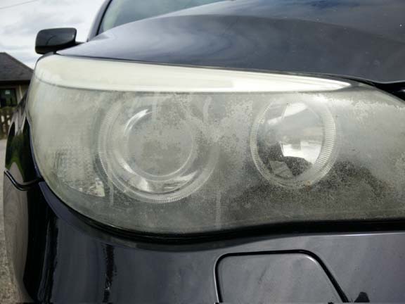

Looks like heavy orange peel, if this is the case start with 800 then finer until you have a good flat finish, then compound. If you start on a 'rough' surface you will be sanding forever with fine grade paper. Plenty of clean soap & water.

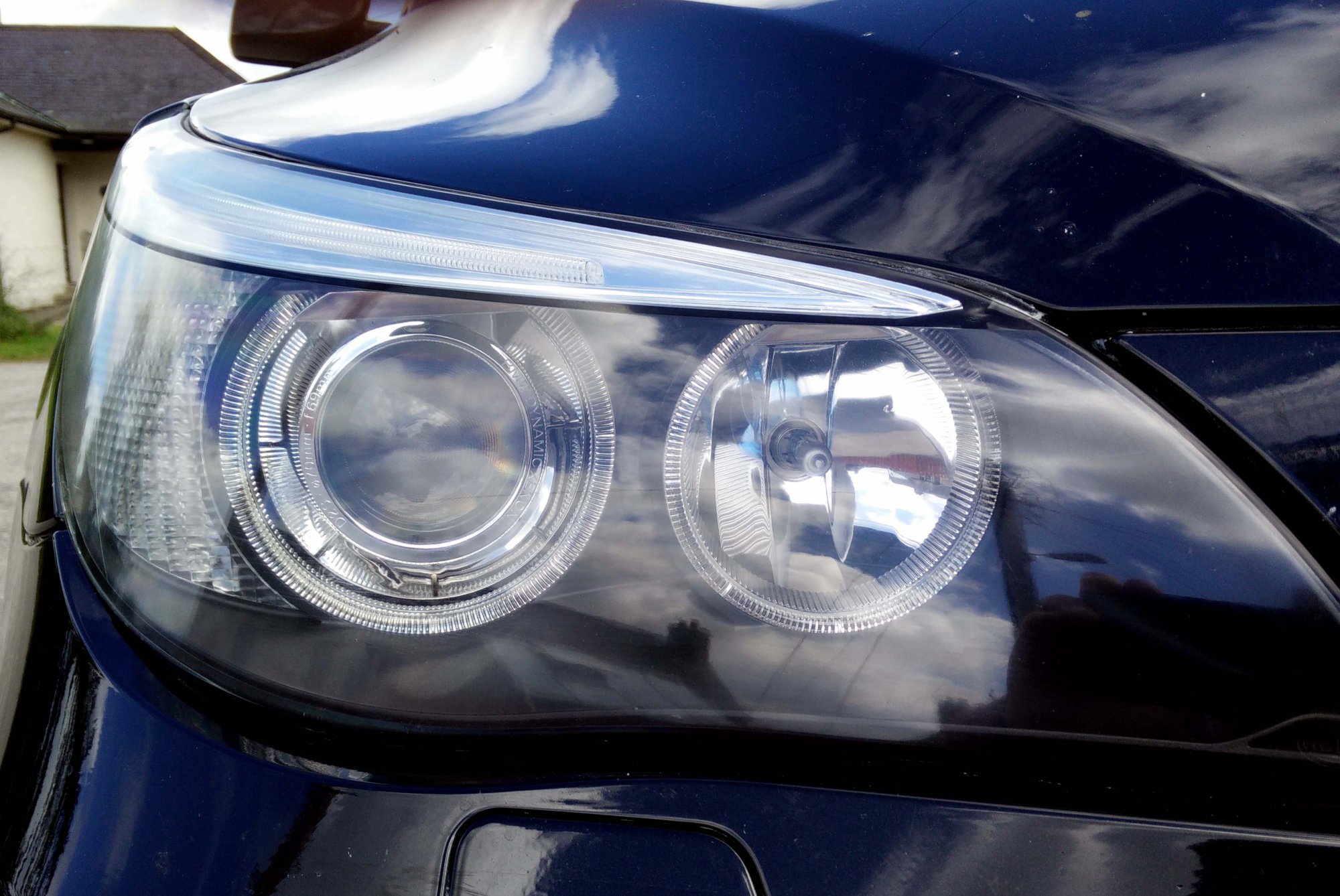

With a celly or 2K solid colour could you just go over it with some 2K clear to give it a shine? or does it have to be flatted and polished?
I wouldn't want to machine Polish celly until a few weeks had gone by
