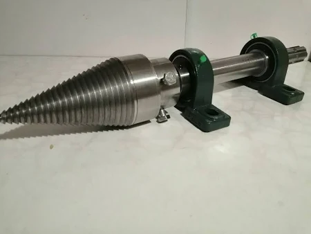

There doesn't seem to be much force along the length. Most of them use 2 pillow blocks but the heftier ones seem to use a solid tube with a bearing each end.Which way are the loads going, that will determine what type of bearings, and holding arrangement you use. Pillow blocks typically are good at up-down loads but they aren’t designed to take heavy pushing/pulling loads in the axial direction of the shaft. They might be good enough for your application but you might find a better alternative if that’s where the majority of the loading is.
I’ve had one of those (top photo) splitters for years. Much better than up/down hydraulic type due to simplicity, and not having to wait for the return stroke. Tractor can run at nicely low rpm, too.Is the shaft a sliding fit in these?
And what stops the shaft sliding about? Locking collers/spacing collars or something else?

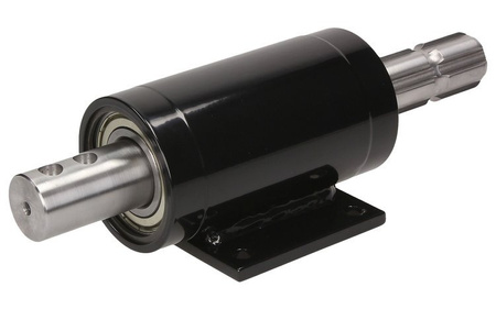

Is it possible to buy the solid tube type like this? If so what do I search for?
Building myself a screw type log splitter.
Sadly not got a tractor. I do have a spare 7.5hp 3 phase lathe motor which should do nicely on a 100mm diameter cone.I’ve had one of those (top photo) splitters for years. Much better than up/down hydraulic type due to simplicity, and not having to wait for the return stroke. Tractor can run at nicely low rpm, too.
Grub screws retain the shaft in the pillow blocks. Make sure the cone is held positively as well, or it’ll come off.

Funnily enough I did think of just having the auger coming out of the back of the HolbrookPretty easy to turn a bit of tube to accept some bearings in either end then weld it to a bracket for mounting , like said before i dont think in this application there is much axial load once the screw digs in. Im pretty sure you have a lathe or two or three you could it on
